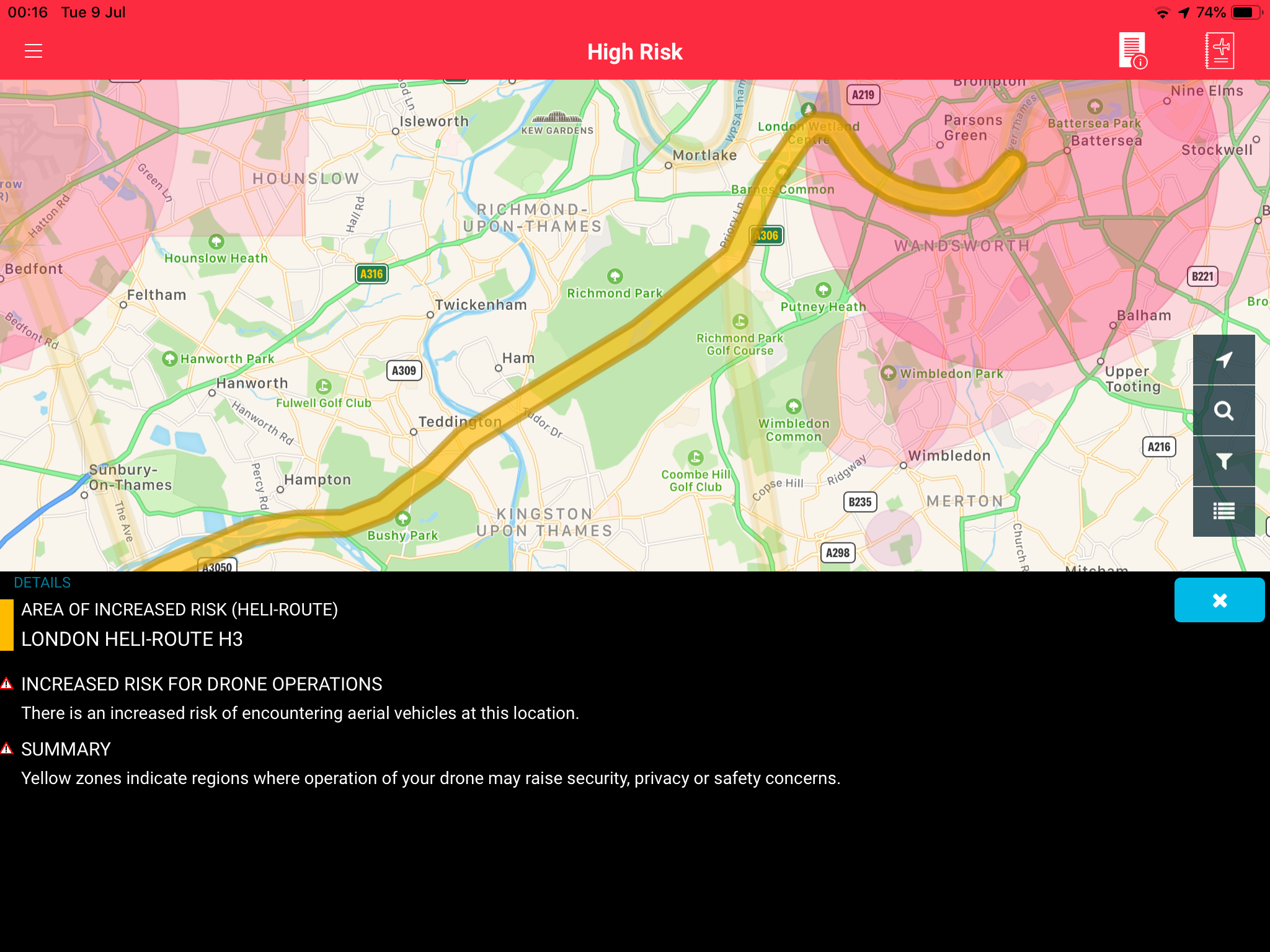

When I checked out Richmond park (photo below) it is definitely not in an FRZ, but there is a warning area as there is a helicopter route. This is an advisory, see second photo with info.

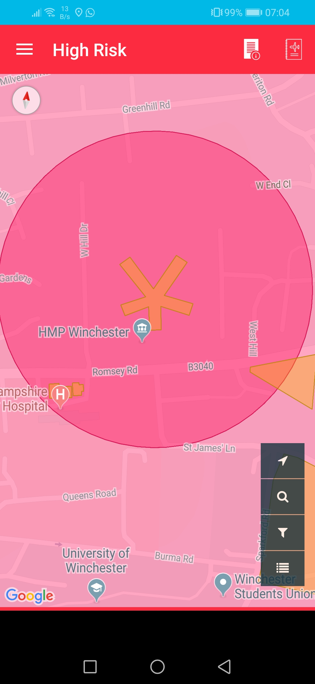

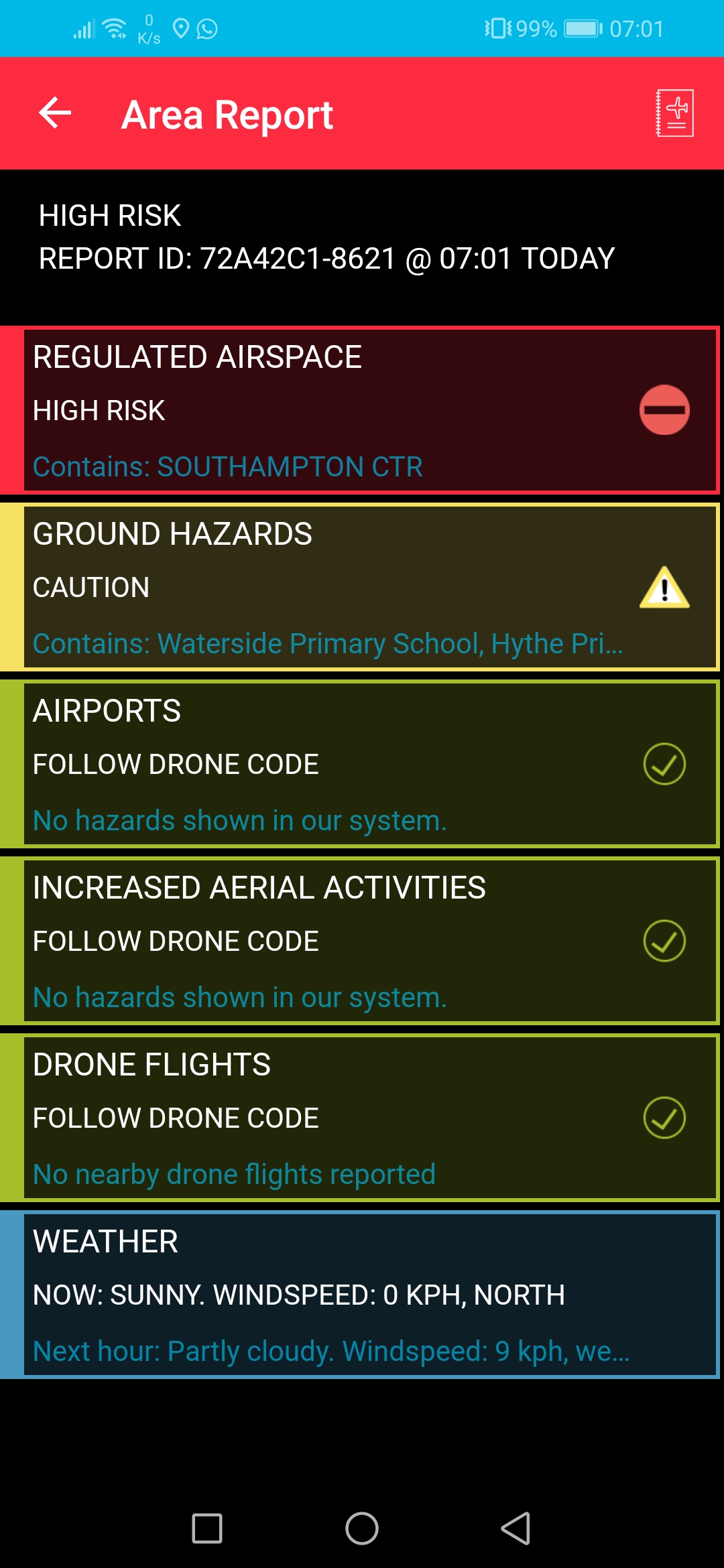

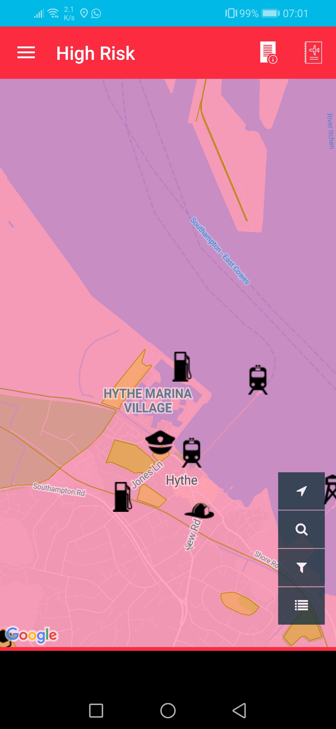

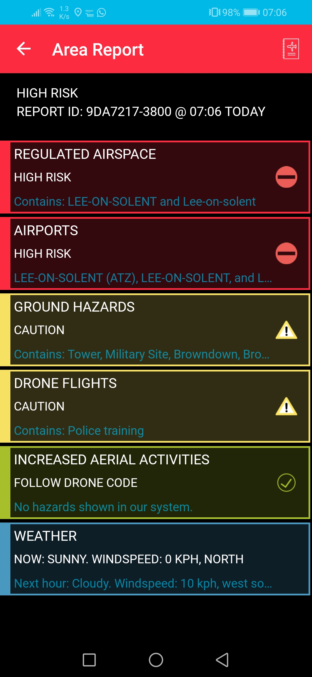

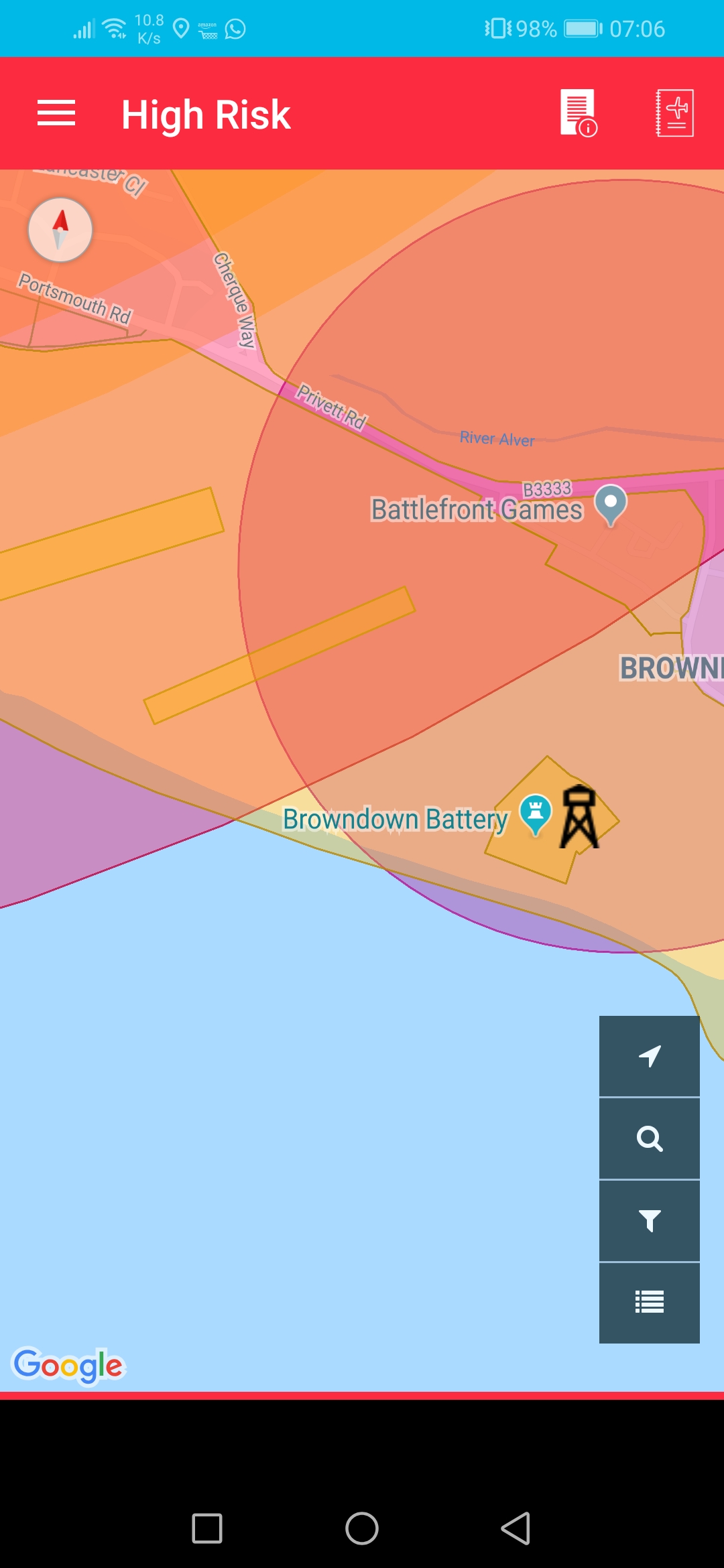

I am probably the most stupid person on this site but…I am confused by the NATS DroneAssist app. I have mine (on Android) set to the defaults. Can I show the club experts three screens and ask if I can fly in them? And how I know that’s permitted??
The first one has a prison in it, so probably not. Again, if you had a specific reason to fly there a quick call to the prison could sort you out.
The other is trickier. You’re in an ATZ so you could give them a call, say hi and let them know what you’re doing out of courtesy. If you’re local it’s a good way to build a relationship. Your bigger worry is staying away from the military facility on top of the hill. Class D is generally open to us, you just need to give a heads up in some areas.
I should stress though, you don’t have to do this at all as long as your drone is under 7kg. The reason I suggest it is that it demonstrates being a responsible user. Should a member of the public call up and complain under the belief you shouldn’t be there and the response from the authorities is words to the effect of, “Bruce? Yes we know he’s there he’s known to us” it stops any fuss dead.
