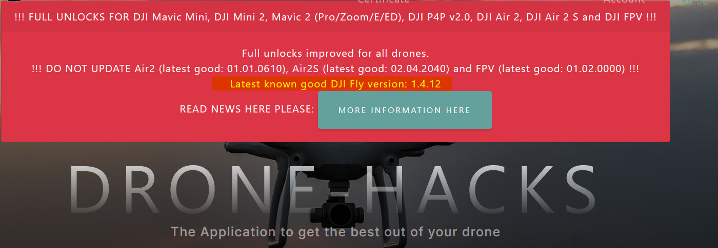

Has anybody tried this who has the drone hacks script installed?
See post # 89 over here @speatuk Drone Hacks app - How to enable FCC mode and remove NFZs on your DJI Mavic Air, Air 2, Mavic Mini, Mini 2, Mini 3 or DJI FPV drone - #89 by d95gas
