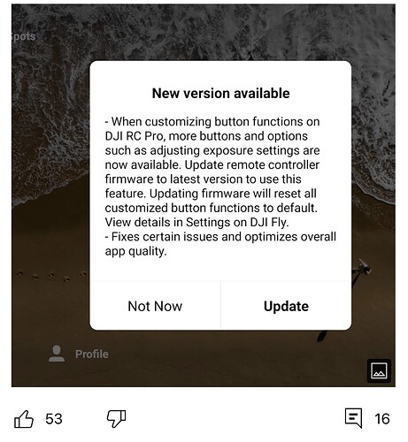

Hi all does anyone know if it’s ok to update from 1.5.10 to the new version iOS ? Or shall I just forget it - on my last app update the one above the menu is very jittery when open but only when connected to the drone ( it’s annoying ) but does not affect flight - also pics and videos don’t go straight to my phone ( I phone 12 ) :thinking: any thoughts or recommends welcome !
Thanks in advance

Anyone know about this update ? Is it safe to update or shall it’s best to leave it !
Thanks in advance
