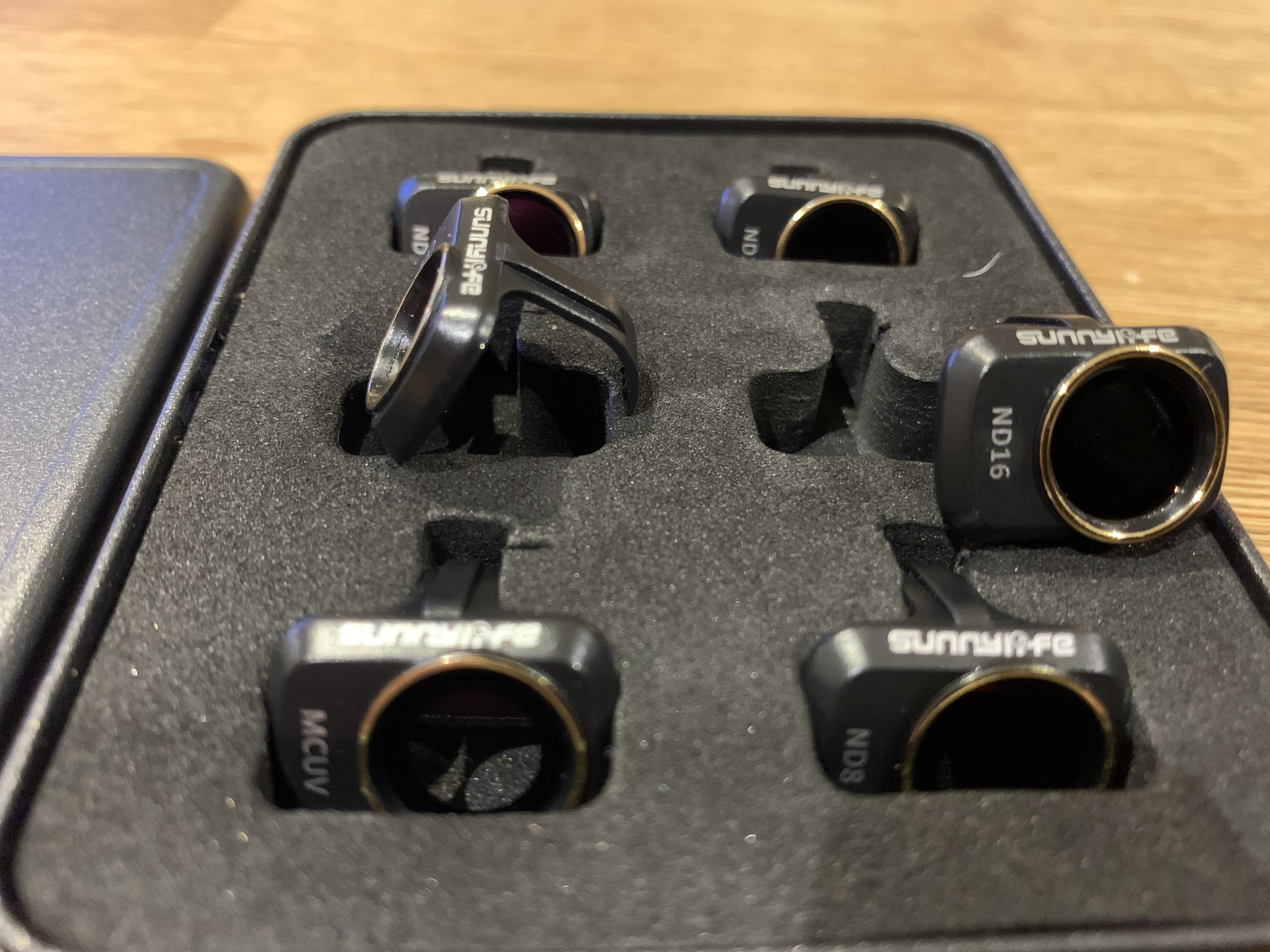

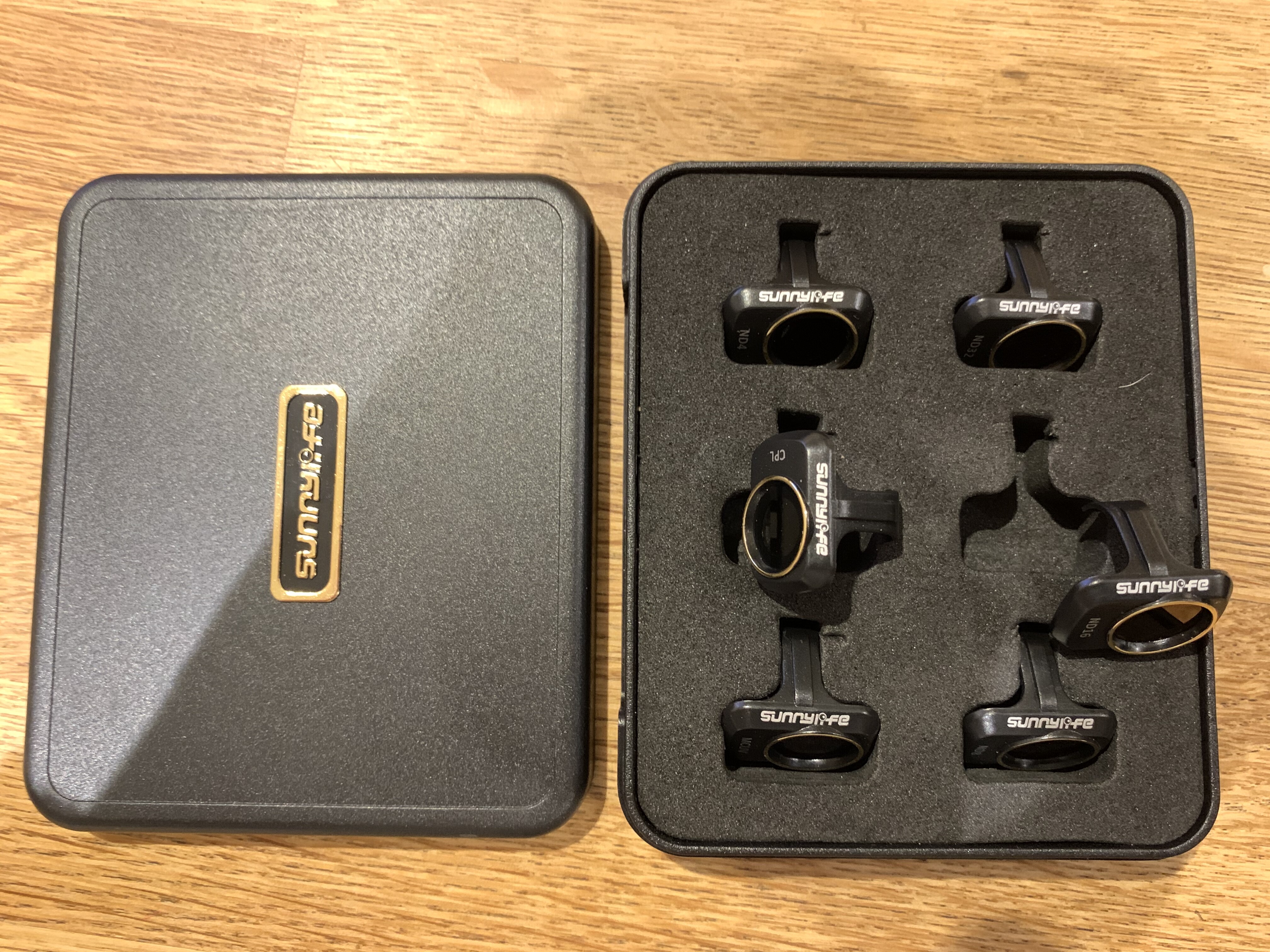

Just ordered these from Banggood for £22.90, has anyone else used them? they seemed to have good reviews
NDs…at the very least they will protect the lens as not doubt dust can sometimes be flicked up by props. It was really protecting the lens the only real reason I used one on my still cameras waaaaayyyy back :grinning:

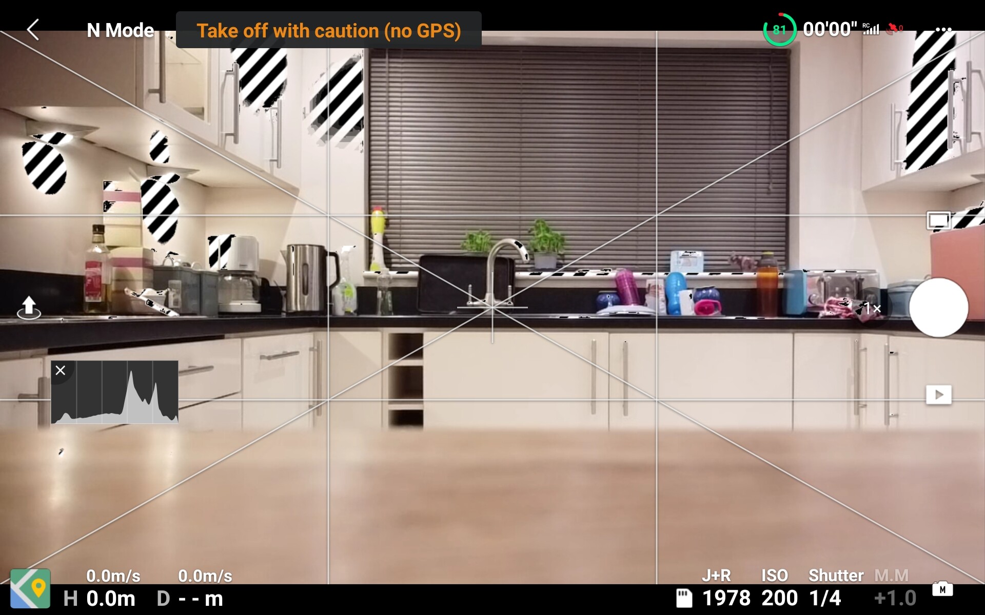

Ordered these 8 days ago and they arrived today :slightly_smiling_face: :+1:

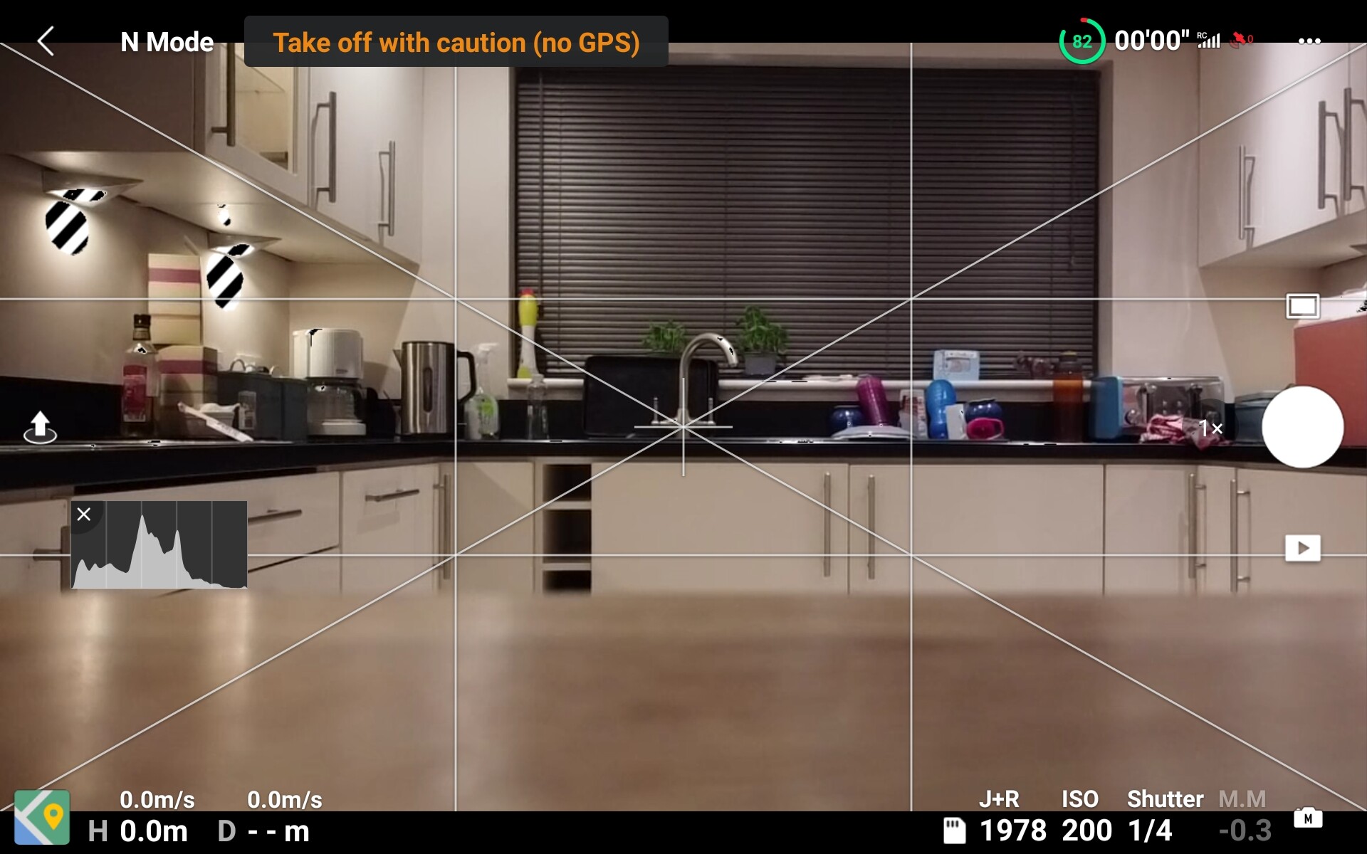

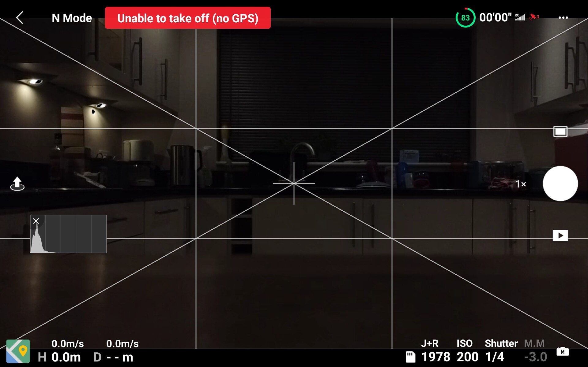

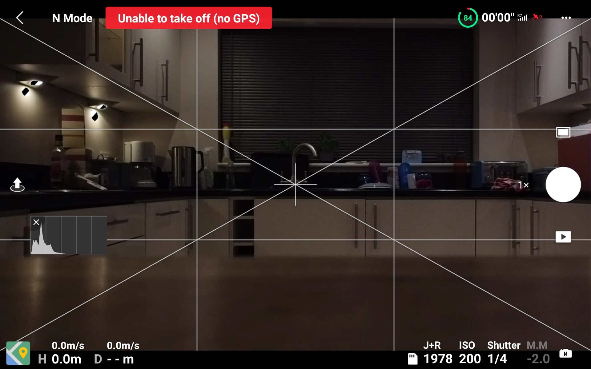

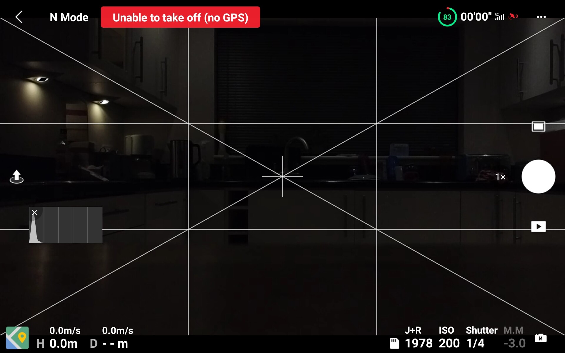

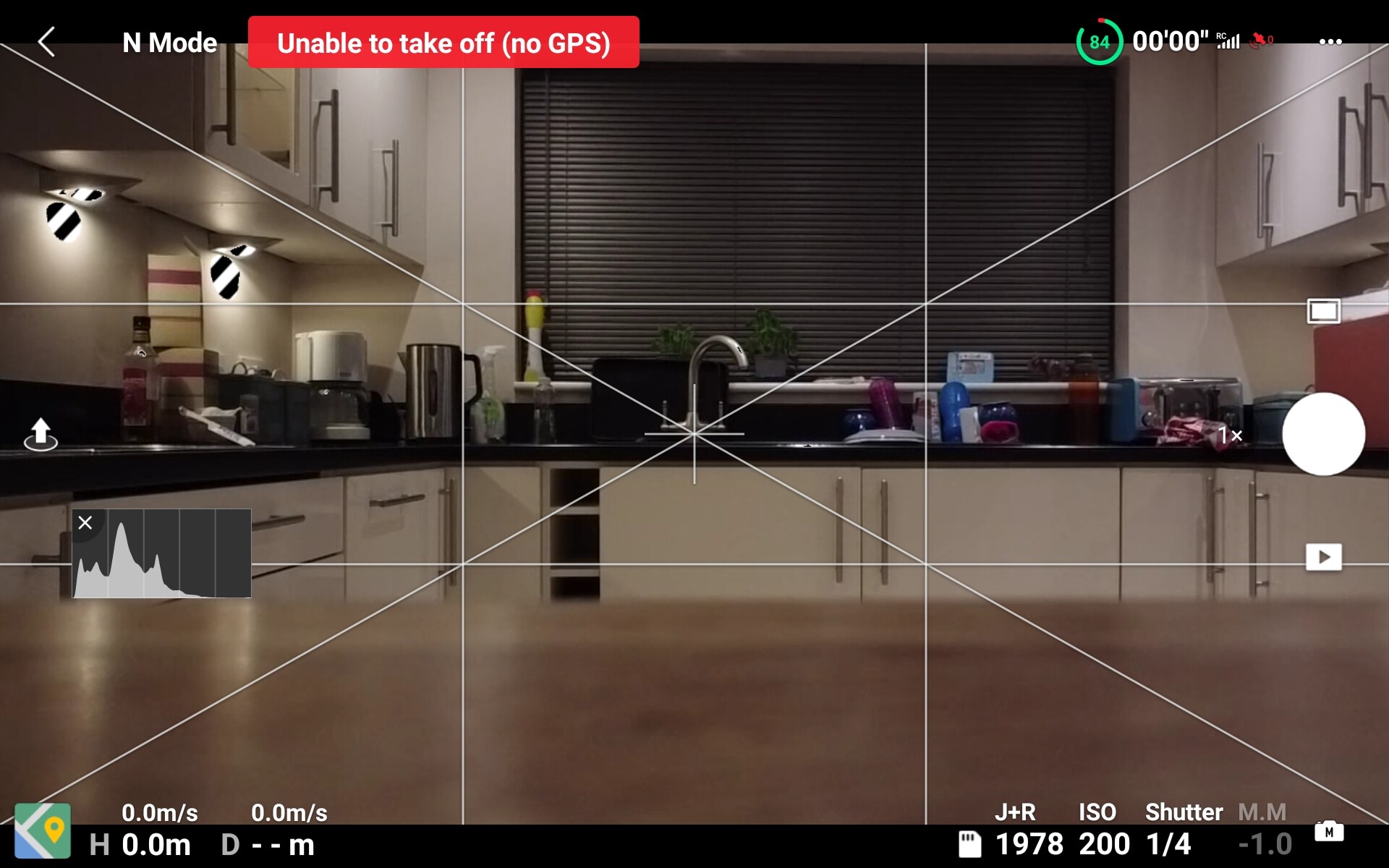

Not really sure yet how to use them, so looking for any good advice/links to read up on, they seem decent, I have posted some screenshots with the filters on to see if the camera settings changed and they did! don’t know if this is of any use :man_shrugging: haven’t tested them in the field yet. Any advice welcome :wink:
Think of the ND filters as sunglasses for your camera. For video and to achieve ā€˜motion blur’ your shutter speed should be twice your frame rate, so if you are shooting at 4k, 30fps, your shutter should ideally be set to 1/60th second. As your aperture is fixed, the only way to do it is to restrict the amount of light entering the lens, so this is done by using ND filters. There will be a degree of trial and error to achieve the correct reduction, but with time, you will be able to assess the lighting and use the most appropriate filter for the conditions. You can also use the ISO setting to adjust the sensitivity of the sensor to light to achieve the desired result.
The UV filter is really best used as a lens protector, the effect it produces is minimal and the polariser (CPL) will enhance colours, by reducing reflections, so deepening the blue of the sky etc. The effect is most noticeable when working at 90 degrees to the direction of the sunlight, so probably more suited to still photography. Best effect can be set by turning the front element whilst looking through the filter. Look at the windows of a car through the filter to give an idea of the effect.
