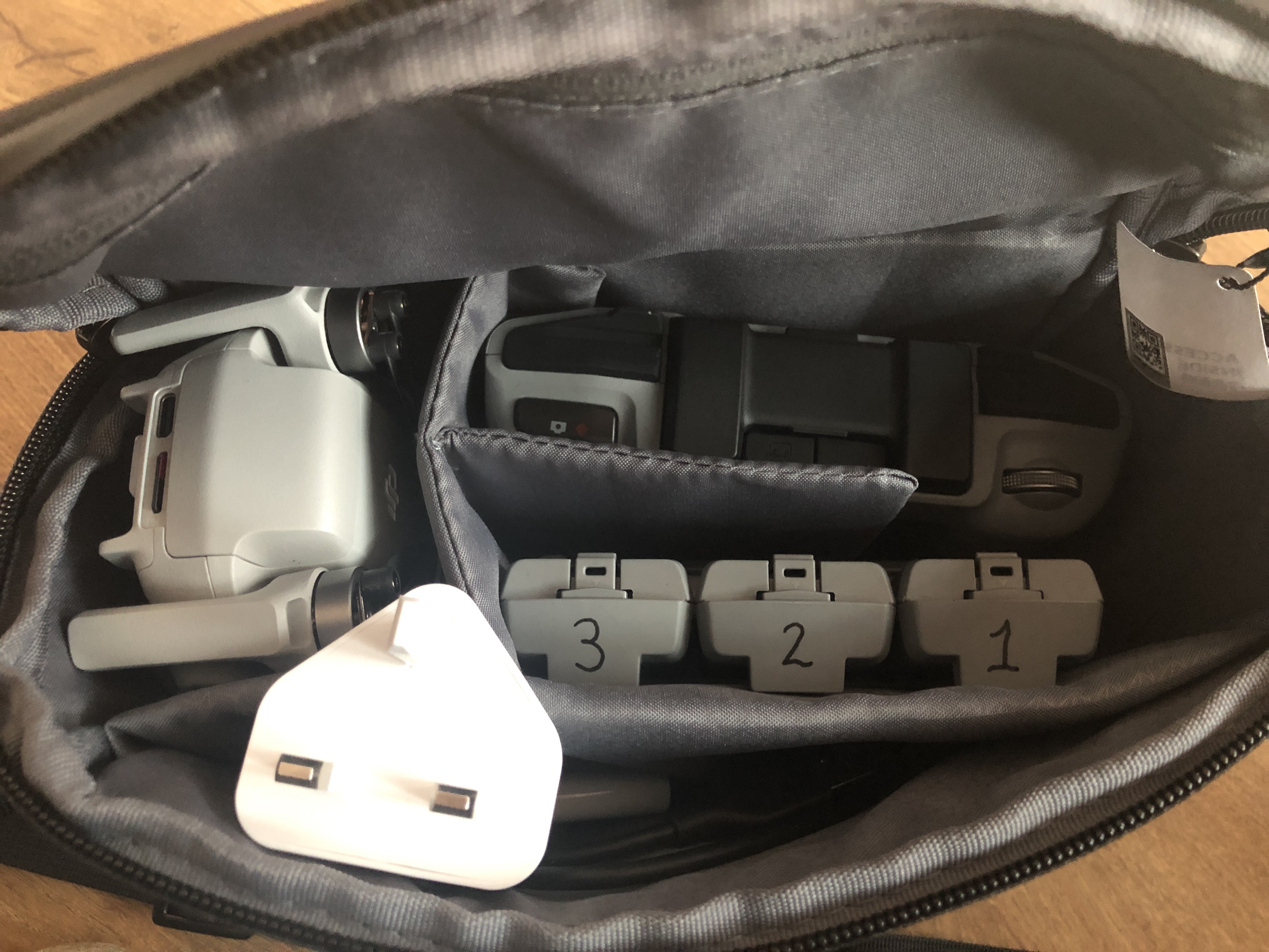

Appeased somewhat now though because you can turn them around and they will rest reasonably nicely in the hub still and the Fly more bag can still be closed.
You can actually push them right down into the hub the wrong way round, they fit tightly but not so tight that it feels like anything could get damged in the process.
This might be a good answer to storing the mini 2 batteries in the hub
