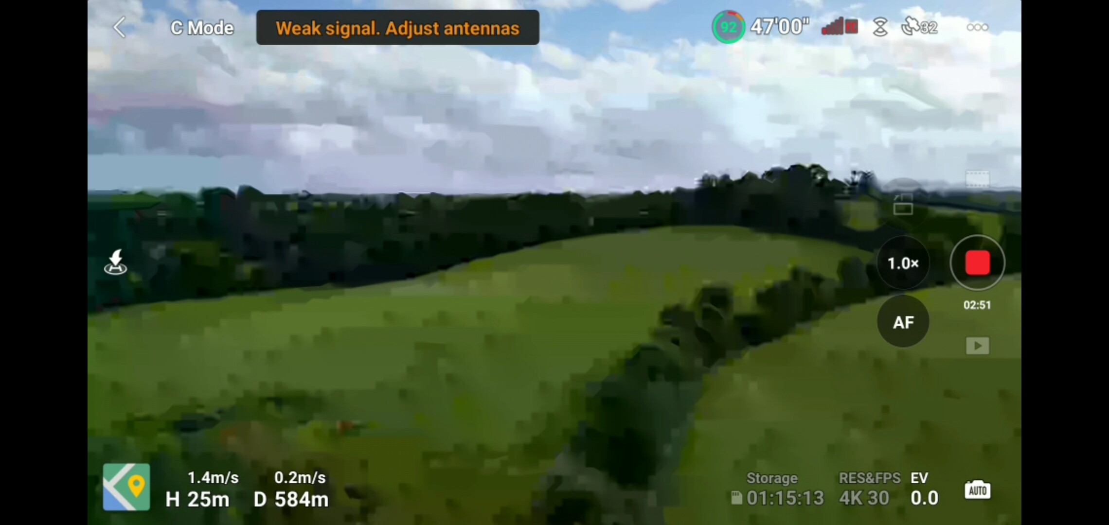

I can get distance if I fly high, but I can be about 100 mtrs away and if goes behind a building or tree signal loss which all my other drones never do this unless it was a very long way from me in which raise the height with mini 3 I max out height to get distance then it’s fighting high winds then. I was so used to mini 2 scooting around and always good signal.
Alex I did a test and surprisingly not bad considering I’m situated low with hills all round me, even gave a test being building and trees and it kepted signal upto a point.
I did a few tests I flew 2 flights with DJI RC-RM330 and DJI RC-N1.
DJI RC-RM330: First 600 MTRS was low level flying above the trees it was only when came to the end of my woods it started to lose signal then I maxed the height and went a further 1100 MTRS before I RTH.
The DJI RC-N1 just over 100 MTRS more in both scenarios.
