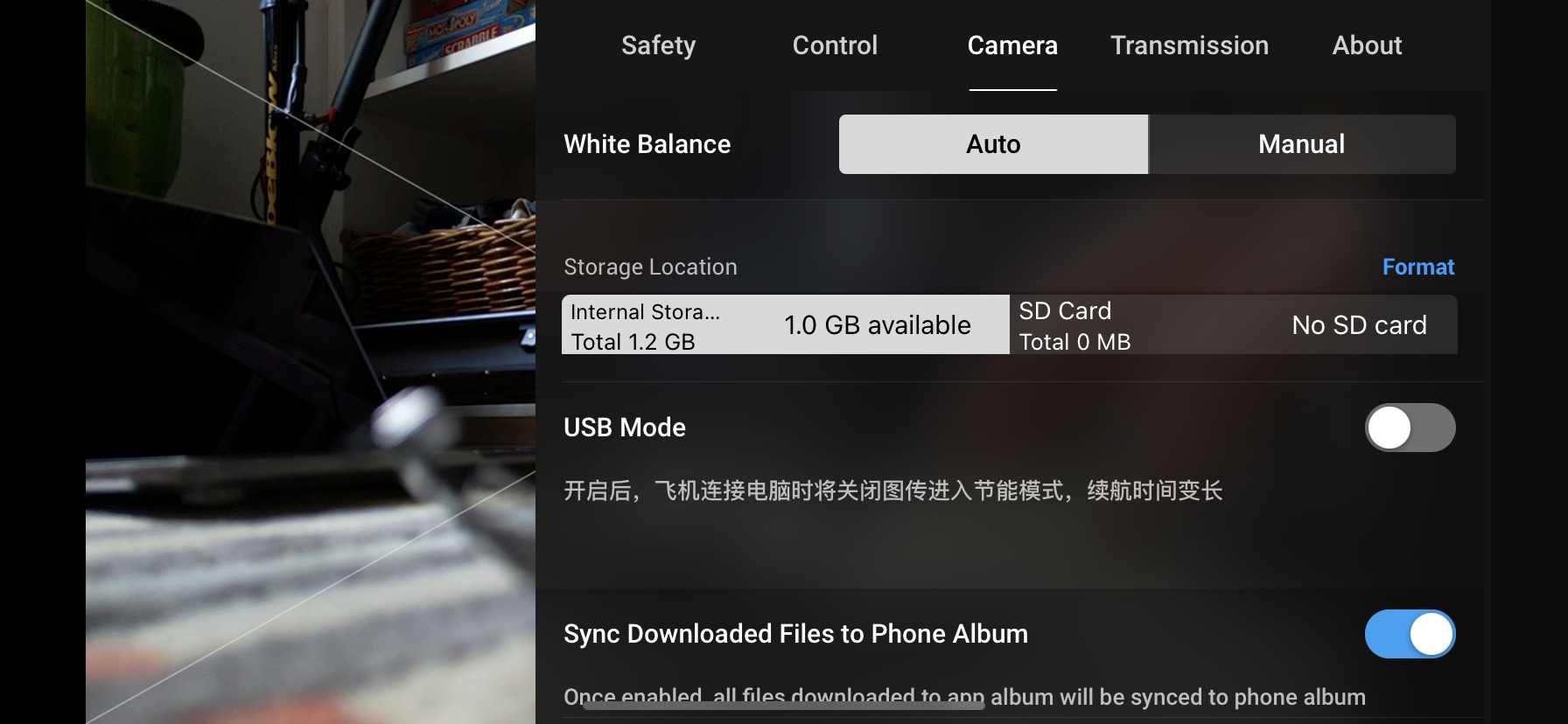

Oh don’t worry I am going to along with the Chinese that shows up on USB port option like this:

How weird. Mine reads in English. Assuming we’re all running same version… Like my compass, works for some.
