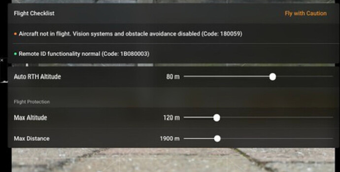

Has anyone got the plus battery and willing to do a test?
No sorry, just 3 ordinary ones.
I have… what do you want testing?
Update to the latest firmware and fly app
Go outside with the plus battery installed, power up and wait for a full GPS sats count
Then take off or just start up the motors

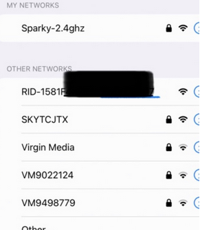

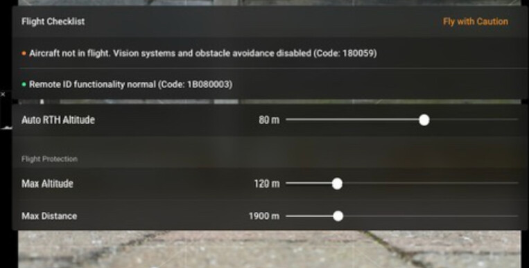

Check to see if RID is active, this can be done easily by checking the flight checklist (top left of screen)
And with a phone check for a WiFi Network with RID and your drone serial number

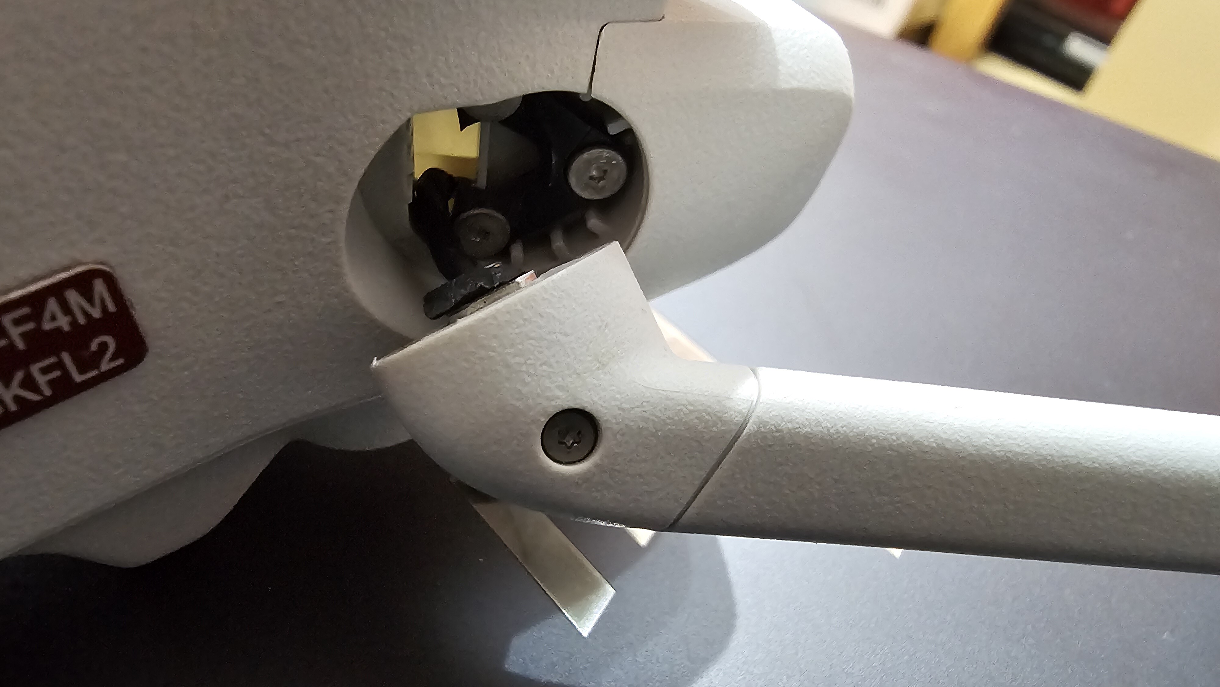

So… no sign of RID. But I did crash it in the process and break an arm off… :cry:
Oh how did you do that :thinking: hopefully you have care refresh :crossed_fingers:
I do. I’d tested it with just the motors running and it was fine. I decided to lift off a bit, knowing I didn’t have a lot of space - and flew straight up into a holly bush. Motora cut out and it fell about 2.5m onto grass but broke the swivel mount for the arm.
It’s sort of good news that nobody’s bought my M3P as I will have that in the meantime. And Care Refresh is great, but it’s such a ballache to sort it all out. Out this afternoon and tomorrow, so that’s a fun job for Christmas Eve.

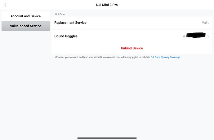

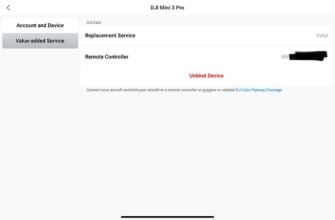

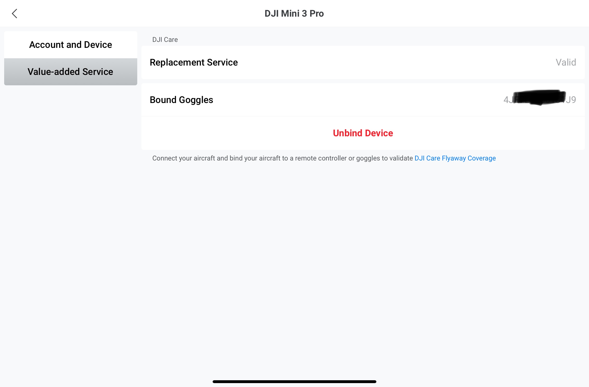

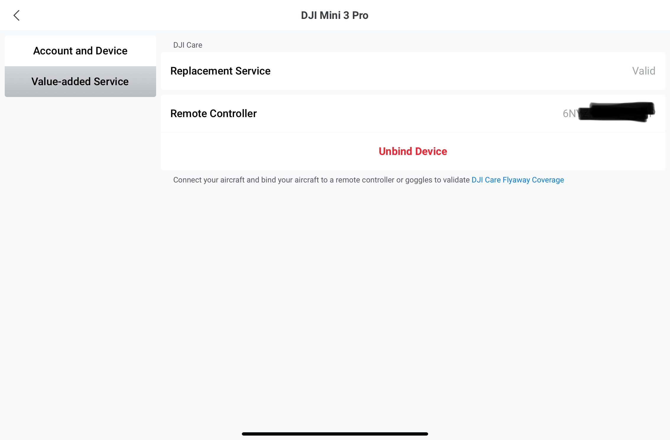

@Njoro
Yes sorry its the goggles you have to bind to the drones care refresh
You will need to connect them to a device with the fly app on
Goto profile, device management, pick the drone and then value added service
You can change it here
I just changed mine from one to the other
