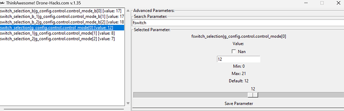

Just tested Atti, sadly, it didn’t work … it just switched to Cine :cry:
The above hack has worked on every DJI drone I have had, including the Air 3 (despite it being limited to 68 mph).
I really hope DJI haven’t locked this down as well.
Going to make a change and try again after a full charge.
Apparently the latest DJI drones went switched back on reset the parameters back
I have reread your sentence 3 times, it makes no sense.
What do you mean?
On the older drones you can change parameters, but on the new drones, a lot of the parameters will reset back to stock upon boot up by DJI design.
OK, cool, I will rewrite the params, and with the drone still on, unplug the USB-C and switch on my RC2 and see if that bypasses this DJI sillyness.
Confirmed.
Mode 0 has reverted from a value of 3 (Atti) to 12 (Cine)
The cocks! :face_with_symbols_over_mouth:
Well that worked, thanks Wayneo :+1:
I wonder if the top speed will be limited as well
Let us know
Doesn’t Sincoders hack have Atti mode :thinking:
I will do after a full charge. I really hope it isn’t limited, although that will prove my theory with the Air 3.
Definite looking healthier now :slightly_smiling_face:
