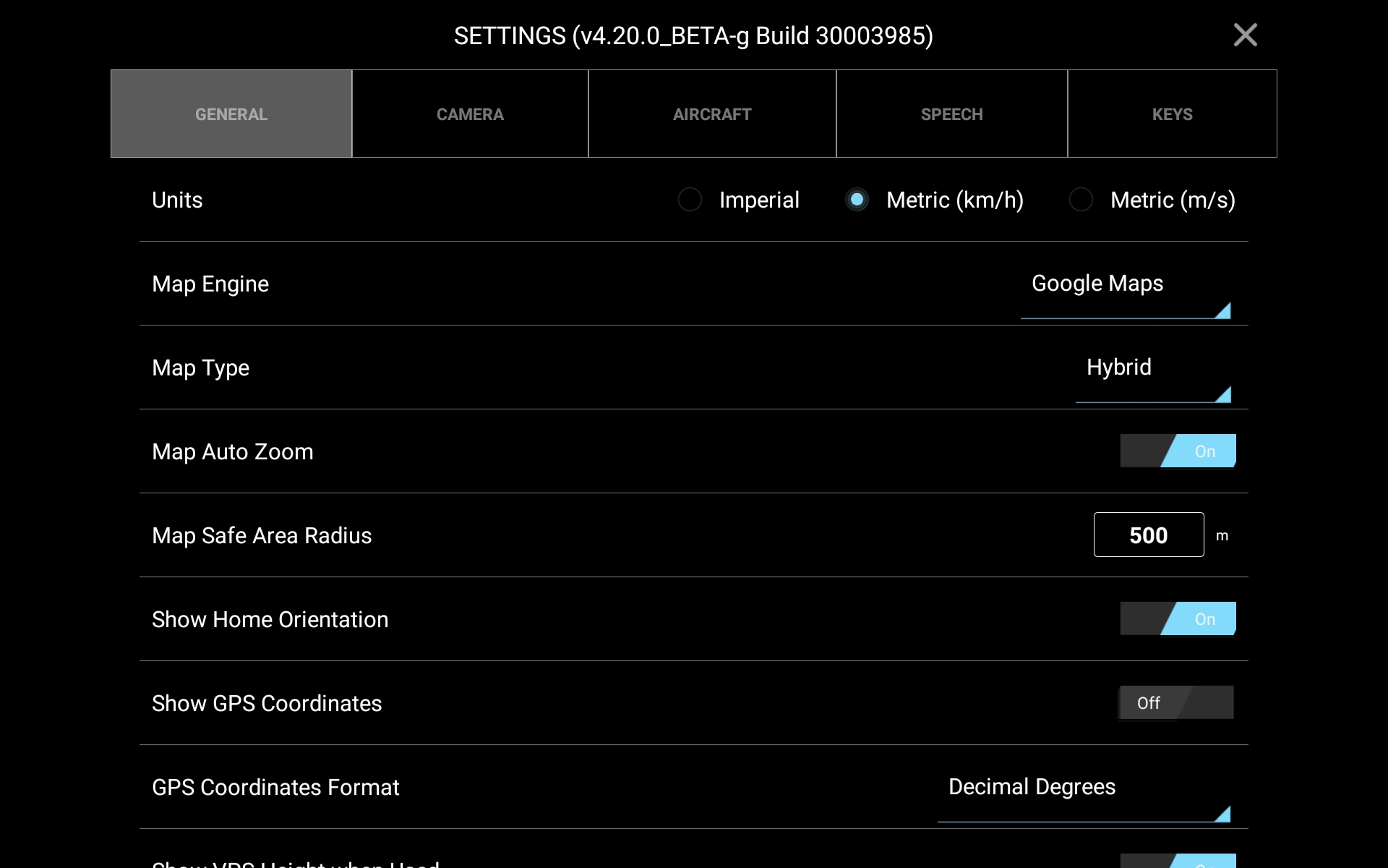

Update for beta to 3985
Any release notes you can share for these incremental updates @Sparky ?
A new build number doesn’t tell us much :blush:
That’s a no then :rofl:
Unless that changes each time? I’m guessing not going by the first line :slight_smile:
That’s your lot :grinning:

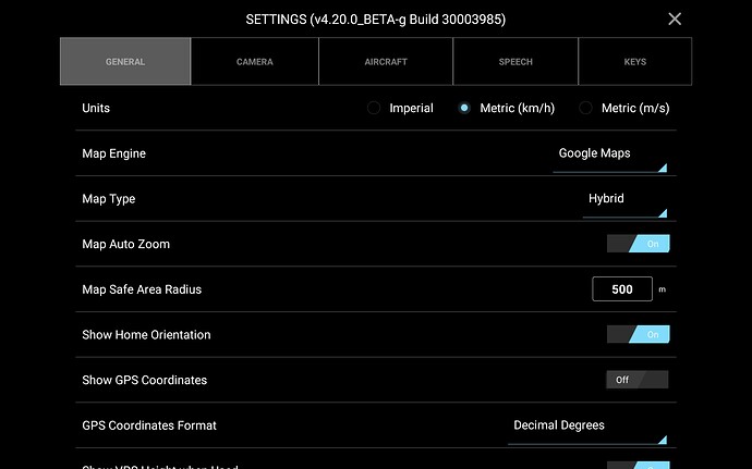

ver. 4.20.0_BETA-g Build 30003979
Now resolved in Build 30003990 :smiley:
