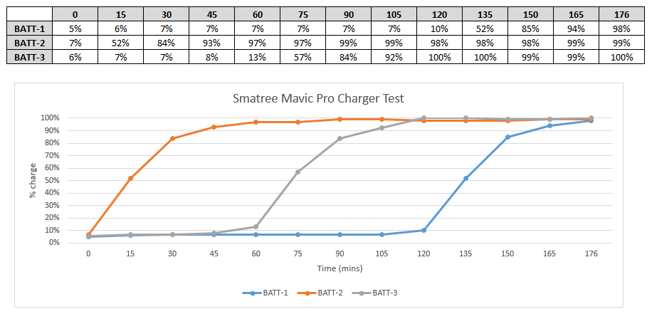

The SMATREE charger arrived today.
Quick plug in shows that it does charge all threee batteries together, but not always continuous ? It seems to see hwich battery is lowest, gives that continuous charge and charges the other two on a stop/start basis
I suspect it is aiming to bring all to 100% at the same time.
I’ll do more testing to see what’s actually happening
see video here https://youtu.be/zp6THA5QgHs
Cheers Steve :slightly_smiling_face:
Thanks for the latest Steve. Just seemed a bit strange as there is only one lead going from power supply to battery hub, although looking at the video it does seem that the batteries were charging. Would be interested in how long it takes as it seems to be working on the same principle as the original DJI hub. (charges battery with highest charge first…) All the 5 in 1 chargers charge individually and take about 70-90 mins.
Peter
This Smatree charger/hub is no different from the standard DJI hub, it does not charge simultaneously, only sequentially, like the DJI it starts charging the most charged pack first.
Manufacturer says the charge time is quicker than DJI, their claimed 140 mins (DJI 210 mins) for three batteries is not what I’ve just experienced, 176 mins, started from about 10%, they refer to 0% as the start of charge for their claim.
So nowhere near as good as they claim.

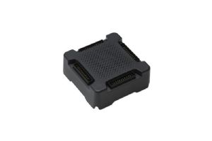

The Advanced DJI hub that Pingspike (in post*3 above) says it charges all the batteries simultaneously but I think this is also not correct.
Indeed, the Advanced Hub can charge three batteries simultaneously, not four :+1:
Still, better than one at a time.
Potentially an expensive option though if you don’t already have a 100w DJI charger from another drone (eg. Phantom). But if you do, it’s a cracking OEM solution :+1:t2:
Rich, exactly how does the advanced charger work? From reading the spec, it seems to be the same as the original hub, charges one and then moves on to the next.
