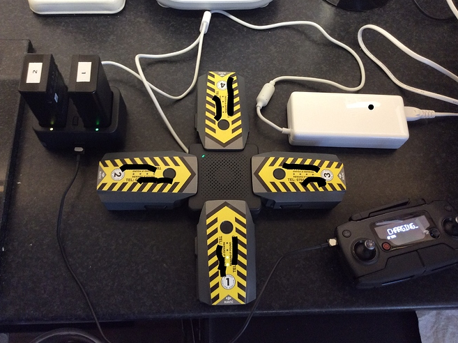

My only concern (!) is that although I have the Phantom 4 power unit, I only use it to charge my Crystalsky batteries and use the ordinary hub for the Mavic batteries. Just wondering if using it to charge the Mavic batteries and the CS batteries at the same time will increase the charging time.
I used to connect all four MP batteries, and the CS Hub with two batteries in it, and then connect the MP controller to the CS Hub, so everything is “queued”.
The CS Hub will only charge in-turn and I have a feeling that’s at the cost of one MP battery. By which I mean, only two MP batteries will charge concurrently and one CS battery.
But if no CS hub is connected then 3x MP will charge concurrently.
I think… it’s been a while since I used that charging setup.
Thanks Rich, you lost me after “I used to” . . . :grinning: but after sitting down with a cup of tea and a muffin and re-reading it x7, finally got the gist. Where do I stick my RC though !!

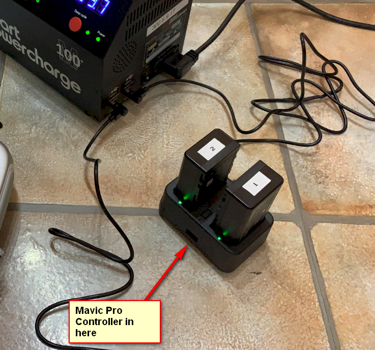

The CS Hub has a regular USB port on the front of it, so you just need a regular USB-to-MicroUSB lead and connect to the side of the MP controller :+1:t2:
:scream: :grinning: :grinning: :grinning:
Ah, knew I had a better pic, you can just make out the USB cable exiting the front of the CS hub and going in to the side port on the MP controller:

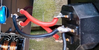

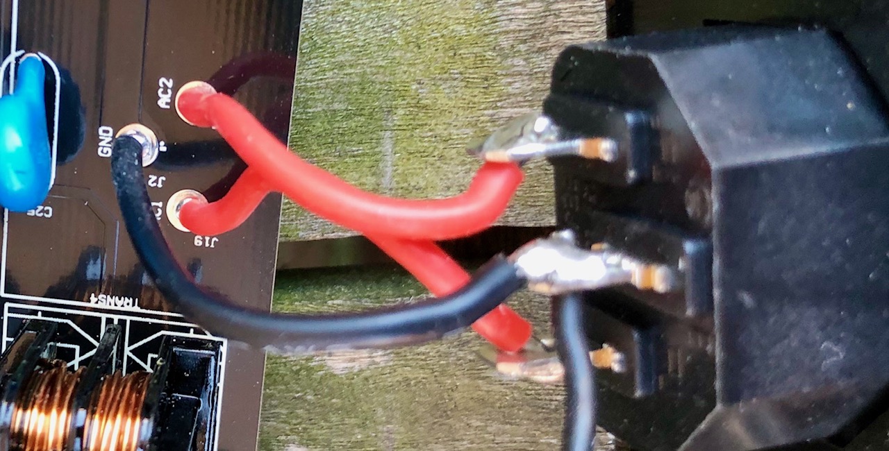

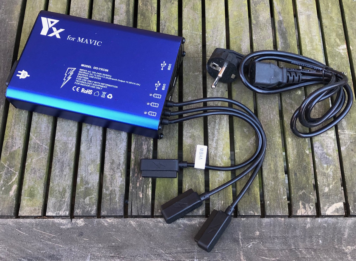

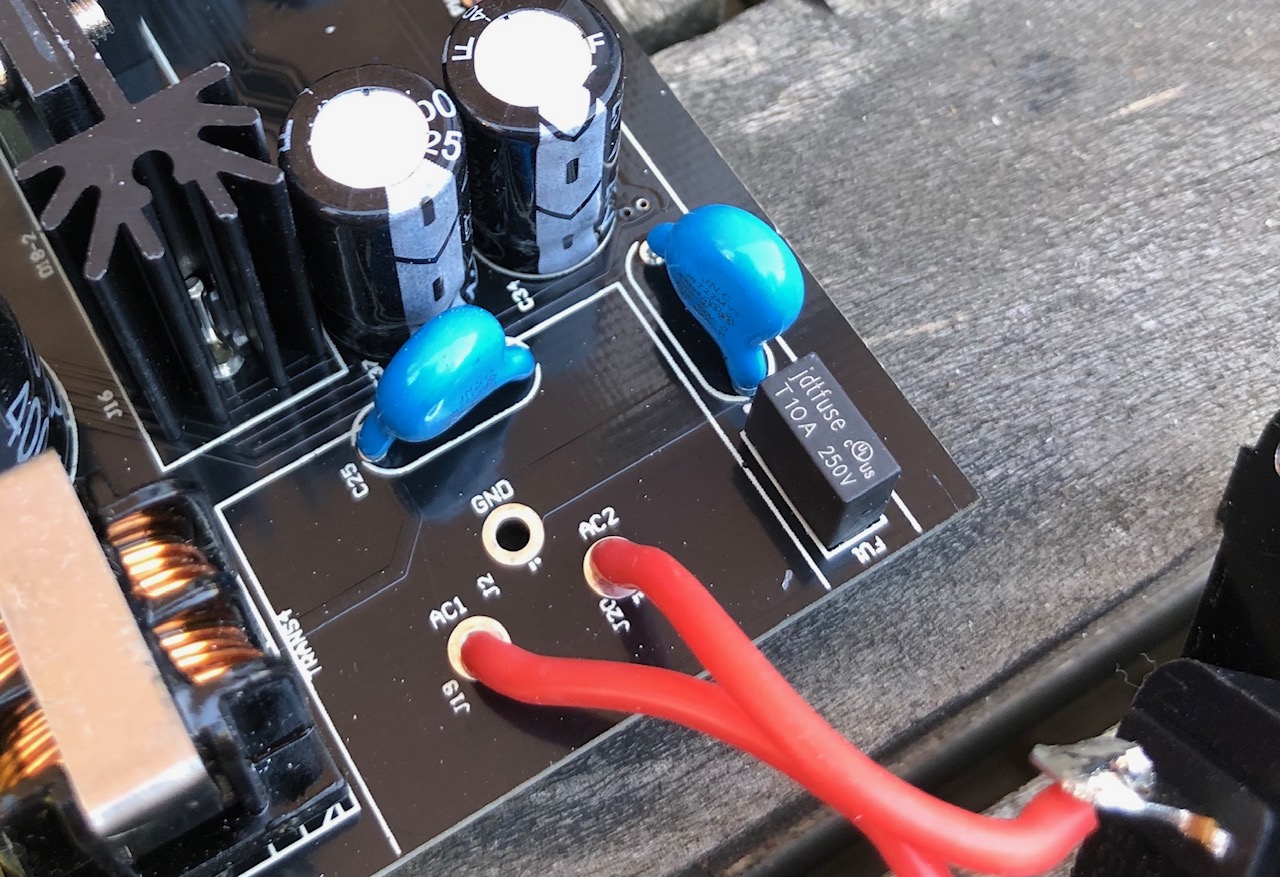

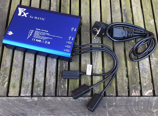

So I bought the 5in1 from Germany, it arrived yesterday. :ok_hand:
Needs a UK plug fitting though.

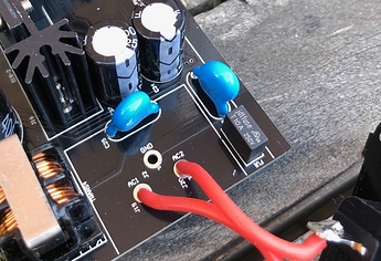

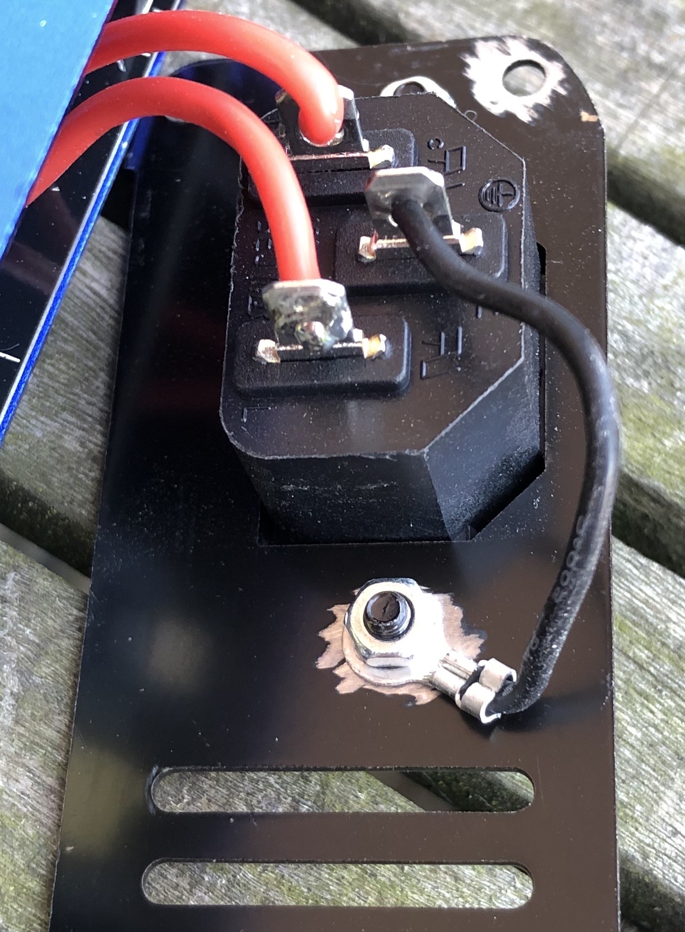

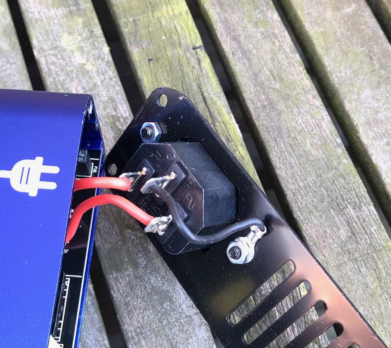

Checked the earthing, it did have the wire link to the case, but terminal was on to paint so I re-made the connection better
Then noticed that the Earth connection on the PCB was not connected, traced the copper track which went to a protection component (VDR ?) so added a wire from earth to this pad.
All works good, charges batteries at the same time and two USB’s for RC and tablet.
I think I’m going to be happy with this now :+1: :grin:
