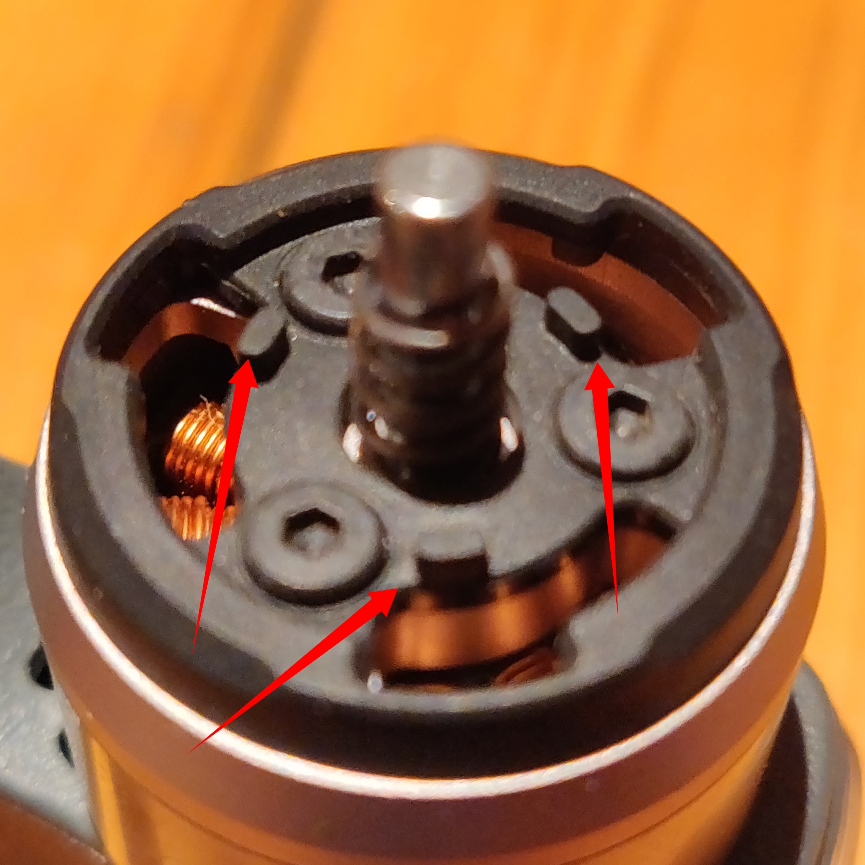

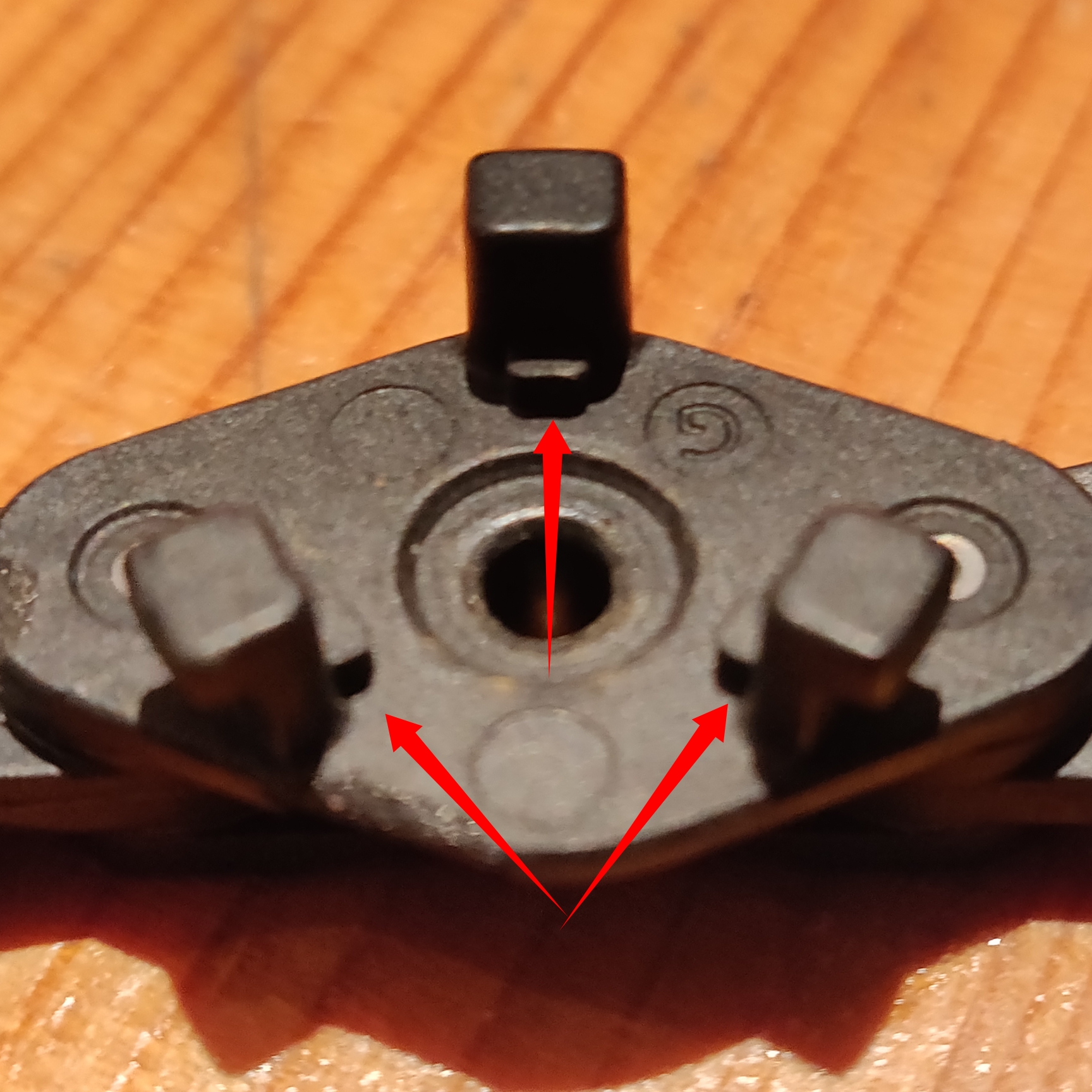

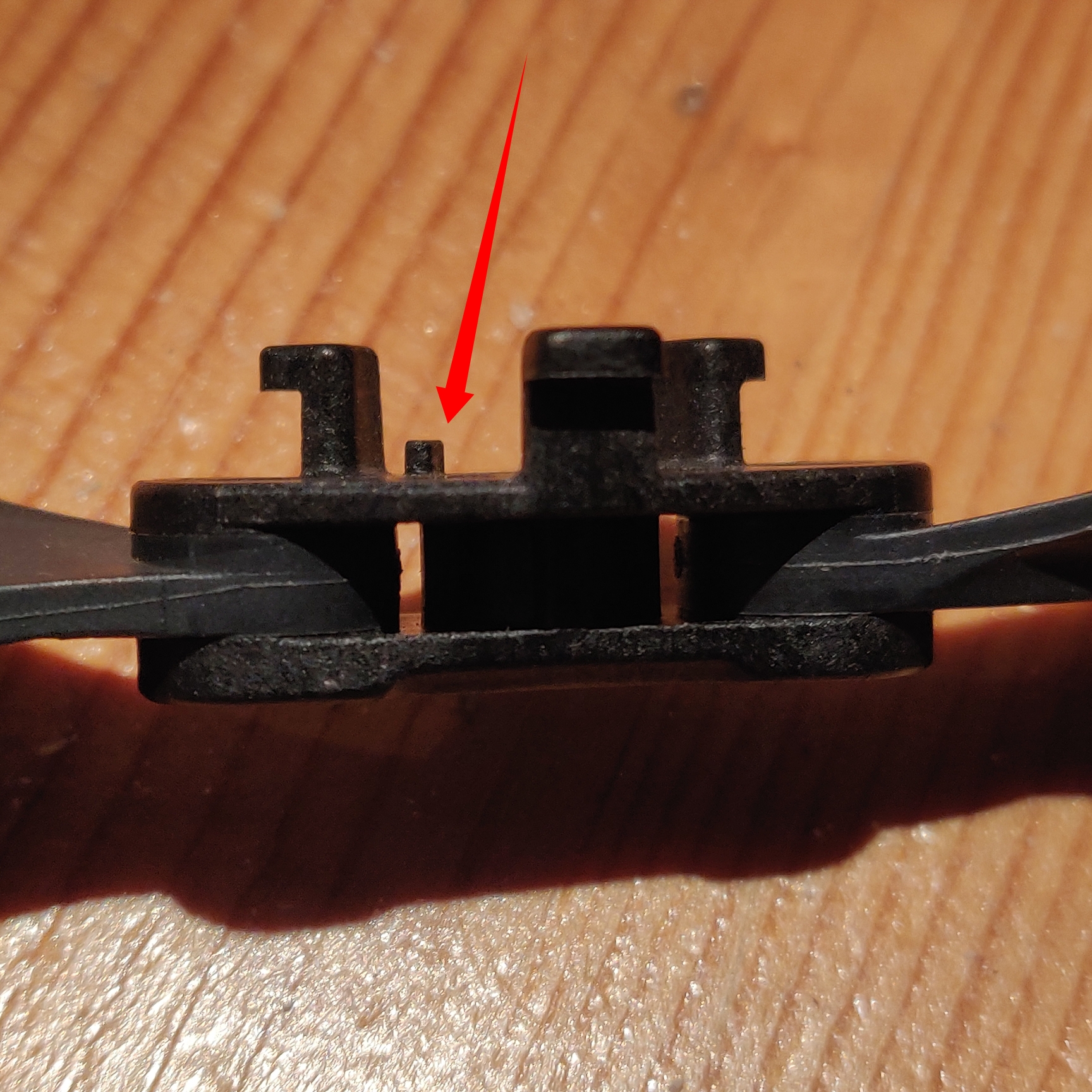

Just tested this, they push down on the peg but do not lock in place… so no, they can’t go on the wrong corner
Is what stops them a small plastic lug that can possibly have broken off?
Yes there are lugs
Same on MP - small ones - pics in a tic.
Pics …

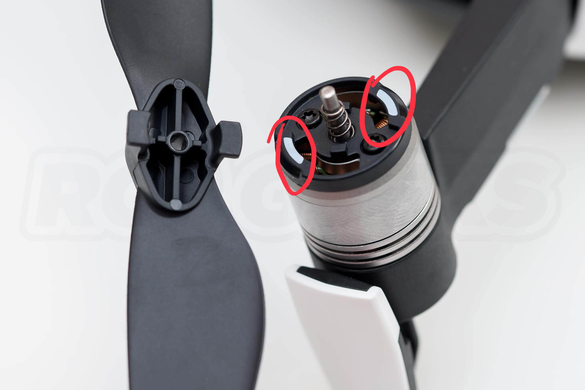

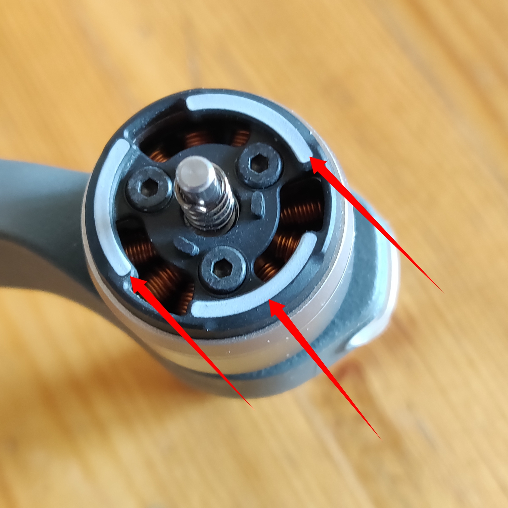

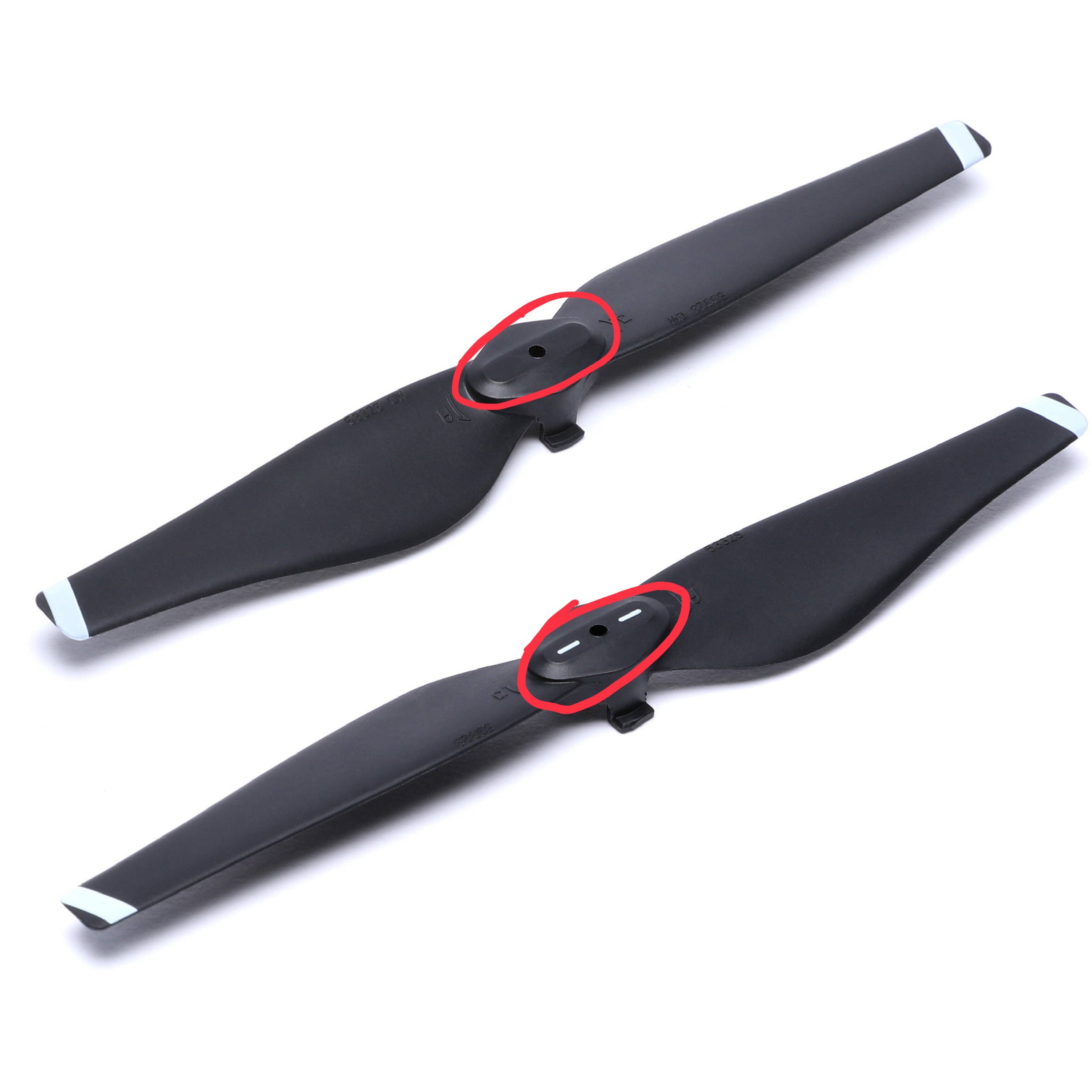

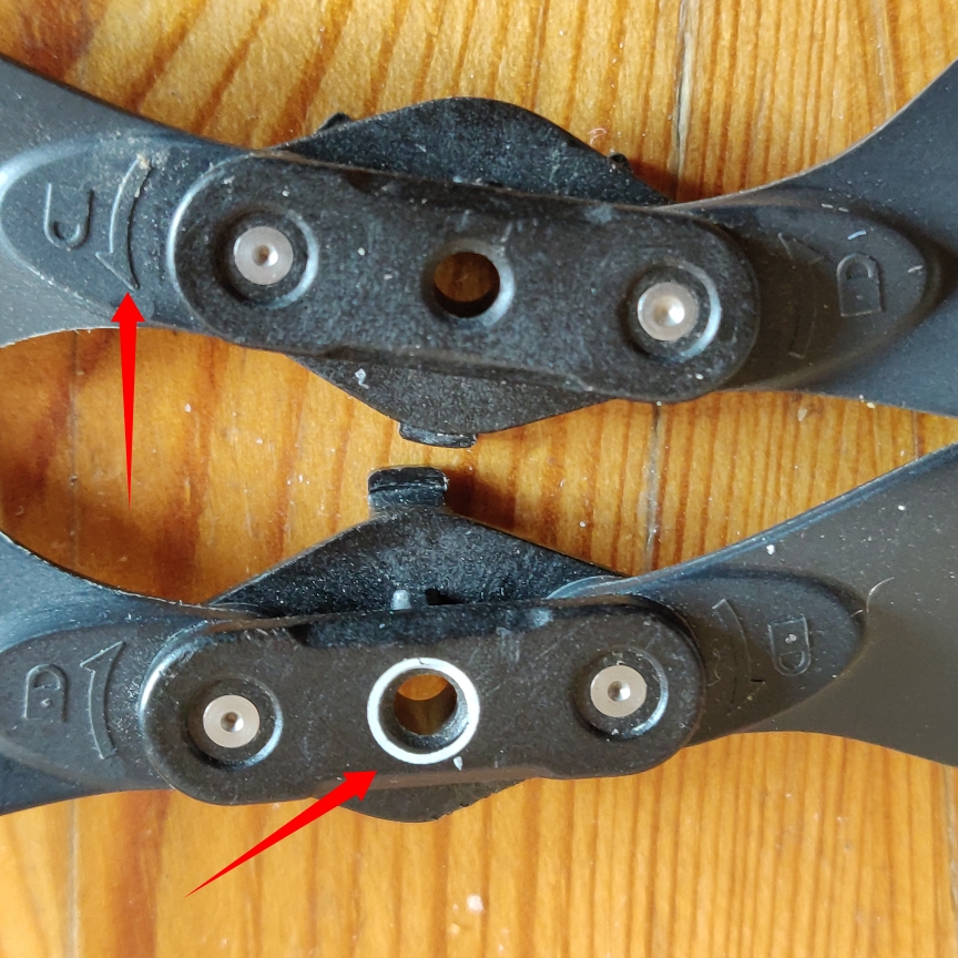

And the props are marked, too, one with a white ring near the centre that goes with the motor with the white markings.

I don’t know about “lugs” on props off top of my head but they are marked up white and black on props and motors. See pics

Those, I take it, are Air props?
Interesting to see the difference. :+1:
I added the comparative MP prop/motor markings above, for those that are curious. (Not that they’re much use at night. :wink: )

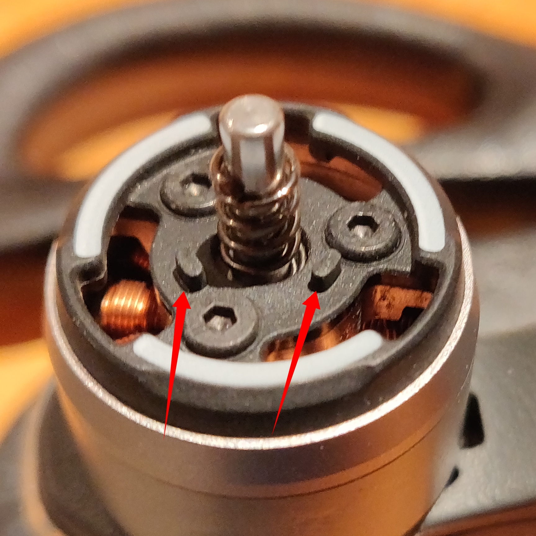

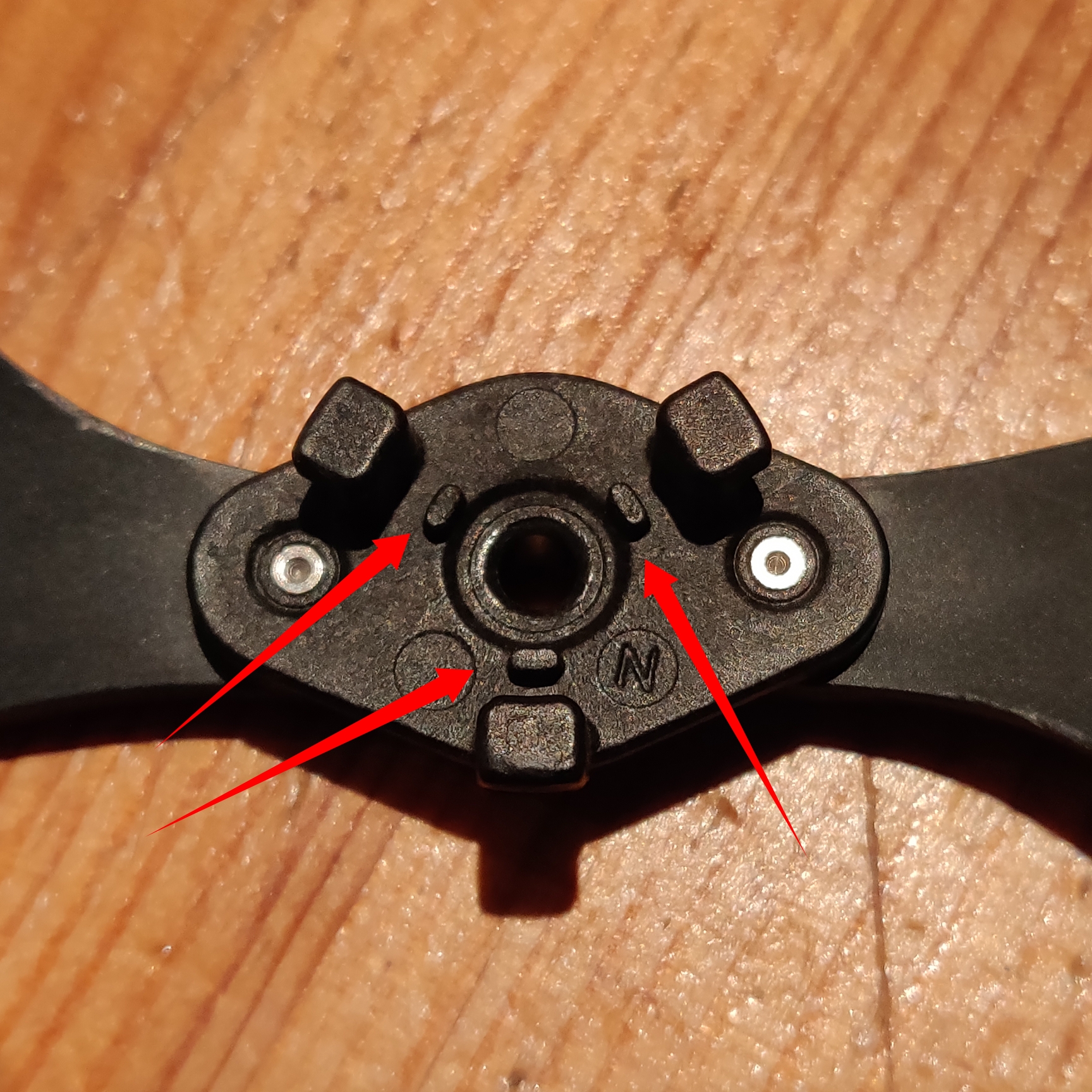

Yeah they are, I don’t know if they physically fit on the wrong way (they don’t have the lugs like the MP ones) but if they do check the colour code
I’ve hunted and can’t find the previous thread where someone had them on the wrong corners - with the same consequence, obviously - and I’m sure that was also an Air. And, if so, I was trying to see why it appeared to be just the Air that sometimes had this problem.
All useful info.
Just had my MA out to have a look, the props don’t lock into place if you put them on the wrong motor, altho I can’t see what stops them locking into place :thinking::thinking:
Just got my Air out, (haven’t sold it yet). You can put the props on the wrong motors. At first it seems like they won’t rotate and click into place but with a tiny bit more pressure they do.
