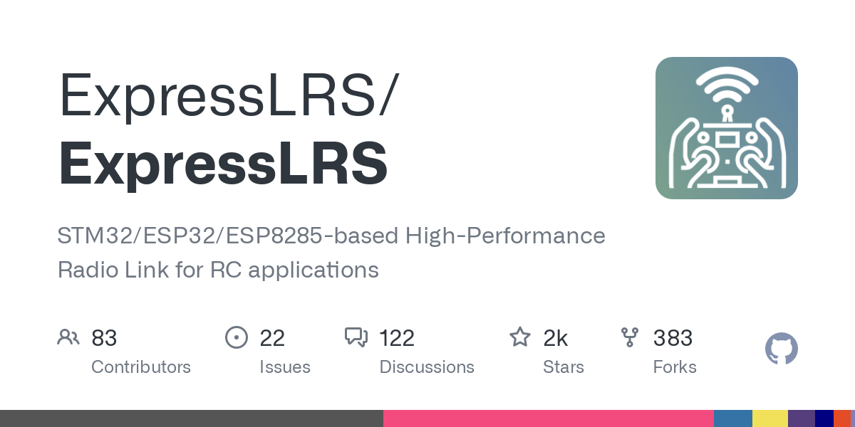

(Edited to add link to RC1)

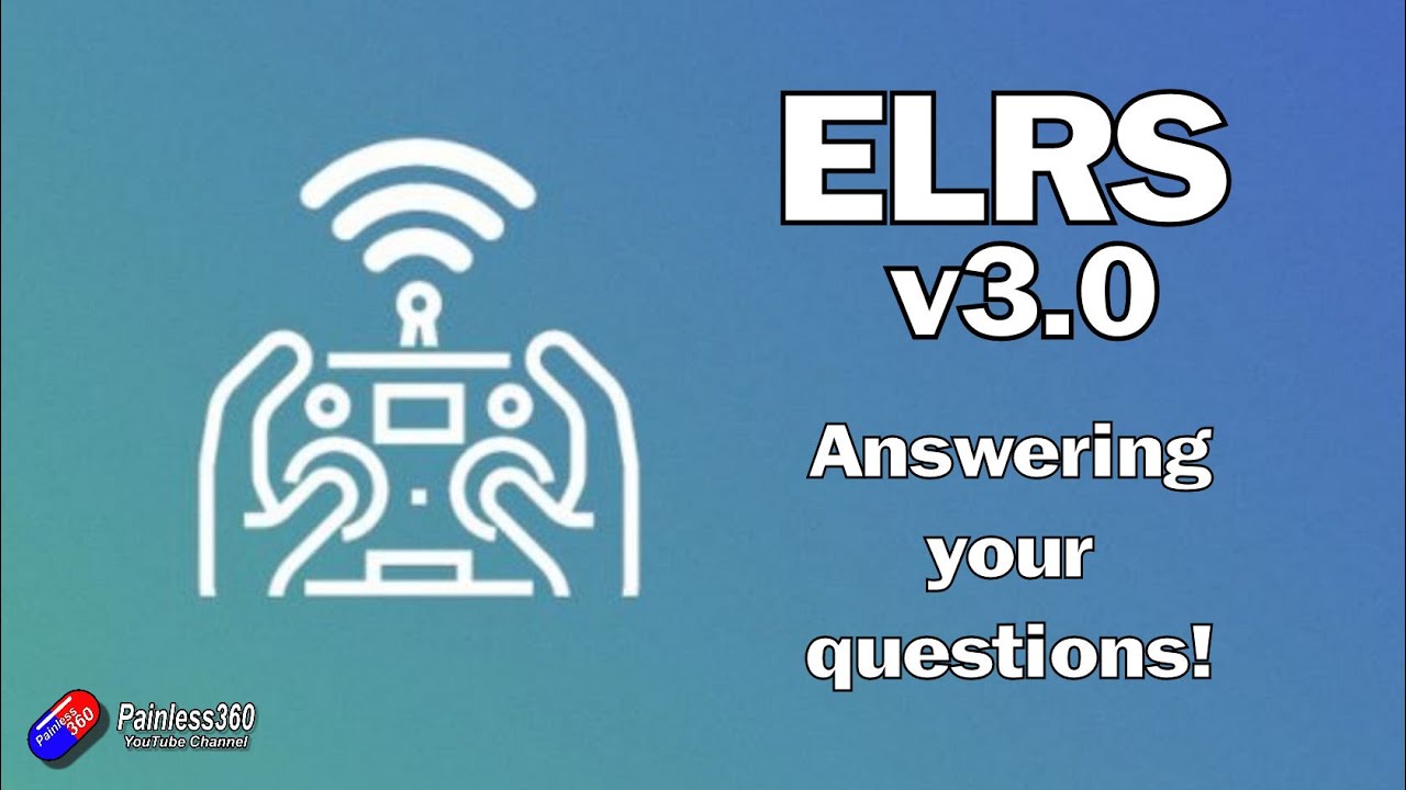

BTW… On a video by Painless360 last night an ELRS dev said that for the first time ELRS 3.0 would be backwards compatible with V 2! He then did go on about having modules for both and switching, which confused me a little…
Yeah was the p360 video I watched too. Guess no harm in upgrading my tx to V3 and seeing if works with the spis

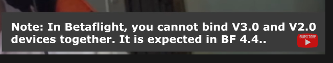

I note there is a confusing “Note” overlaid over the top of the video… I have posted a question on the video about that. Lets see if Lee responds…
Note?
this is the bit that discusses the V3/V2 and SPI
Ahh see you mean:
I reckon that means you can’t use the bind function. I use passphrases so probably all good to go. Will have a bash later.

He answered… but his answer does not help.
I saw your comment, seems to have gone?!
That’s clear on the RC page… Oh very confused.com! :wink:
OK chatting with @FOG_Yamato in discord (Simion who was the dev in the video), confirms that support WILL come in BF4.4 to use V3 TX with a SPI RX’s. It’s not there yet. Will hold off V3 until this comes or get a 1W TX…
