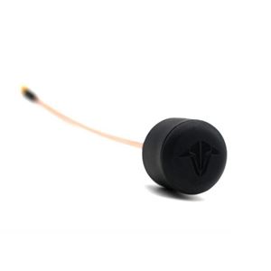

Antenna yeah you’ll need an antenna for the VTX although the VTX will come with a linear antenna that will work but for better video range you’d want a singularity antenna. I use the TrueRC:

Buy this antenna, it fits the Tiny Hawk perfectly (see photo below)

I cant seem to find the truerc singularity antenna - any other recommendations there? Or is that kind of it?
There are other options but I’ve only used TrueRC myself so far (I’m still new to fpv)
Maybe something like this TBS Triumph Pro will do the job but wait for one of the guys that will know better than me before you purchase as I’m not sure just how small it needs to be to fit the TH2FS
