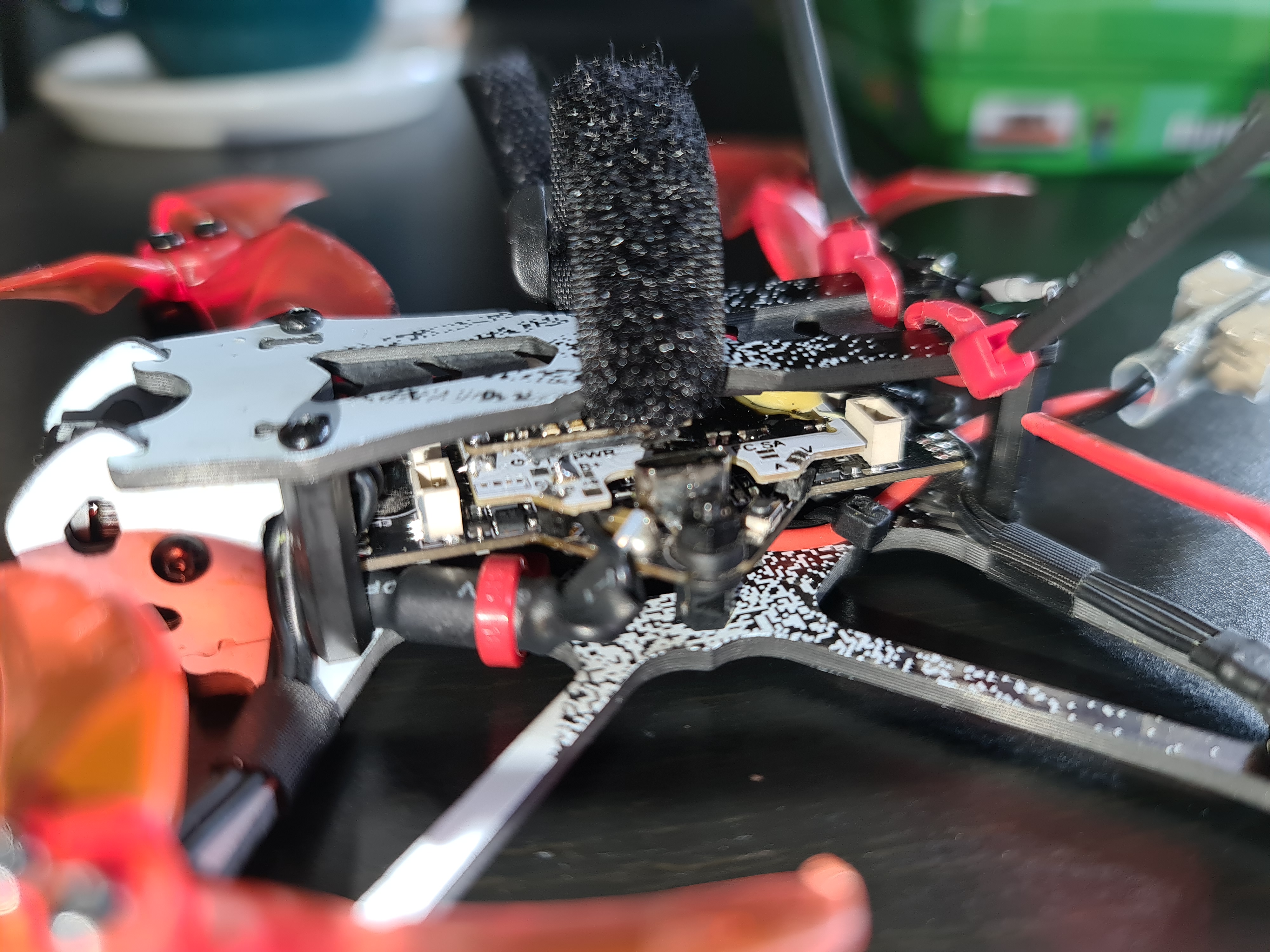

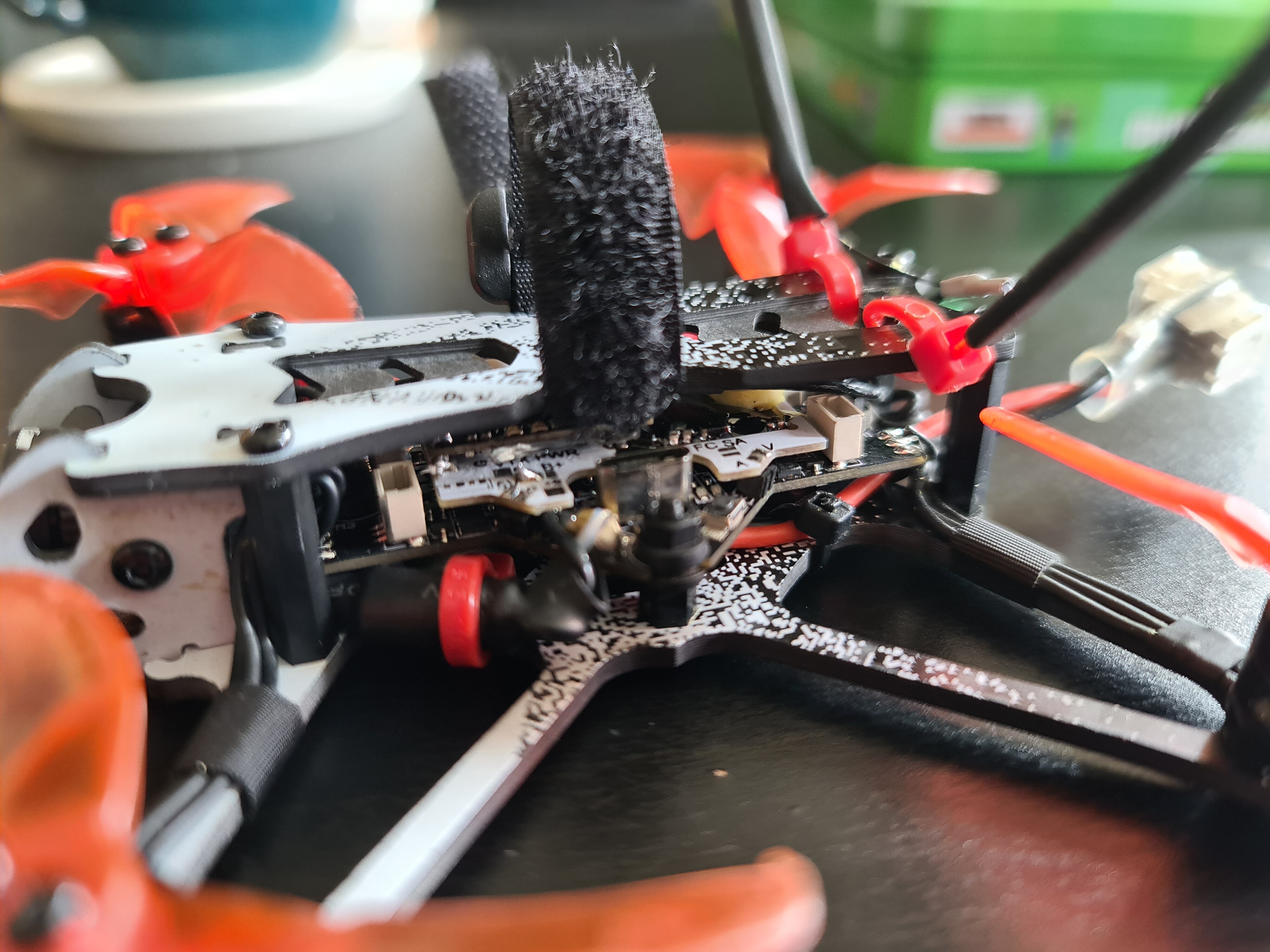

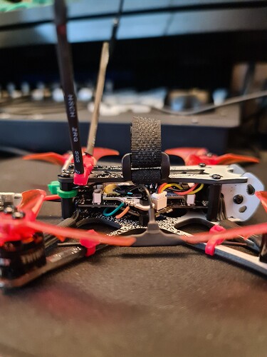

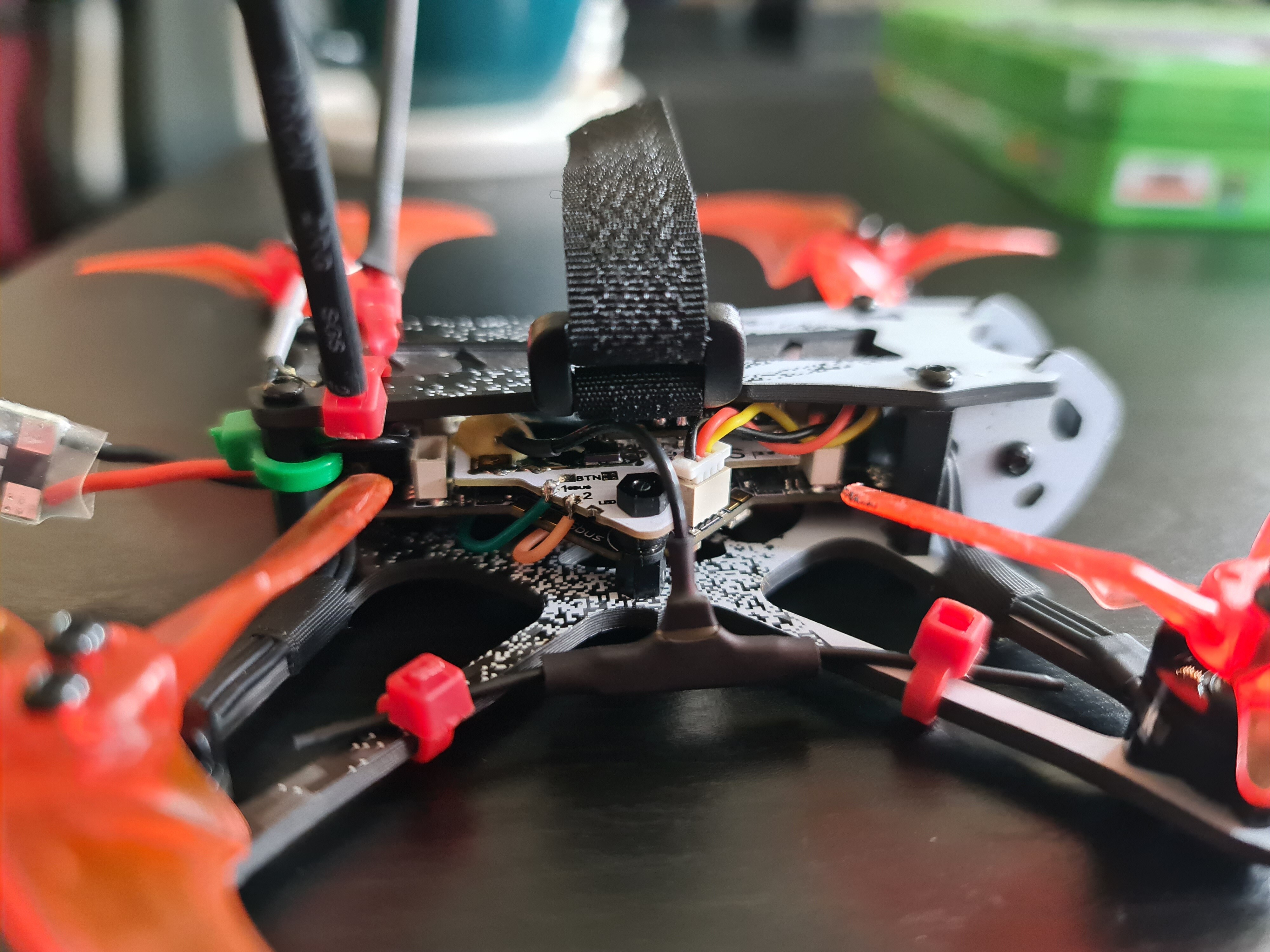

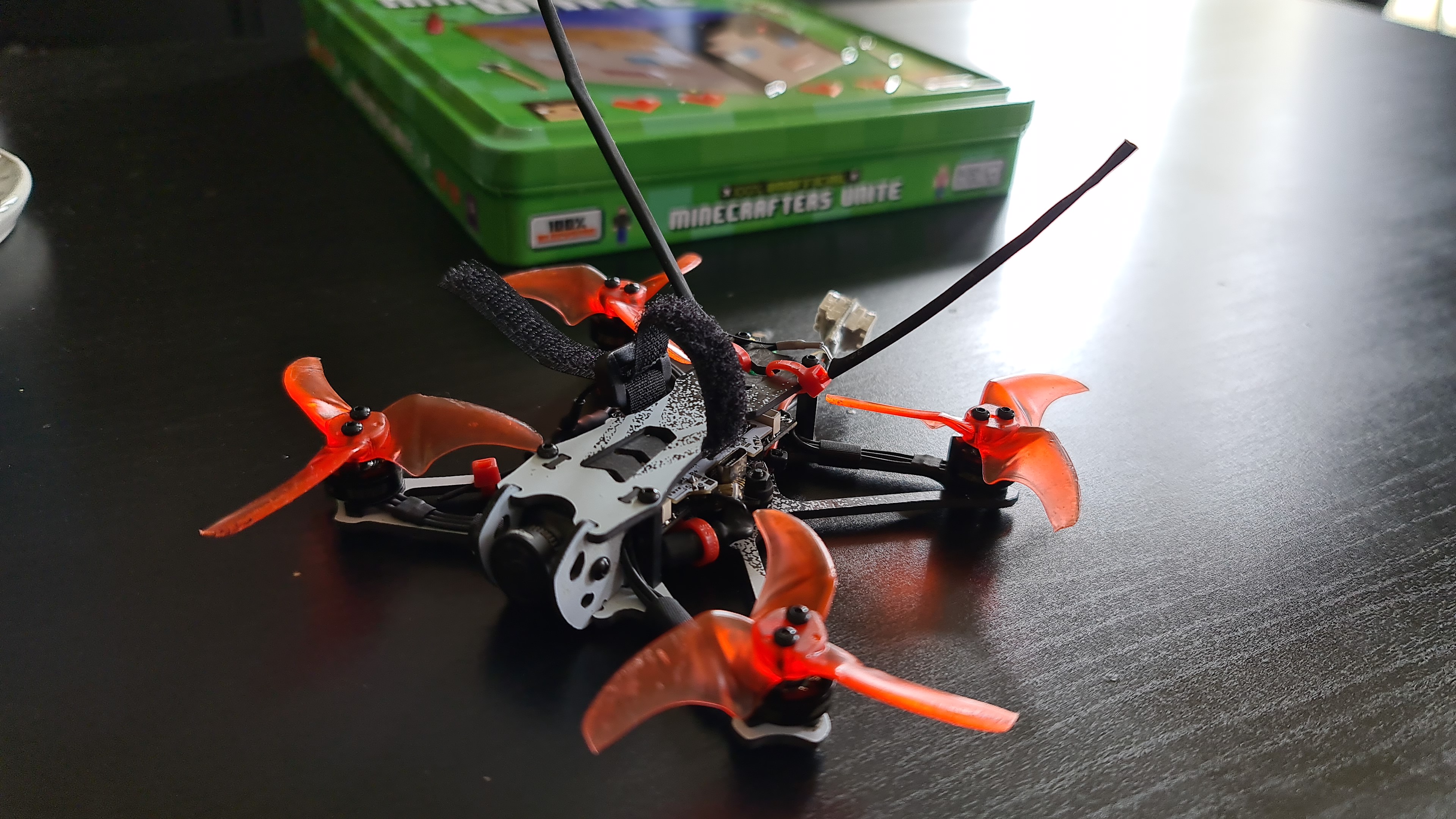

Some current photos, looking into alternative antenna for the VTX, I have a TrueRC Short on order, but would I be able to fit a normal Singularity, 80mm cable? I’m looking at it and it doesn’t seem too long? Or will I have issues this way?
Also considering xt30 connector swap and getting a few dedicated 2s batteries.
I just realised ive connected the Minimortal to my VTX and the larger V antenna i have is connected to the receiver, would i likely have damaged anything? Does it really matter? I will likely swap them anyway as it’ll bug me, and I need to trim the RX pins a little more for strap clearance anyway.

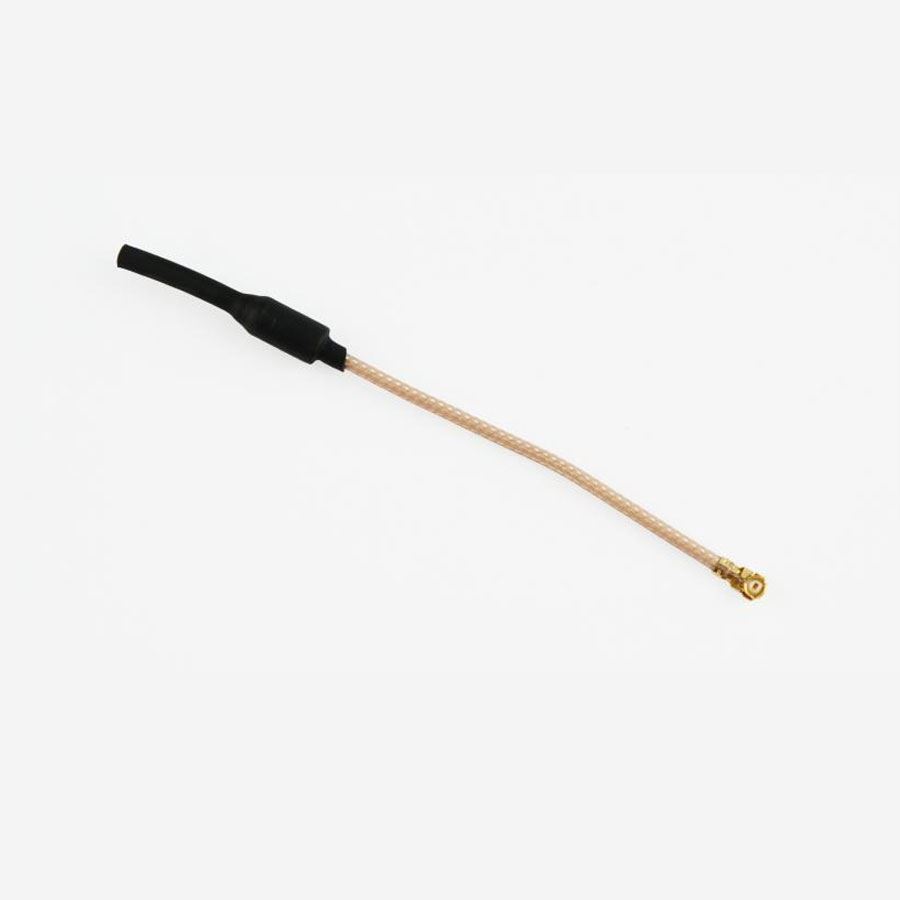

Both the mini mortal T and the whip “V” antenna are both receiver antenna. Shouldn’t of damaged anything your video signal would just be pants. The Pro32 nano would have came with an antenna that looks like this:
Use that till the TrueRC comes :+1:t2:
