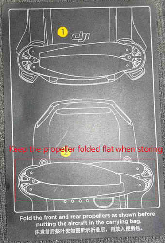

DJI published this back in May 2020 with regard to this problem …
Dear Valued Customers,
To ensure a safe and enjoyable flying experience, we have added a new safety notification feature on the Mavic Mini in the latest v01.00.0500 firmware. This new feature lets customers know when propellers need to be inspected or replaced.
【Potential Notification】 While operating their Mavic Mini, some customers may receive a notification on the DJI Fly app with the message “Motor Speed Error”
【Reason for notification】When the propellers are bent or damaged, the aircraft propulsion may be reduced and not perform as intended. The new Mavic Mini propeller safety inspection feature is capable of detecting this and sending a notification to the pilot with a “Motor Speed Error” message.
【Resolving the error notification】Please land the aircraft as soon as possible and check if the corresponding propellers are visibly damaged, bent, chipped. If the propellers are slightly misshapen, can straighten them out and retest to ensure the issue has been resolved. If the propellers show signs of major damage, chipped or bent, please replace them before flying.
Note: To help prevent this from occurring, pilots should follow the proper storage procedure for the aircraft. For reference, please refer to the image below. Please notice the placement of the rear arm propellers. Make sure the propellers are folded horizontally so that they are not pressed down upon during transportation. Pilots are also recommended to check the aircraft propellers before every flight.
Get the impression DJI was suggesting improper storage of the drone in the fly more combo case was the main cause of the problem ie operator error = no warranty :man_shrugging:
@Jhdee Yeah, I meticulously check that the props are horizontal when packing the drone away. Seems that it isn’t making too much difference :man_shrugging: I wasn’t really expecting that DJI would cover it under warranty but thought I’d ask the question!
@PingSpike I haven’t gone through the logs just yet. I can’t remember if it’s always the exact same motor, but it’s always the rear motors that are affected. As the drone sits on those props in the case that’s why I thought that was the issue.
