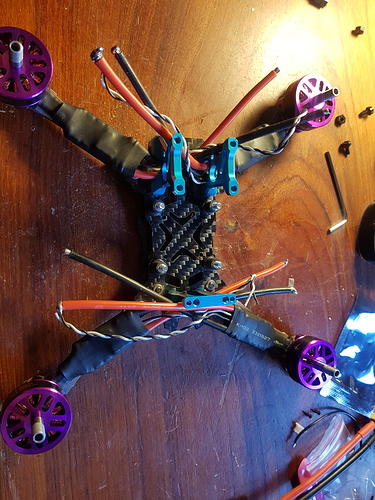

Having been reluctant to take my 3d printed drone out of its pram in case it gets hurt, I have, on the advice of @anon34183503, build a mini quad. Just waiting for the weather to stop pissin about so I can crash it. Should take a bump or two. It has titanium alloy arms and, as the box they came in states, ‘unbreakable props’ (Wow!.. hmmm…).
Yes, it could be a bit more neat, but great fun building.

Got a full build list? And where are the pictures!
Real6 frame
Kakute f7 aio
bn180 gps
Eachine tx805 vtx
Got a motor and esc bundle for £60 - 2450kv and 35Amp esc. Flame motor Trex esc.
UX14 RX (set to flysky. Its a dual rx. Will do frsky also).
Kingkong 5045 tri props
Foxeer predator micro v3 fpv cam (love the night mode)
12awg battery wires
Realacc Pagoda antenna
Solder
Flux. Lots of flux.
4s 1500mah batteries in the post!

Don’t know yet. Its 360g without the lipo though. I get the lipos on saturday.
Its a velcro strap that came with the frame. I need to sort that side of it out when the batteries come. Maybe print some sort of protection contraption. Unless I mod things a bit further, I’m limited to having the battery on the bottom.
I haven’t got a buzzer. Or Led’s…YET! Are the buzzers just piezo crystals? I have some lying around.
Oh. And I had to grind a little from the front ali standoffs. The kakute f7 barely squeezed it.
Jees. Its 540 grams with the battery. Little less solder?
Crumbs that’s a heavy quad! What do the arms weigh?
I know. Think I effed up. Not sure but the frame is about 98g. But I wanted a tank to learn. I’ll make do.
