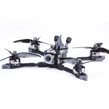

quads
If your looking for a prebuilt https://www.banggood.com/IFlight-Nazgul5-227mm-4S-5-Inch-FPV-Racing-Drone-BNFPNP-SucceX-E-F4-Caddx-Ratel-Camera-45A-BLheli_S-ESC-2207-2750KV-Motor-p-1529741.html?ID=567244&cur_warehouse=ES £170
if your happy to lose an evening to a soldering iron
https://www.unmannedtechshop.co.uk/product/thefpv-source-fpv-quadcopter-kit/ less than £170 (sells out as quickly as it comes into stock)

There’s a reason that’s so cheep. Poor quality parts. Fragile frame… wouldn’t recommend that for a beginner. You want something tough that will take an utter beating!
