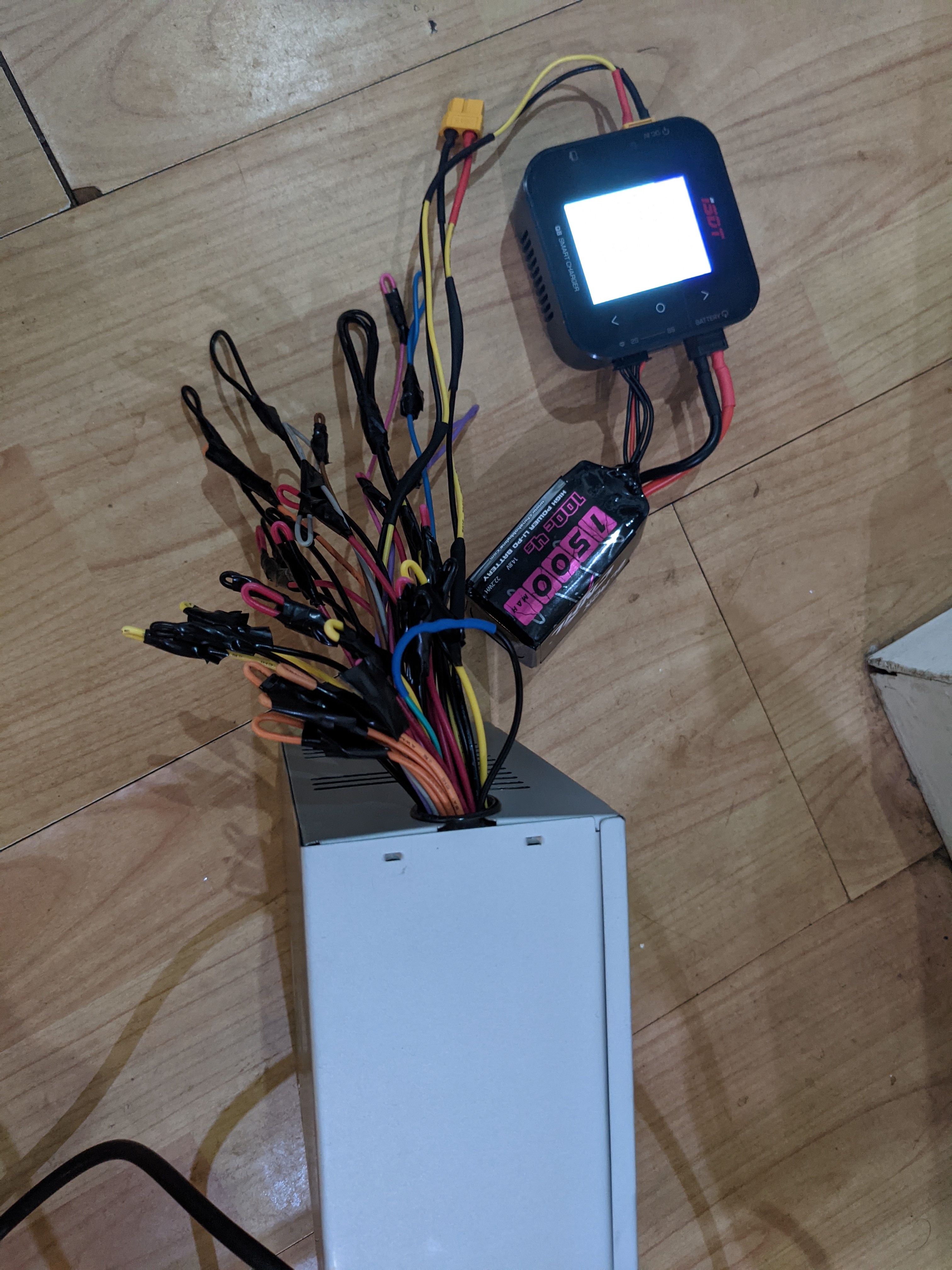

And we’re almost there. Camera VTX and buzzer connected and working… My q8 charging the batteries properly thanks to work for a PSU! Boom!
Nice job! This thread can hopefully help others in building an fpv quad. Once you’ve built one, the next is easy.
Thanks Karl. And thanks fro all your and others help!
