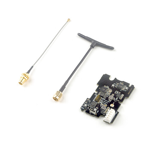

In other news unmanned tech have accepted a return for the Nano TX Module and I’ve ordered the right one, hopefully with me tomorrow…

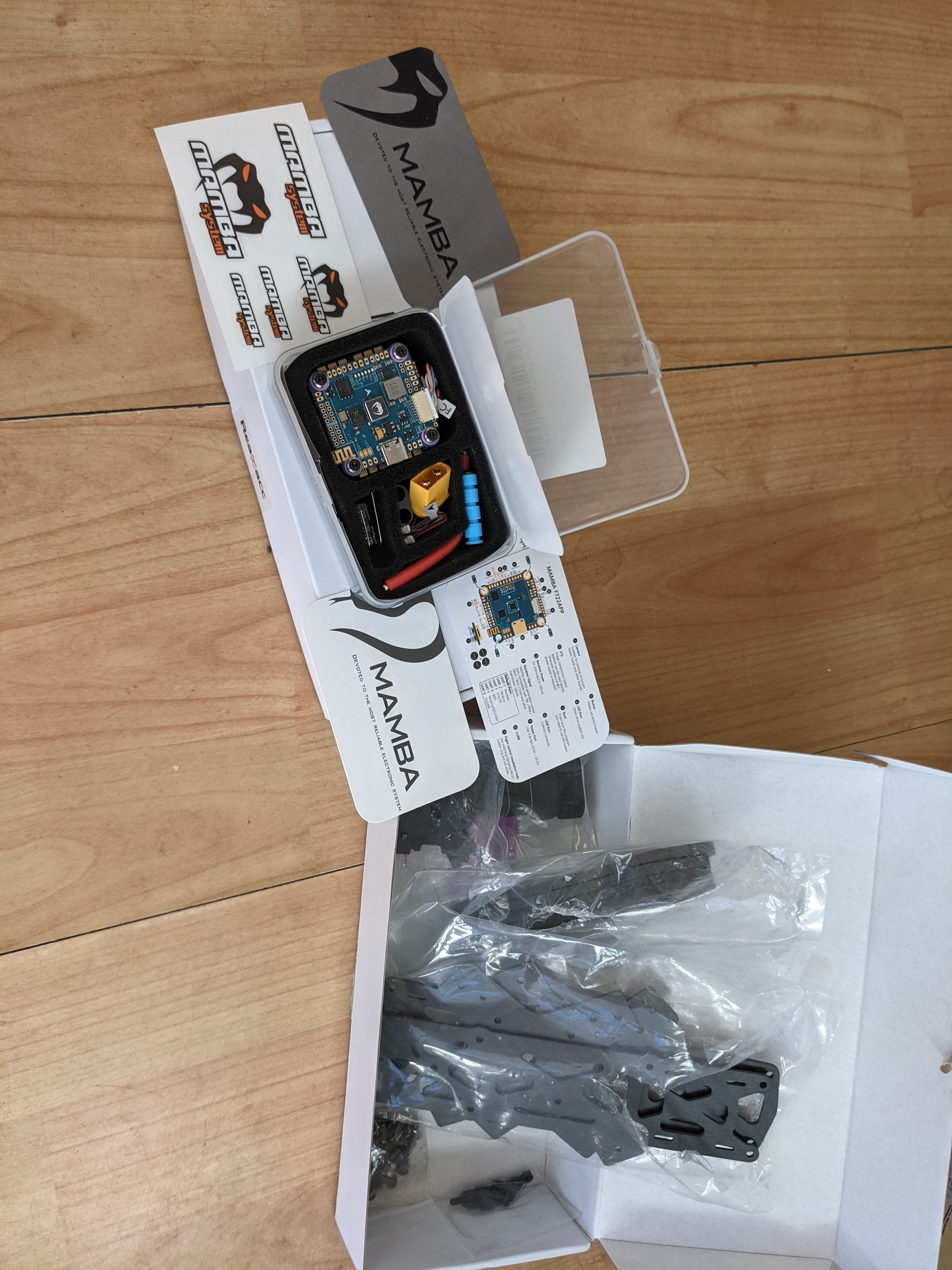

Haha well guys I did secretly divert it this AM to local convenience store, thanks premiere and just got it. 2 frames FC and 4in1 ESC turned up…
Now what… Lol

Plug the fc in via usb into betaflight to make sure it works before soldering. Else they may not refund you if its DOA
Was going to. Do I need to DC the ESC when doing that as it’s a combo stack?
Doesn’t really matter. The esc needs a lipo voltage anyway
