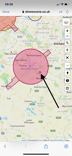

Just bought a DJI Mavic Pro 3 for real estate photography. I have a couple of questions about airspace.
  1. I want to fly my drone in Alderley Edge, near Manchester. Can you see any restrictions flying in this area?
  2. Alderly Edge is located just outside the restricted zone for manchester airport, however, the DJI overlay indicates that it’s in class D airspace, is this an issue as I believe it extends from the ground up, and not from a designated altitude?
  3. What lateral distance should you keep from a prison? HMS Styal is located in the red zone of Manchester, not sure how far away I should keep.
    Many Thanks.

Alderly Edge if fine to fly in, it’s outside Manchesters FRZ
Class D airspace doesn’t affect drone operation
You will get a warning in the fly app, I do as well in Altrincham :scream: just ignore it as it’s not relevant
And Style Prison is inside the FRZ, you won’t be able to go anywhere near it without permission and a unlock from DJI
Just a note, if the prison wasn’t in the FRZ of Manchester airport you would be able to fly up to but not with it’s FRZ
You are legally allowed up to a FRZ without any authorization

Thanks for the response guys. Last thing I want is to get into trouble with the CAA. For some reason I thought you could not fly within 5km for a prison. Is it possible to fly in restricted zones with permission, not prisons, CTZ and other restricted airspace?

Yes - it is possible to fly anywhere as long as you have the correct permissions.
Whoever looks after that area can give you written permission, which you then upload to DJI to get the drone unlocked.
Many of us have done it at various locations. Can’t speak however for Manchester Airport. That might be somewhat harder than a rural location.

I’m not convinced there’s any restriction on flying a drone over Styal Prison. The various Restriction of Flying (Prisons) Regulations seem to only restrict helicopters.
If anyone knows otherwise and can point to an actual regulation, I’m interested.
CAA
If there’s a restriction then no but I can’t find any specific reference either. This site claims there is but I’ve followed some, not all, of their links and none have taken me to a definitive source.
https://skykam.co.uk/can-you-fly-a-drone-over-a-prison-uk/#:~:text=Obtain%20Permission%3A%20If%20you%20are,as%20the%20prison%20authorities%20themselves.
