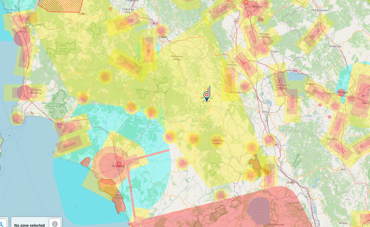

D-Flight restrictions - Italy
Am I reading this correctly?
I am going to San Quirico D’Orcia, Tuscany in May. marked by the red & blue D map pin. It is in the centre of a huge area shaded yellow which I understand has an altitude restriction of 45 metres.
There are also a number of helipads and minor airports with no flying, I am not concerned about those as I wouldn’t want to be flying in those areas
