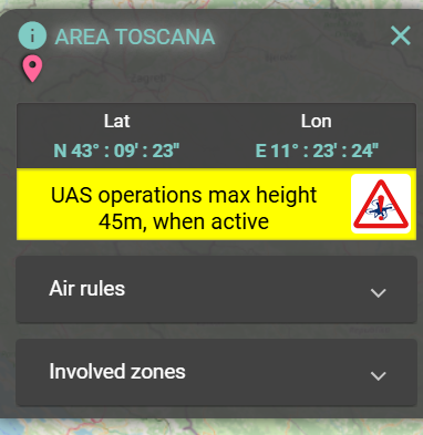

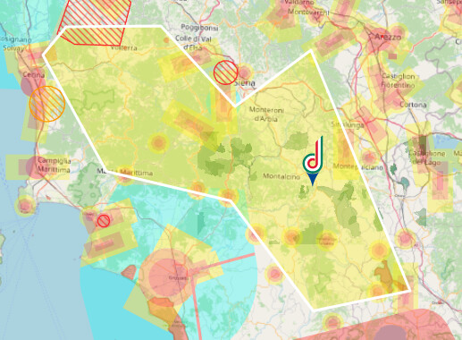

OK, we move onwards ( and hopefully upwards !). Here is a copy of the Tuscany region D-Flight map. I will be based in San Quirico D’Orcia, marked with the D-Flight pin.
There is a vast yellow zone labelled ā€œArea Toscanaā€ stretching from Orvietto in the south to near Florence in the North, a distance of appx 100 miles, it’s about 40 miles wide.
The full text reads:
Within the geographic area, when active, UAS operations are prohibited above the indicated height. Any exceptions may be authorized by ENAC in accordance with the provisions in force contained in the ENAC ATM series circulars.
Pilots are required to pay attention to the dangerous nature of the activities taking place within these areas.
Low-altitude military activity in these areas is authorized as follows: - Monday to Friday, excluding holidays (see GEN 2.1); times: 06.00-22.00 (05.00-21.00), if the activity is carried out in the territory or within 3 NM from the coast line, or H24 outside 3 NM from the coast line.
Almost makes you feel good to be in England !
Can the Mini 4 Pro be set not to fly above 45 meters? Or better still to warn if you’ve reached that height or do I have to just watch the screen?
Safety > Max Altitude can be set as low as 15m
Remember that’s above take-off … not above the ground. The ground in Italy isn’t level most of the time. :wink:
