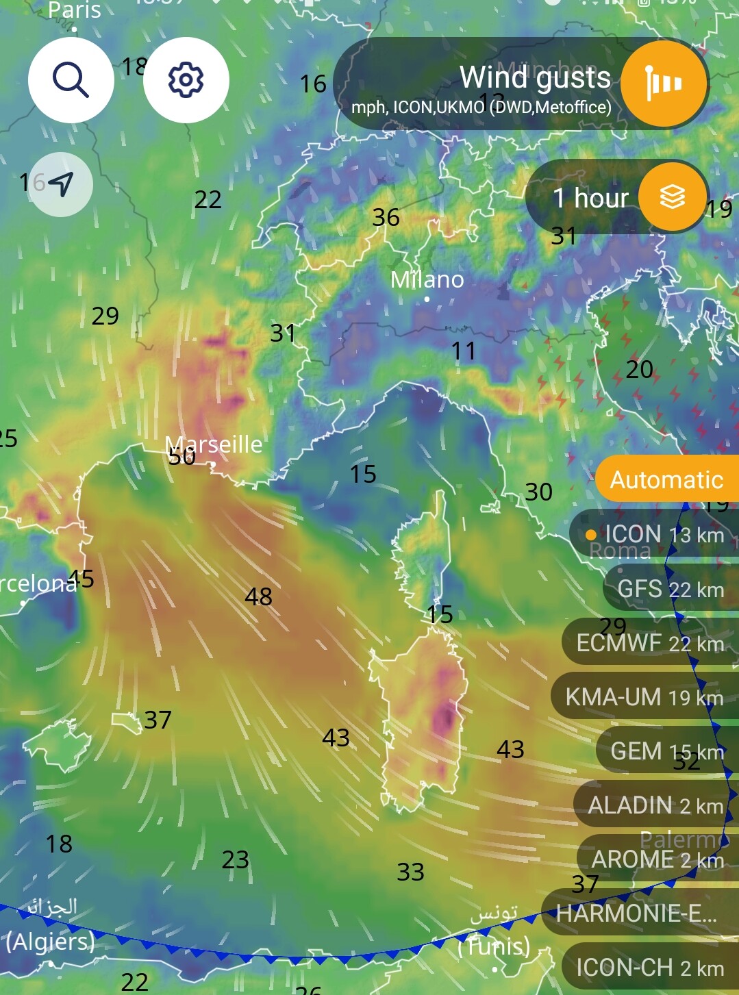

Im in Sardinia at the moment and have had some proper near misses where ive almost lost it. Basically due to wind. Theres been a pretty much permanent 45mph + wind/gust since weve been here and we are by the sea on a hill. This morning seemed calm so I flew it and as I was trying to return to me in full sport mode going forwards I watched the screen seeing it going back wards and blowing away from the house. Thought it was game over. Dont think im going to get the epic footage I planned, just feels so risky. It also seems to lose signal really quick too, 250metres ish. If i can get some basic stuff I will swap memory cards and do more with it, in preparation for it not coming back. I’m amazed how different it is flying in this environment and can see why so many are caught out.
This really has nothing specifically to do with Italy.
So you knew it was windy and you flew down wind initially .. so you had to fly into wind to fly it back?
The most common advice given, when it could be a tad windy, is ALWAYS fly into wind initially to test the conditions .. so that if it is too windy you’ll always be flying with the wind to get it back.
I didnt know it was especially windy. The hill I am on appeared fine, it wasnt till I launched that this all happened. Later on I went down to the beach and it was almost gale force. The wind picks upnl and dies down here randomly. Mistral winds they call it.
.. but ..
I think the first statement means it probably will be windy.
Check any app the last few days .. all have been showing the Mistral ..
