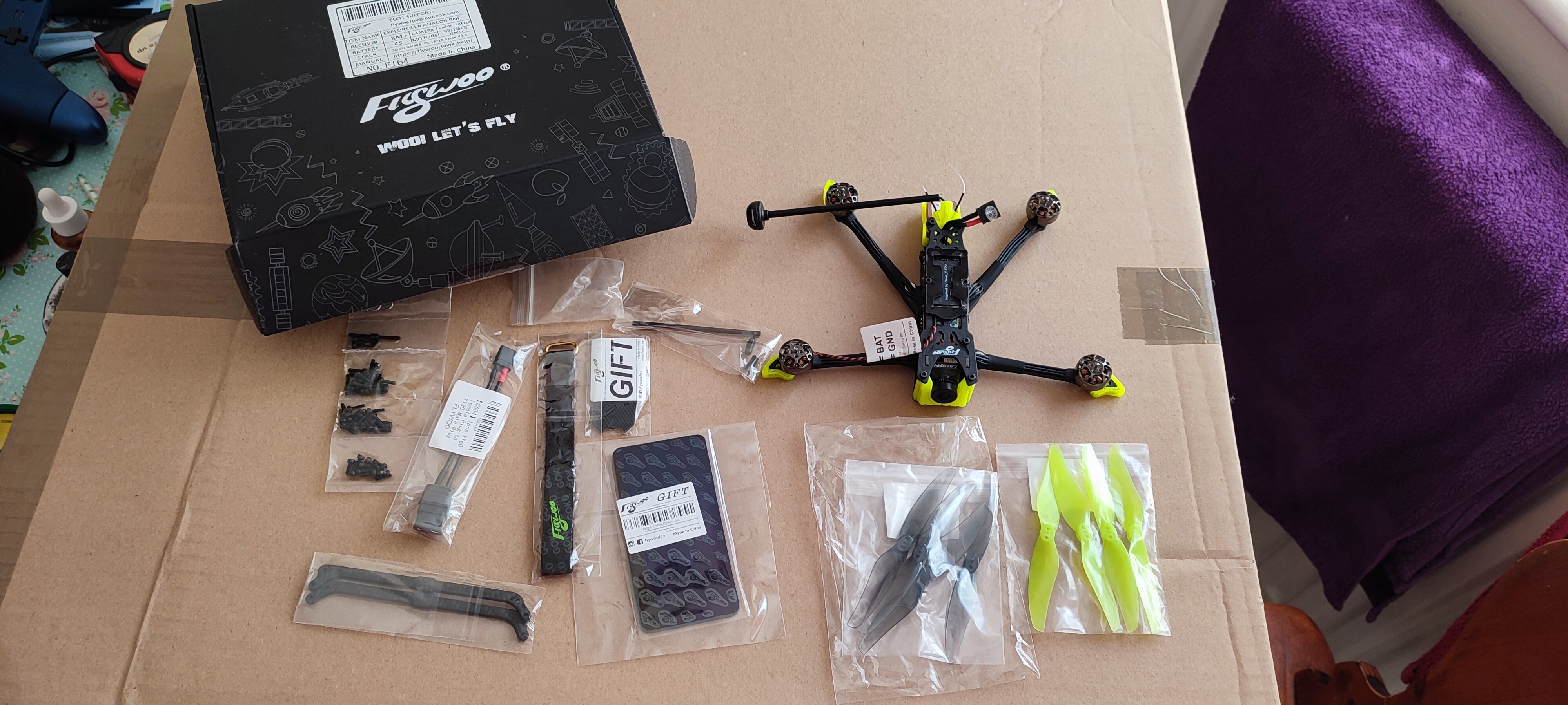

Heres the photos

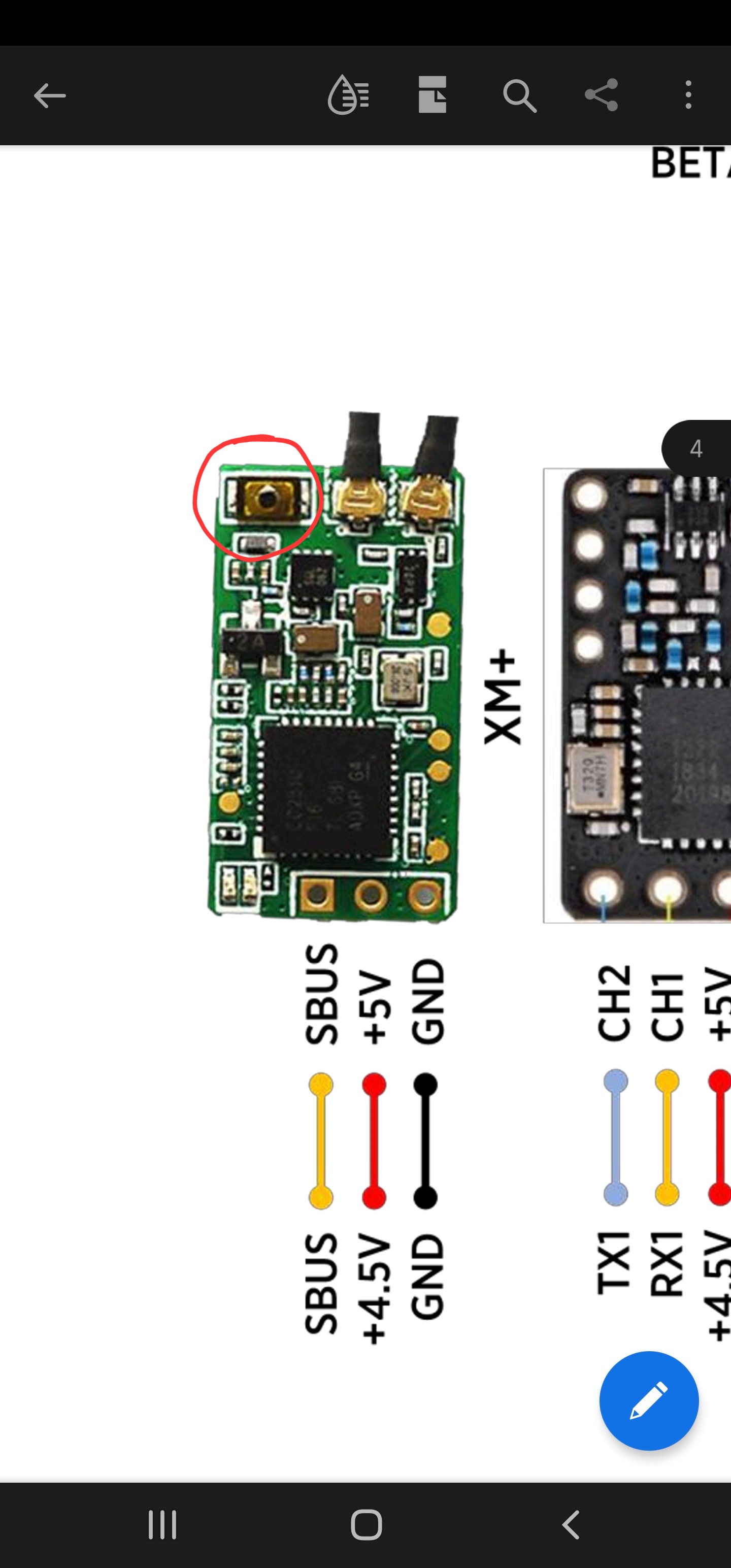

Heres the manual. Look at the binding section for XM+

I have already had a look of manual and I can’t figure it out as I am new to all this, I bought it thinking I would be able to try and work it out and I can’t. So any other help from someone would be welcome.
Cheers
Ok so have you tried the instructions from the manual or have you not tried as it was too complicated? Just trying to work out what you have done so far?

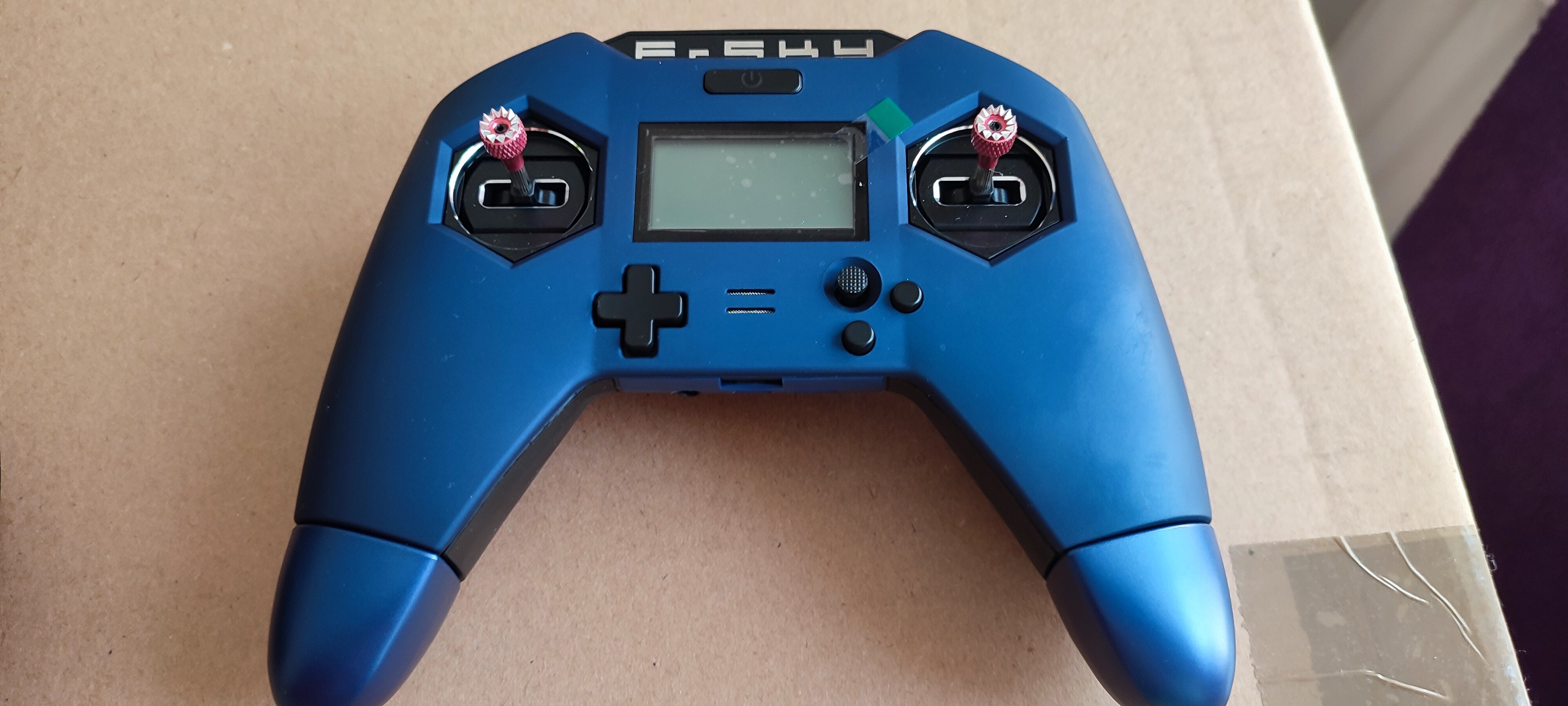

Ok, and just for clarity, I have tried to follow the instructions but get lost almost straight away as it’s in broken English and they say about pressing a button on the receiver but it looks to be tucked away inside the drone and as I am new I just don’t know what I am doing so haven’t tried to much in the way of being hands-on with moving parts around and in videos they all show like wires connected together and say you have to bind like that but as you can see from my pictures, I have no wires… So this is why I’m so lost
So spoke to flywoo who again didn’t make any real sence but they basically said its all ready to fly no need for betaflight or anything just bind and fly but I’m stuggling with just that and also navigating the menu and what exactly to do with the controller to get it to bind to the quad.
Ok so this is the bind button on the receiver that they are talking about. It might be difficult to get to but its mounted to the underside of the top plate on your quad. See if you can find the button
You need to go to the setup menus on your controller and set the options as below
When youre happy its set correctly you need to highlight the [Bnd] icon and press in the joystick to activate bind.
Then If you can get to the bind button hold it down as you plug in the usb cable. This should put the receiver in bind mode. After a few seconds you should get flashing green led on receiver. Then you can power off the quad and the controller and then power back up. There should be a solid green light on the receiver to confirm its bound
Ok that’s good to know, thank you for the clarity, so yes I know how to find what you are talking about so I will undo the bolts and then I can access it, then once I have done that what is my next steps?
