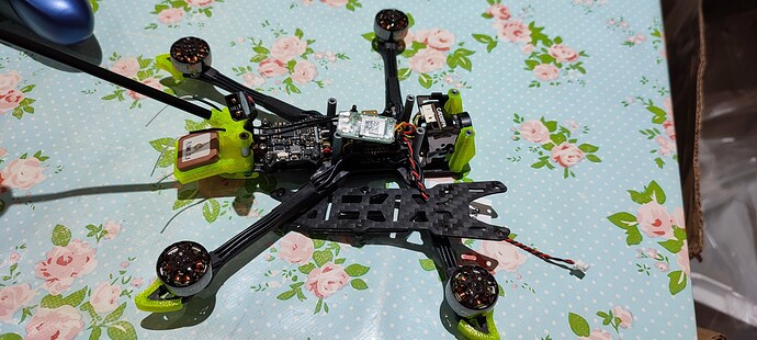

Here’s some pics and a video of my control settings to let me know if it was all right.

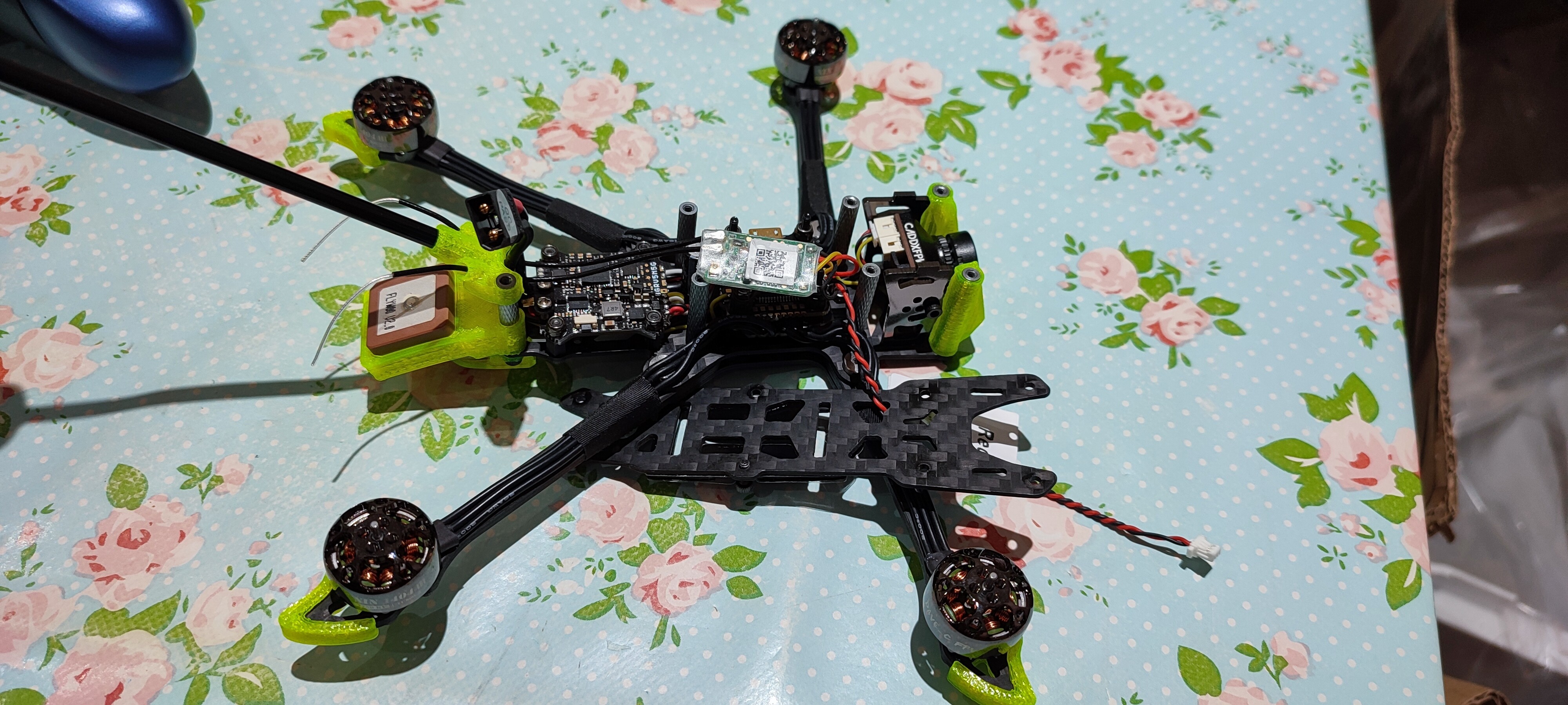

I tried this and couldn’t get it to work, no green light came on on the receiver either.
I’ll have another go tomorrow and let you guys know how I get on.
It won’t let me upload the video of my controller settings so can anyone give me any suggestions how to post videos and pictures in here easily as It doesn’t allow Google photo links which is how I tend to send things.

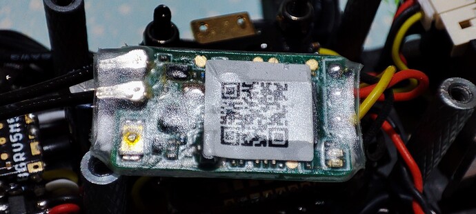

Below is another picture of the receiver which I have managed to find and get to.

In the video of your controller I didnt see you click on the [Bnd] option to start the binding process?
No sorry for not being clear I wasn’t videoing the whole process to show you it didn’t work, perhaps I should of. I just let you know I tried and it didn’t work and then showed you a picture of receiver and then a video of my control settings after I had tried just to see if you could tell me if they looked correct.

Hi Chis.
Do you know the firmware versions of the receiver and the controller? I’m not talking version numbers but rather region versions.
A bit of history.
Back in 2015(ish) FrSky started producing transmitters and receivers with what is known as “LBT” firmware for Europe. This was due to a change in European Legislation.
Most, not all, receivers sold in the EU carried this LBT firmware, but some of us, myself included, didn’t want to go through the hassle of updating our transmitters and receivers so we carried on buying Non-LBT receivers. Also, the majority of bind and fly quads with FrSky D16 receivers imported into the country were/are using Non-LBT receivers.
FrSky transmitters sold in Europe and the UK after 2015 are using LBT firmware.
Anyway, assuming both your receiver and transmitter are compatible, the bind process is simple but you will feel you need three hands to do it.
If you can power the receiver by connecting a USB lead into the quad it is both easier and a lot safer than using a flight battery. If you have a USB powerbank then it gets even easier.
Step 1: Hold down the bind button on the receiver, then provide power via USB. The receiver LED should start flashing.
Step 2: On your transmitter go into your model setup menu and scroll down to the bind option. You need to select D16 protocol for the XM+ receiver. Then you click the bind option.
If all goes to plan your transmitter will start beeping and shortly afterward the LED on the receiver will go solid green.
If the LED does not go Solid Green then chances are the transmitter and receiver are not running the same firmware region, and they ne or the other will need to be reflashed.

Hi Nidge I did exactly what I believe I need to be doing with the - holding button on receiver - setting up the control to what I think people mean (but I’m not sure if I have this right or not, videos provided show the firmware and software on the controller) then plugging in the drone (I used the battery). - turning off the drone and the controller and starting them back up again.
I done all of the above in the order I believe is how people have explained but still doesn’t seem to bind.
I have tried to upload videos here but I can’t get it to work so if you or anyone would like to see them could they provide me an email address to send them to as I am struggling to get them to upload on here.
I have made good clear videos of everything I have and the firmware in the remote, it does also have options for what looks like ghost down as “ghst” and what looks like crossfire, down as “crsf” not sure if this is what you guys are talking about and if it means I can select one of those options and this whole thing be a lot easier or not? I also showed all the relevant process I believe I needed to do in terms or binding so maybe people could let me know I’m doing that right as well
