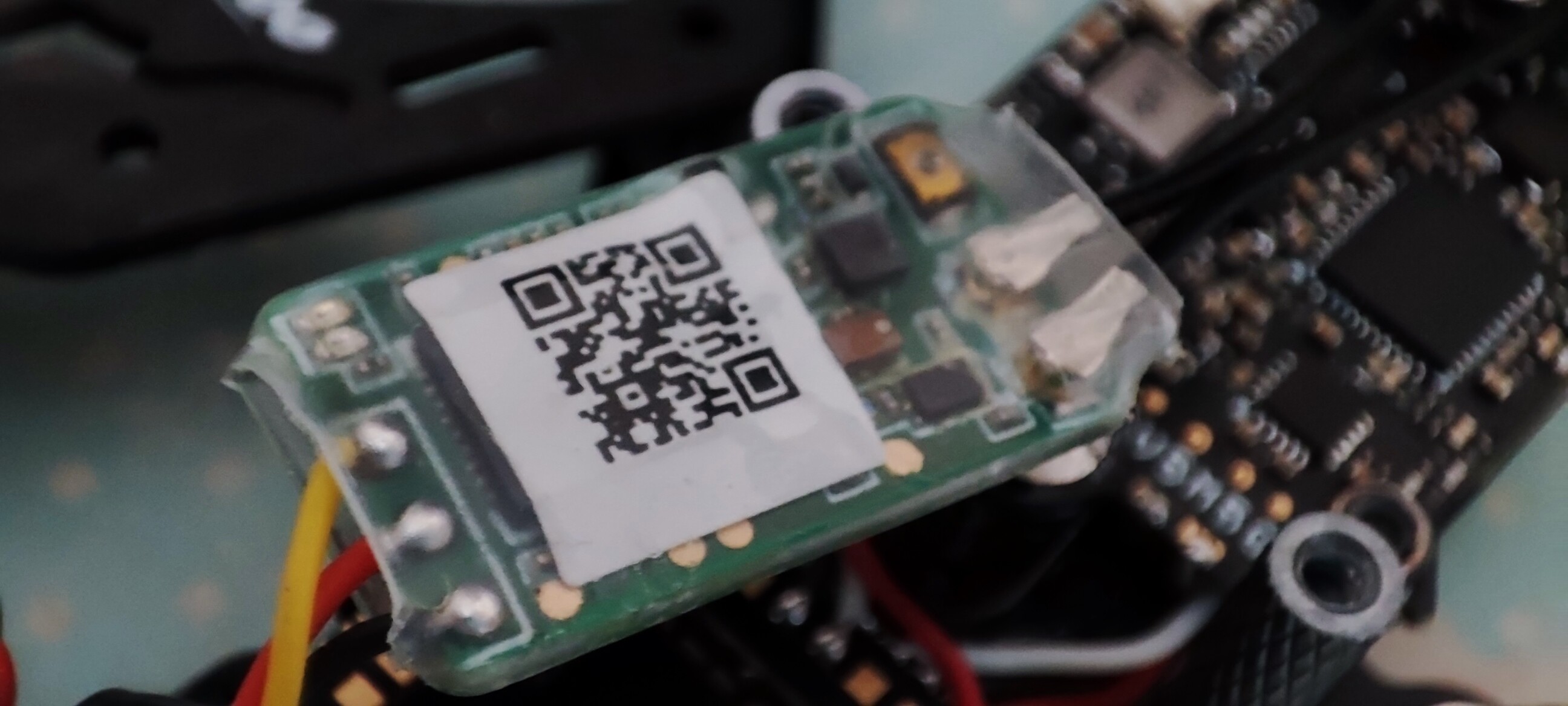

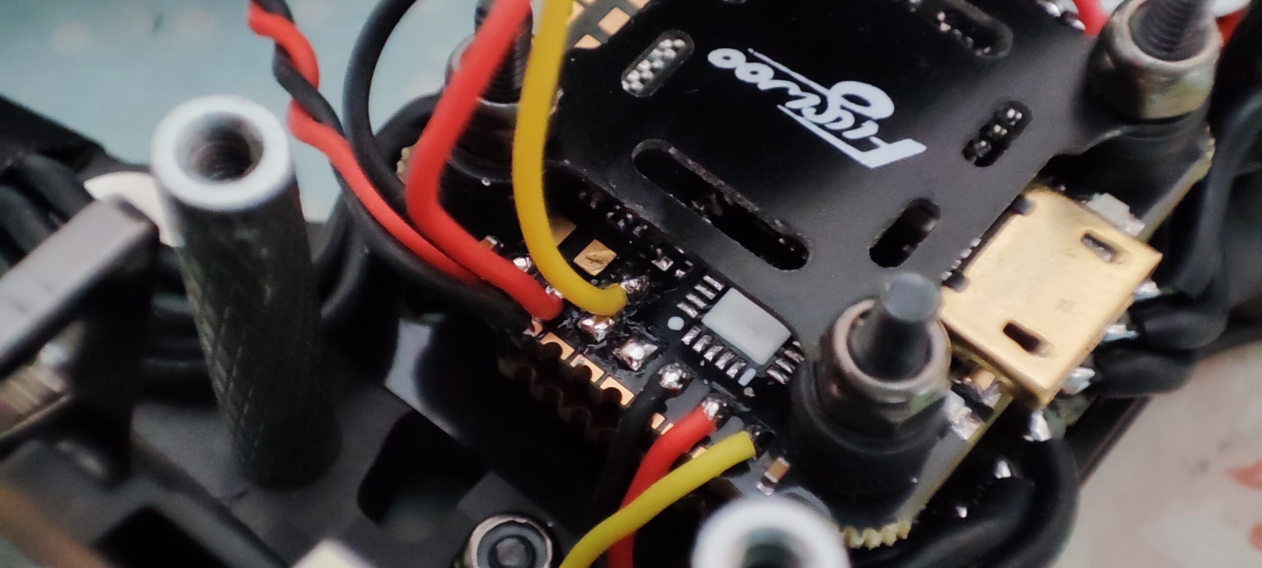

Hi guys hope your all doing ok, I have spoke to the guy at hobbyrc and he says its likely it could be a firmware issue as he says my radio will be accst V2 EU/LBT and my flywoo is likely to be FCC on either or the other accst versions… I think this is correct.
He also said that if I can get my receiver out/disconnected from the drone then I could send it to him and he can reflash for me with the correct firmware. However he did say this would be easy in theory if the wires aren’t soldered but typically nine are soldered. So my next question is, I have also found a guy who does mobile repairs and has a soldering station, he says he able to possibly solder for me but is it likely he could desolder my receiver from my starch so that I can send it to hobbyrc to get reflashed and then when I get it back I can get the mobile repair guy to solder it back together? And hopefully then I should have more success binding.
Does all of the above sound correct and what I need to do and do you think it will be possibly most importantly?
Pictures below show the solder points for my receiver.
Look forward to your opinions. Cheers

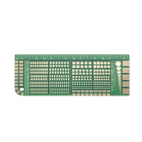

My honest opinion is that if you stick with fpv quads you will have to learn soldering anyway. Desoldering wires is one of the easier things to do (take photos so you know which wire goes where). My suggestion would be to buy a soldering iron with stand, solder (not the lead free crap) and a flux pen. Desolder the 3 wires to your receiver and send it in to HobbyRC to be reflashed. Get yourself a soldering practice board and while your receiver is away being flashed practice soldering on the practice board. By the time you get your receiver back from HobbyRC you should be able to solder back on your receiver ready to bind.
I have an unused practice board somewhere that I can send you if you like? Ive probably got some TBS solder I can send you too which means you would only need to get a soldering iron with stand and a flux pen.
Thanks for your reply @SirGunner i definitely will be getting myself soldering gear so thank you for your offer but like you say I will need to learn and buy these bits so I don’t mind buying those bits thank you for the list of what I will be needing. I mean if you have things spare and it saves it going to waste your end and your happy to post it to me I would appreciate that for sure!

PS: I know it’s all in heat shrink, but the best option for disconnecting your receiver is probably to desolder the wires at the receiver end (top picture), rather than the flight controller.
