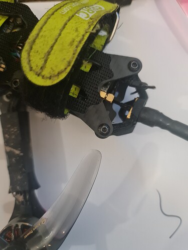

Great idea for a thread Karl :+1:t2: Just a quick question mate. Why can’t you use 51xx props? I’ve been using 5150 props on mine with no issues so far.

I found that my 51xx props hit the rear standoffs. Is your frame the exact copy of my apex copy?

Looking at mine against yours they look identical but they might be slightly different copies of the Apex. I think there are a few different copies available. Which 51xx props are you using Karl?

Are they pressed tight enough into the carbon? on my new frame I had to use a really strong press at work to get mine in
It’s literally 1mm
I think so. They looked flush. Knowing me, they wont be :grin:
Hmmm. Some of my 51xx props fit, others don’t.

Thats a bit weird, alot of my props are 51xx and I have loads of excess space. I’ll take a pic and post it soon

Here’s some of my 51xx props on the Apex HD copy
Azure Power 5148
Dalprop Spitfire 5148.5
Azure Power 5148
HQProp 5151
Hurricane 51499
I’ve just taken another look at your frame and there are some minor differences. Mine looks to be a slimmed down cheaper version.
Although your frame will take 51xx props, as illustrated via your uploaded images, I believe my frame is far superior and will be more supreme in flight. Sorry mate. That’s the way the cookie crumbles :laughing:
