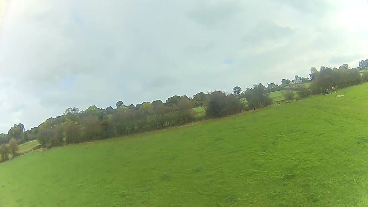

My entry.
Only a few practice runs before this. A little wobble at the end. But I’m not unhappy with it.
3" Armattan Gecko.
Still practising, gotta say these polar cam are great its was really dark when I did this…

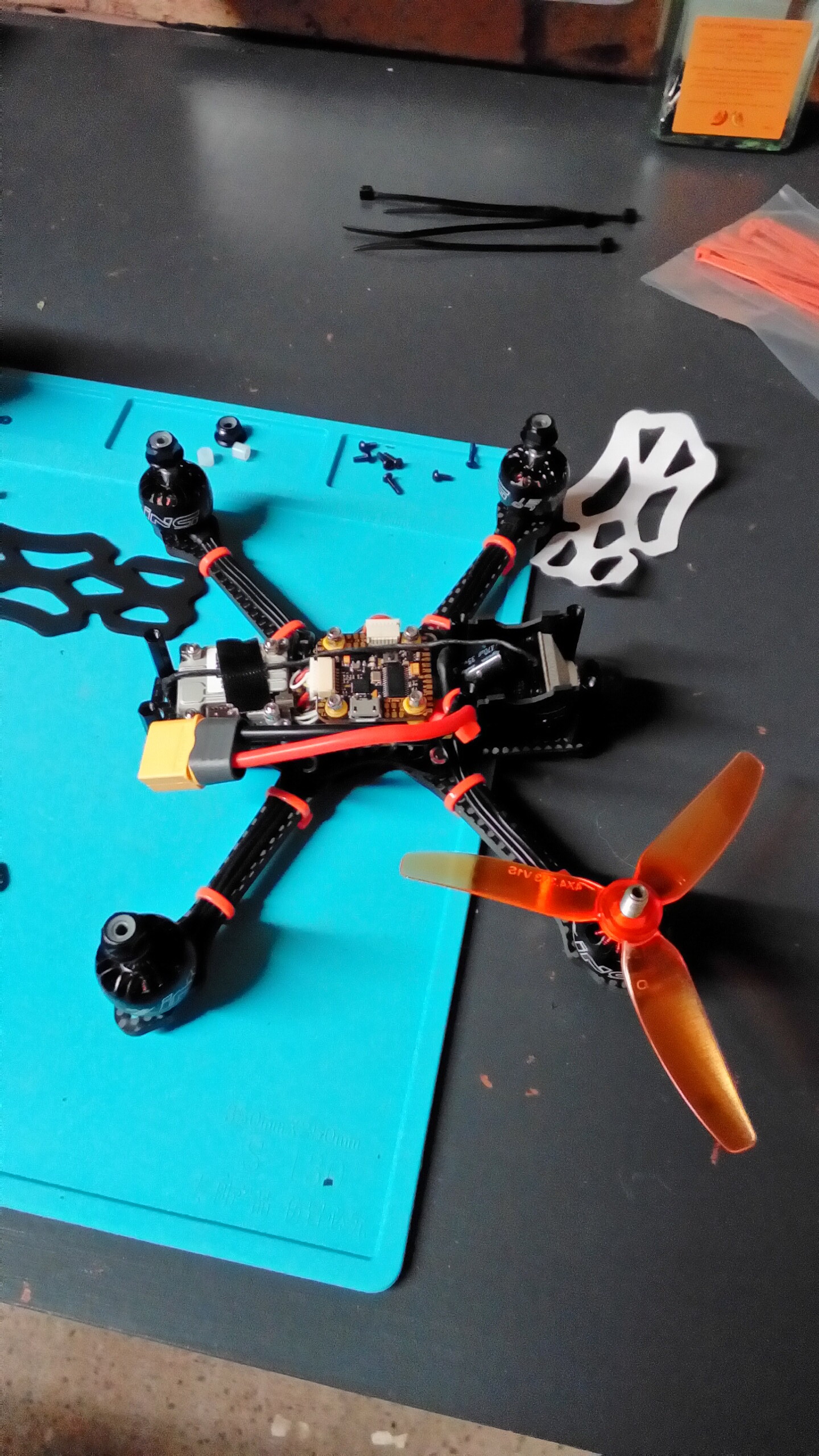

Still on the bench mate, not far off now …

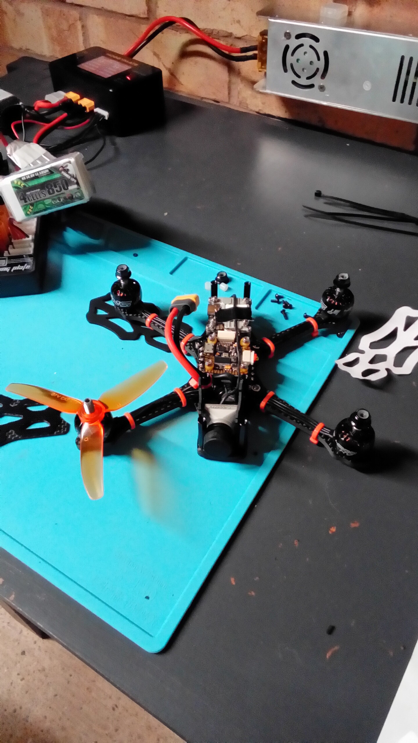

Just a visual on the build just waiting on a few bits to finish it. I have got 1 issue, the pig tail is far to long so need to have a think about the best way forward 🤷
