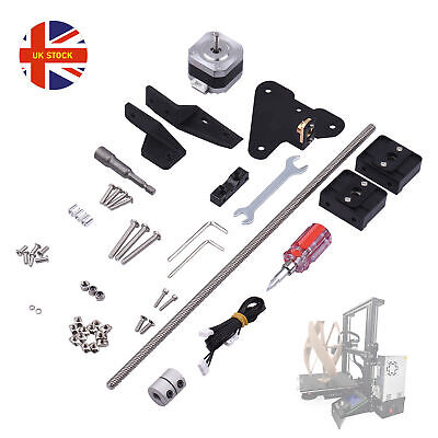

I cured my non sticking buy purchasing a creality CR Touch works wonders and a Aluminum Dual Z Axis Screw Rod Upgrade Kit for my ender 3 pro … ive printed a few objects and they have turned out near on perfect, best prints since I purchased the ender 3… :+1:
Also I have printed a power supply case and move to the rear under the bed … which works well…
