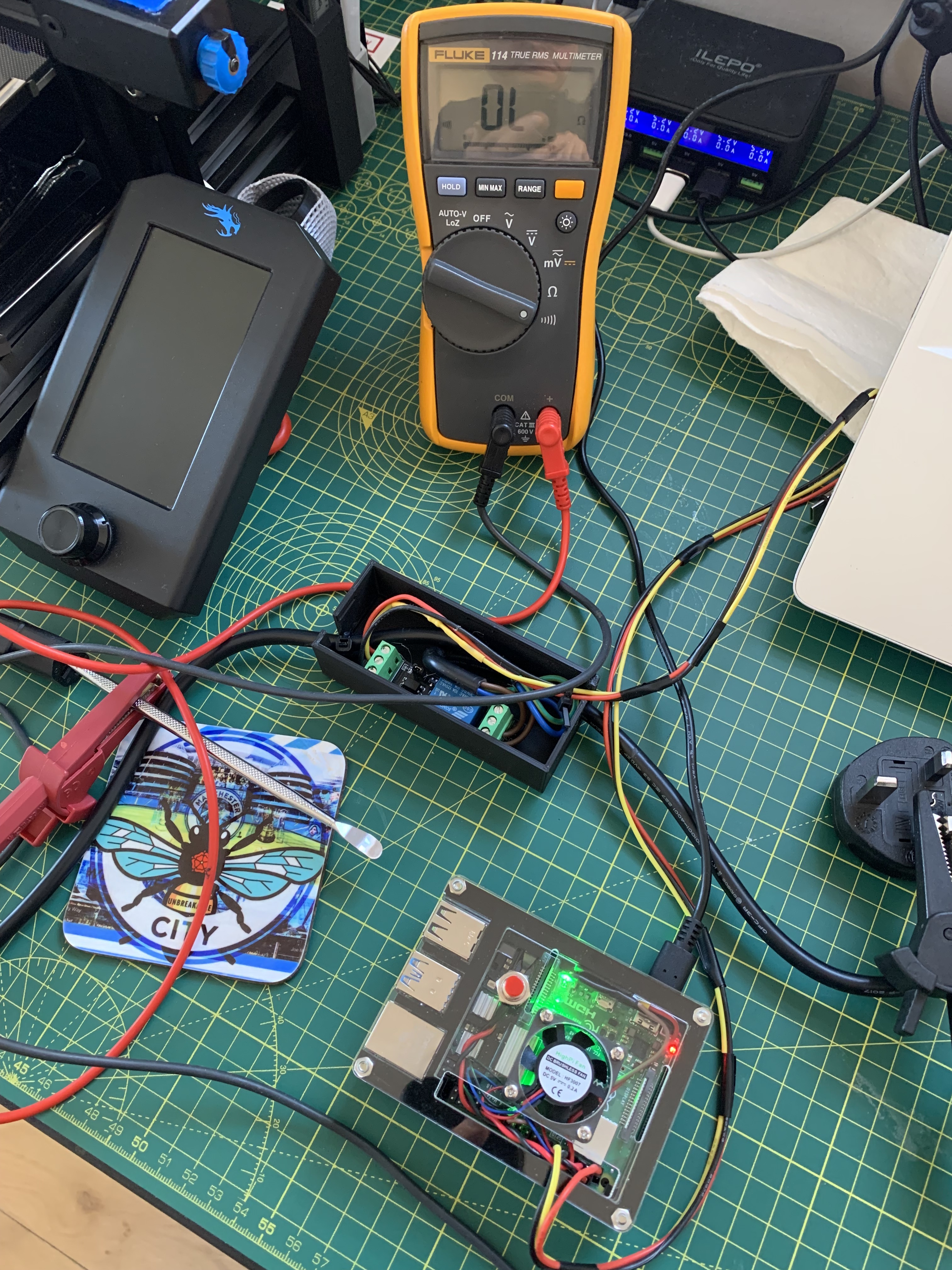

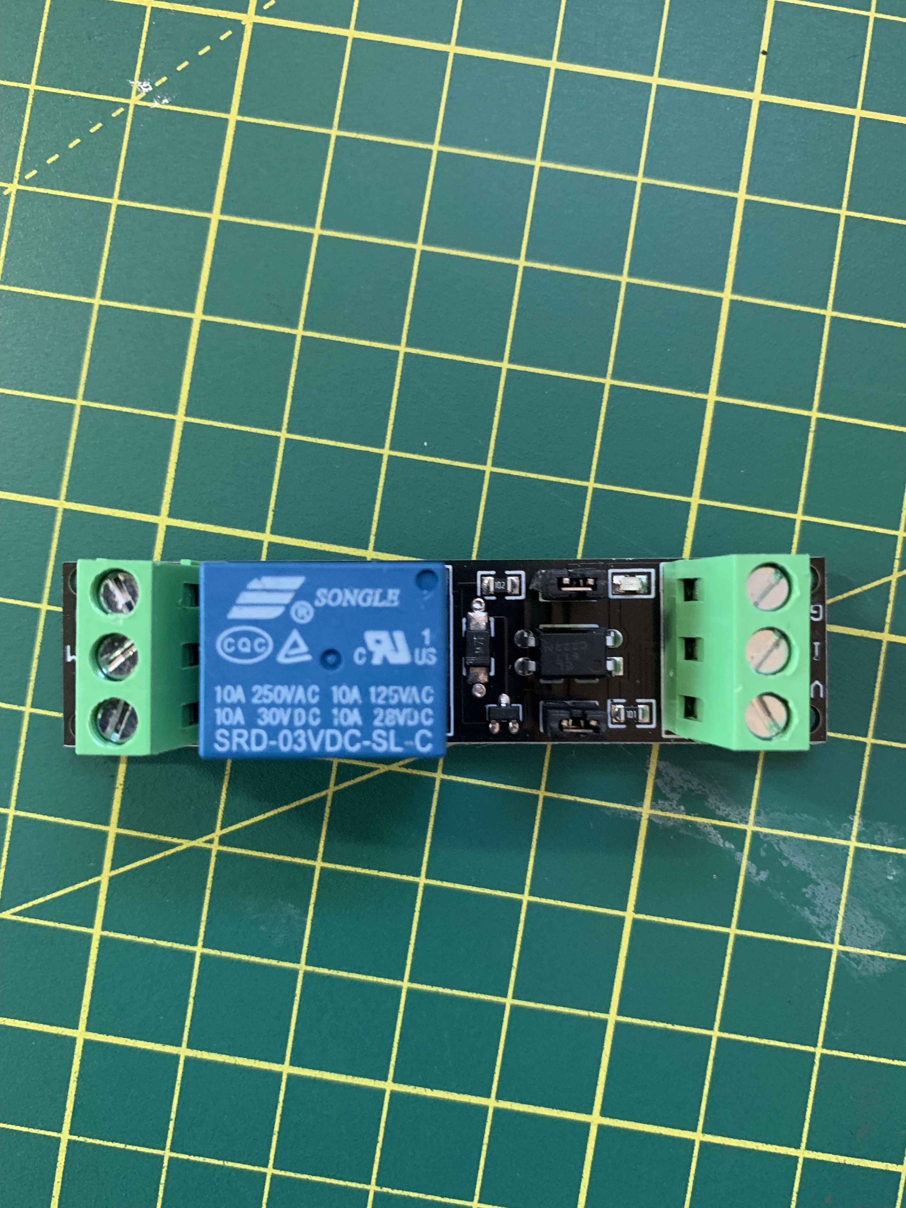

Finished the mod and I can now fully control the printer from anywhere with my phone
This is the relay being tested before connecting the 240v supply
It now installed in its own 3d printed box behind the printer
One note is the Raspberry Pi will not control a 5v relay as the GPIO pins are not 5v tolerant so make sure the relay is 3.3v and with Octocoupler. As an extra caution, I installed a 330 Ohm resistor in the trigger line

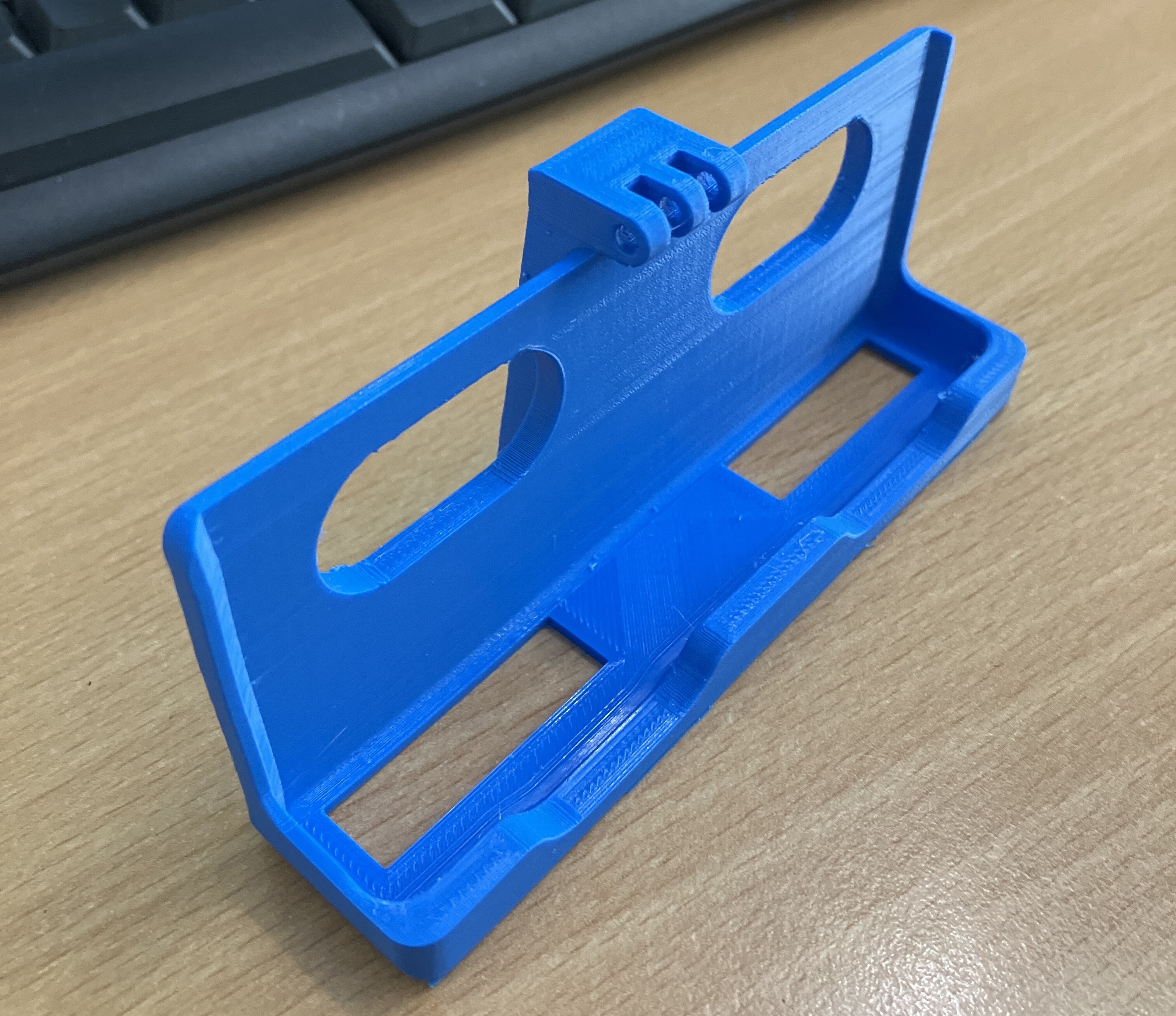

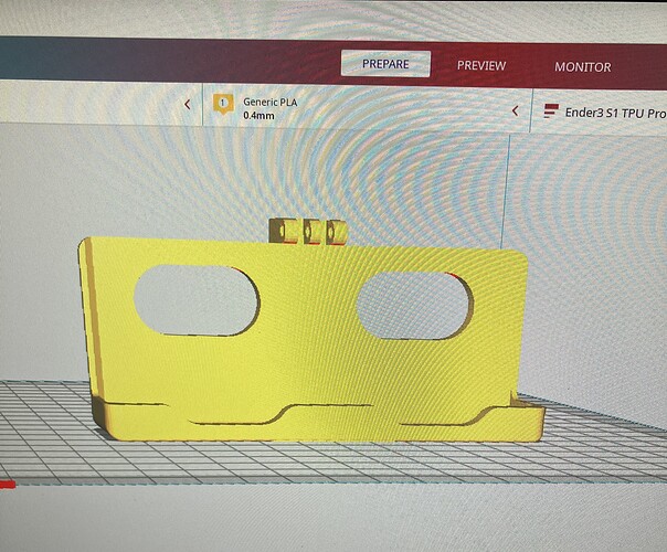

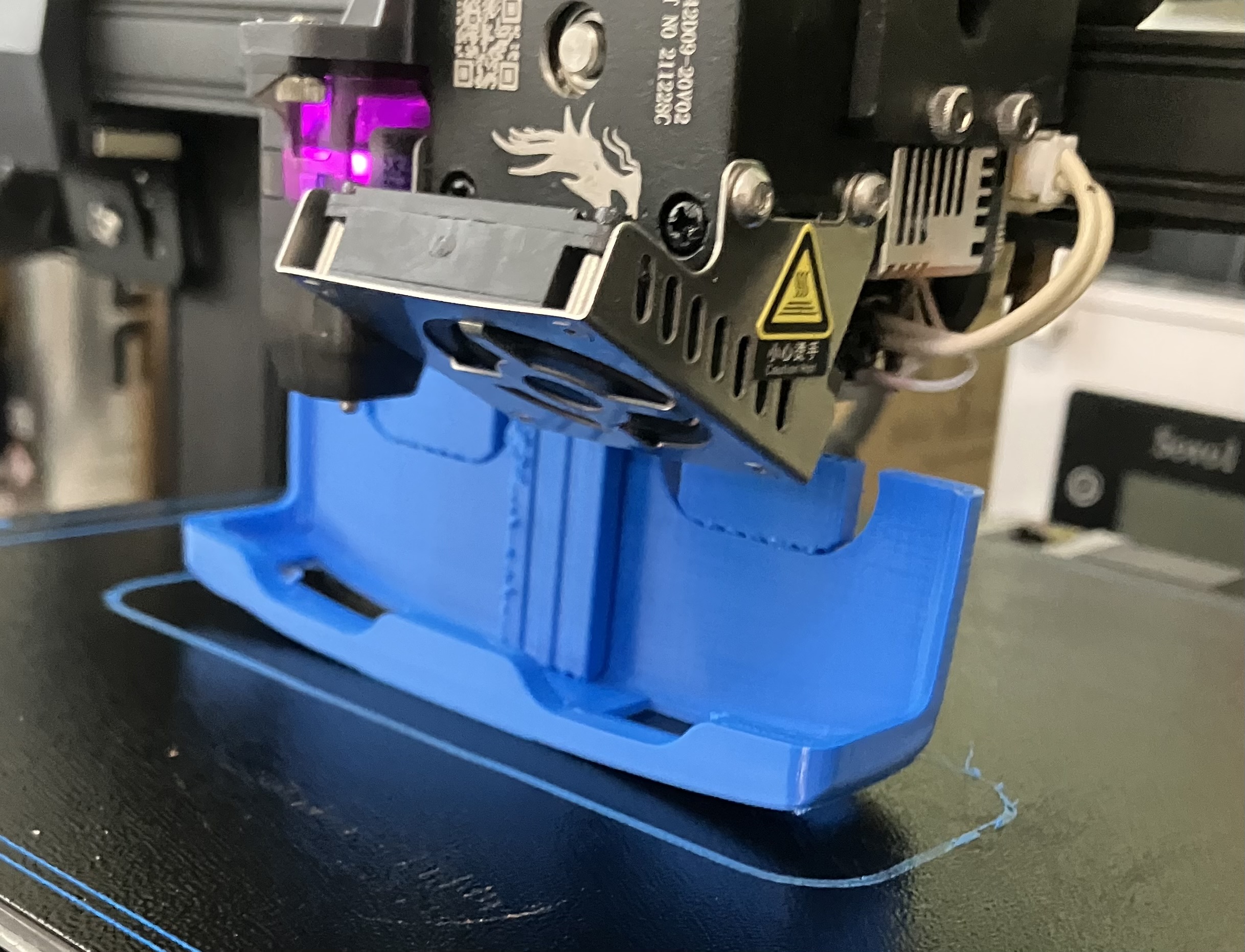

This part should have a flat base, but after a few hours into the print job (14 hours+) it starts to lift from the bed. The quality of my TPU prints is quite good so I was thinking my setttings were good.
Any ideas please? is it bed temperature? is it bed adhesion? should I use a raft?
I had that for a while, tried bed temps, extruder temps, bed was aligned, tried altering the Z offset +/- reduced it but not completely on big prints. I cured it with a brim. I tried rafts but sometimes removing the part from the raft was a pain. I now use a brim and this is working so far. I increase the brim line count for large dense base prints.
Up the bed temperature to 60
yeah as suggested bed temp 60 and use a large brim. for extra info on this search the net for 3d print warping its a very common issue.
what material are you printing with? try the same print with a different roll of filament as well to rule out damp filament :+1:t2:

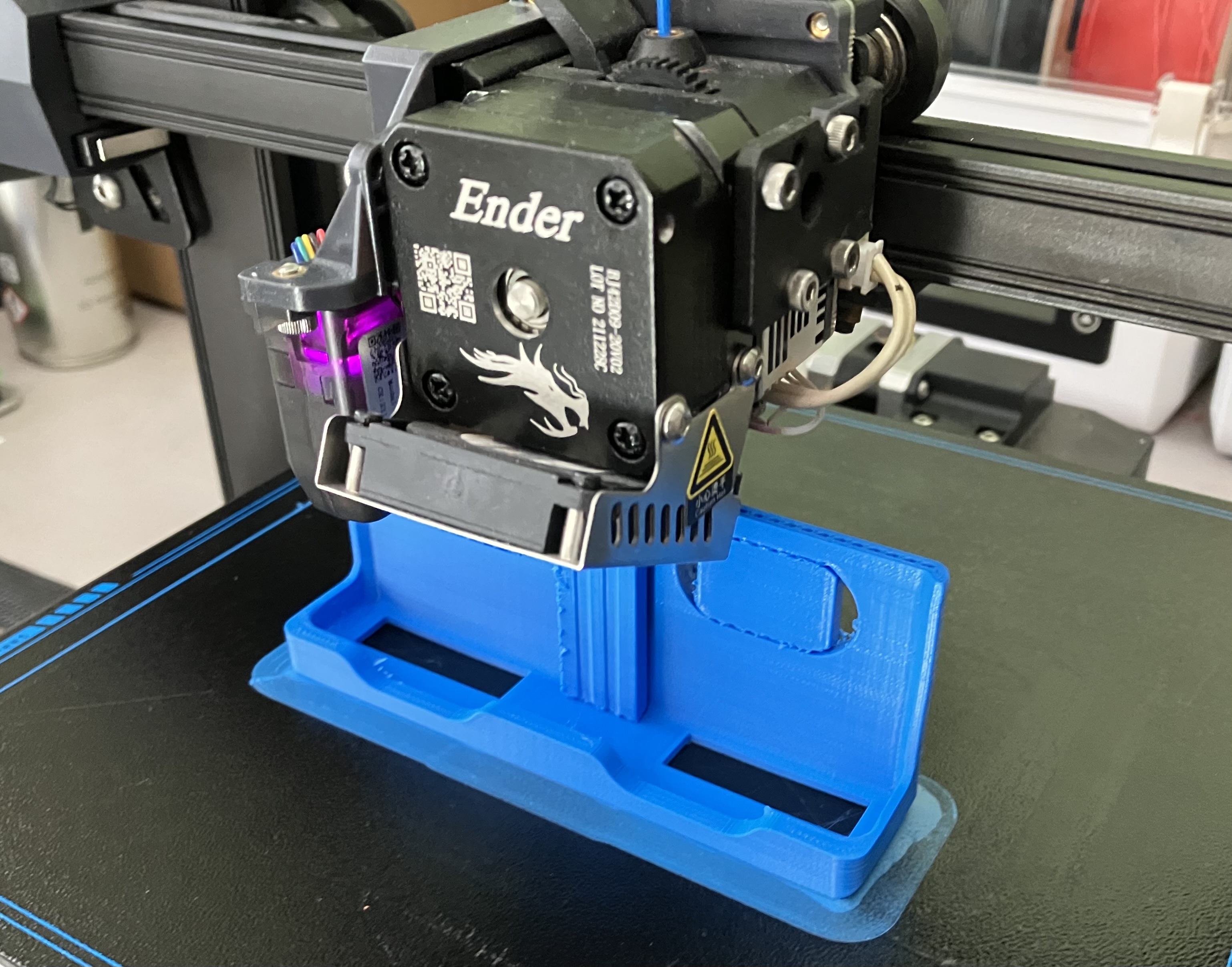

I’ve started a new print, bed at 60deg, added a Brim
I’ll let you know how it turns out tomorrow morning :+1:
The filament is 3DJAKE TPU A95, It’s fairly new and kept in a heated storage case, so I don’t think it’s moisture, other stuff printed with it have been OK
I don’t think my new bed sheet helps, in some respects it’s brilliant but it is a bit smooth/glossy.
https://www.amazon.co.uk/gp/product/B088841XH9/ref=ppx_yo_dt_b_search_asin_title?ie=UTF8&psc=1

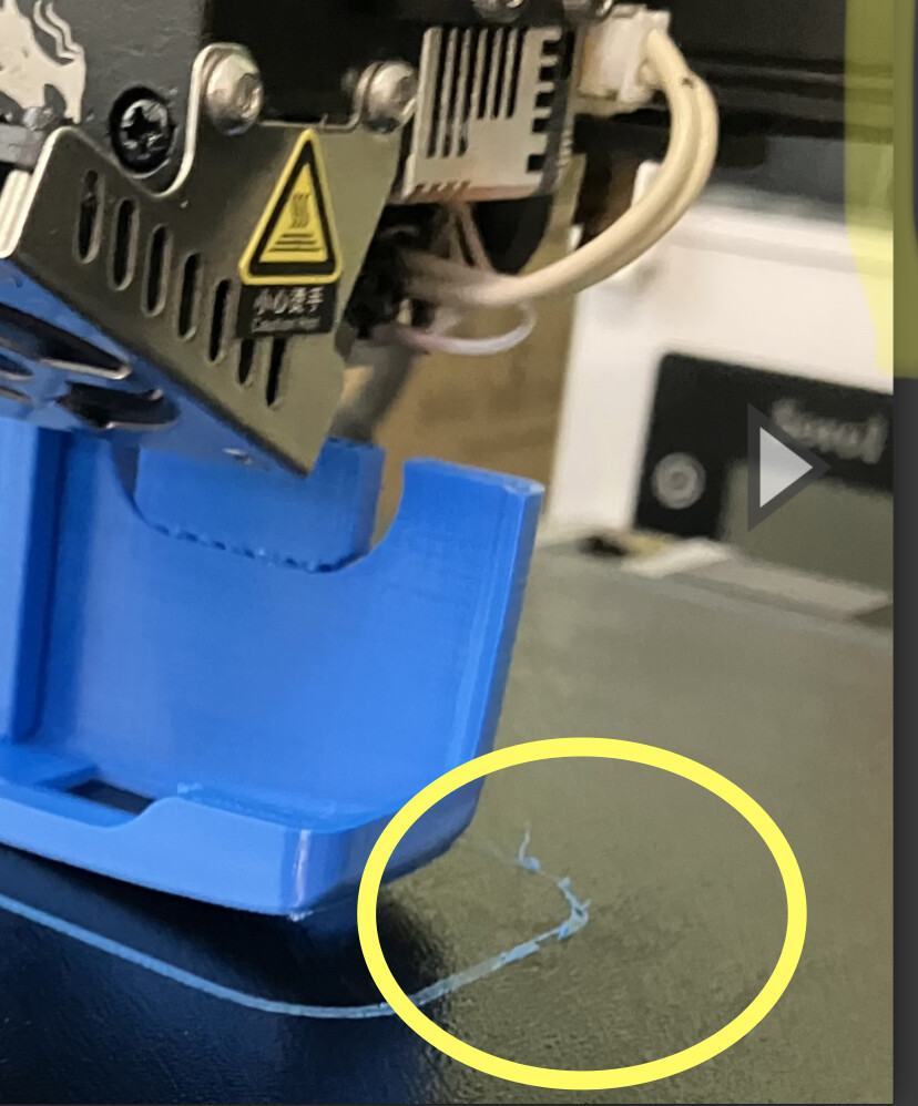

Looking better now but it does look if brim tried to lift in right back corner
It’ll be finished soon so I’ll share finished product
Steve,
I did notice in the first picture that it looks like the bed is not perfectly level or UBL is not working correctly
Hi Wayne
I did a BL level a couple of weeks and it improved problems I had then, I did a large print occuping most of the bed and the skirt was nicely put down
But I agree with you, that bit looks poor :slightly_frowning_face:
I’ll make a note of the levels then run BL again and see if anything changes
Cheers
Steve :slightly_smiling_face:

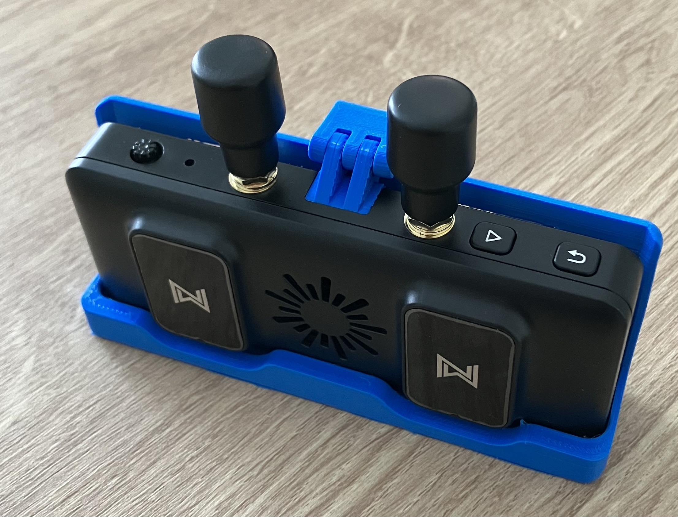

Turned out good :+1:
The brim came off easy as well
Thanks guys :clap::grinning:
