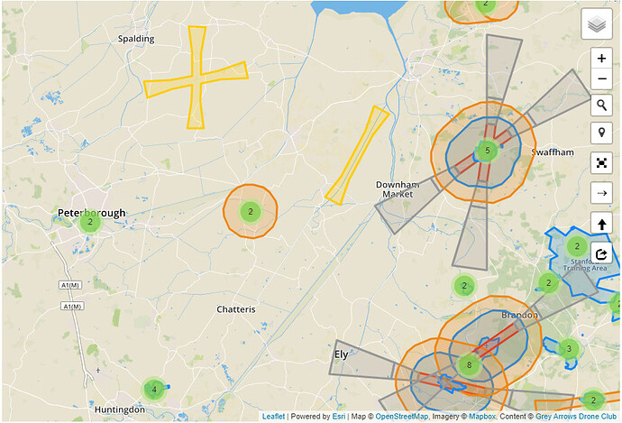

Look at DroneScene - switch all layers off except the FRZ layer and then toggle the DJI Geofence layer on and off to see how much space DJI restricts us from using compared to what we can use.
eg - from a randomly chosen area …
FRZs …
DJI Geofence overlaying FRZs
DJI Geofence only
A simplification, obviously, but it demonstrates the fundamental differences.
And, perhaps more importantly, there are plenty of FRZs that don’t have a counterpart in the DJI data (I spy several in that area alone), which means people can think DJI is protecting them from committing an offence … but they aren’t.

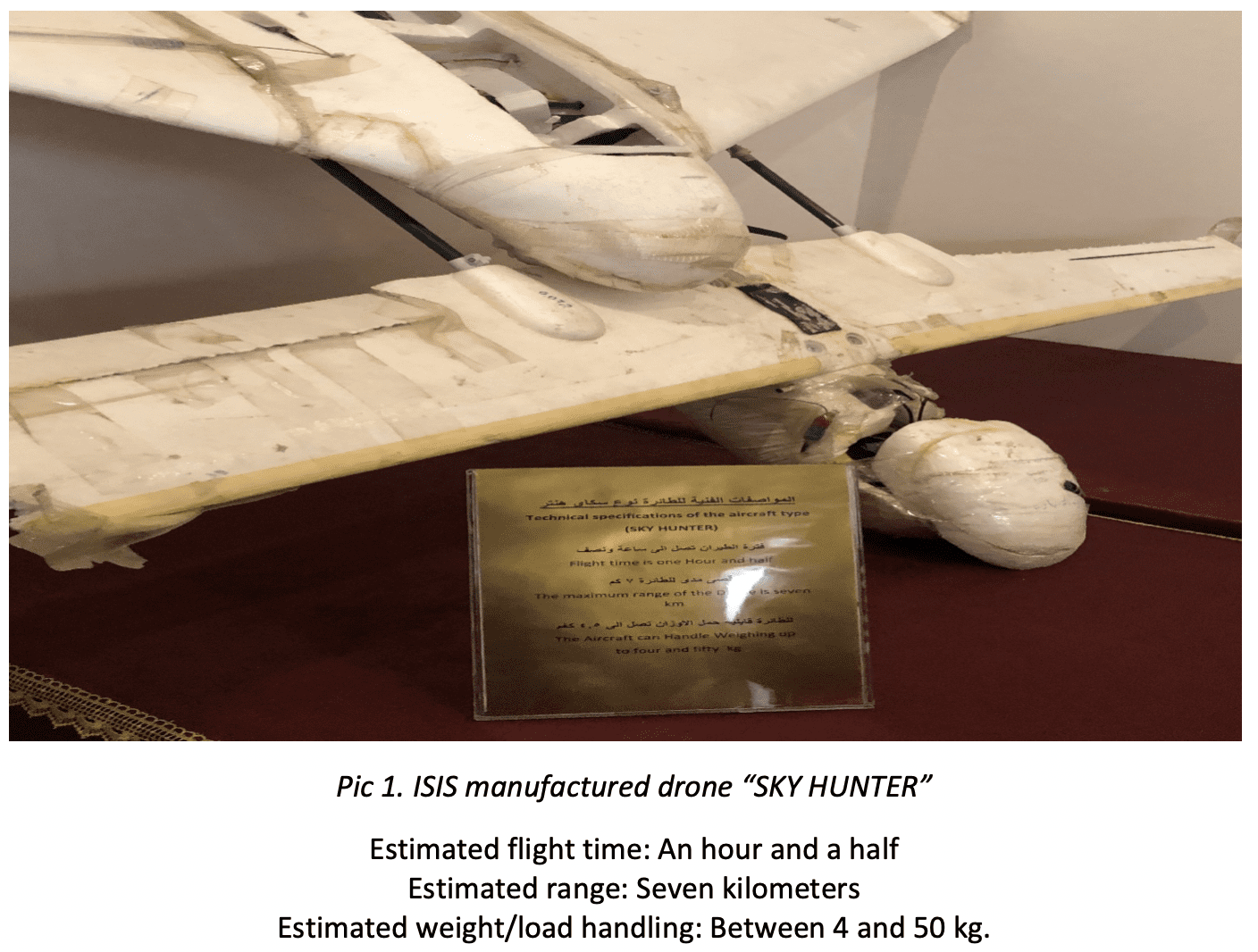

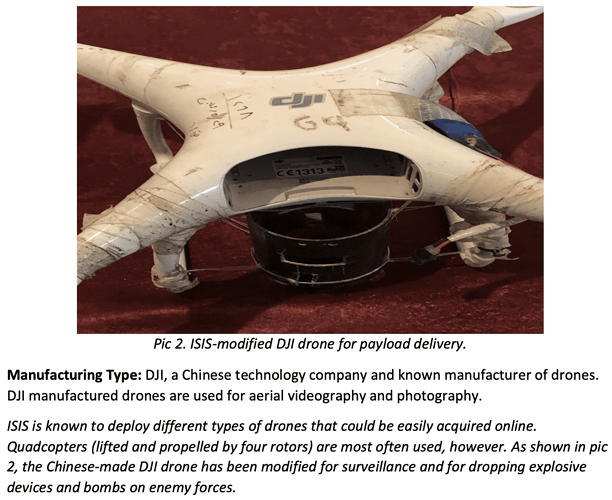

The general public, and more troubling those responsible for the rules and regs, incorrectly believe that the more sophisticated the technology the greater the threat. Terrorists and anarchists do not have access to the kind of resources portrayed in films like Die Hard 2.
“Drones” have been used by such factions but these have always been very unsophisticated builds no more advanced than a Phantom 2 carrying a mortar shell or a simple fixed wing made from foam board and cheap disposable electronics sourced from Chinese Internet companies like Hobbyking and Banggood.
