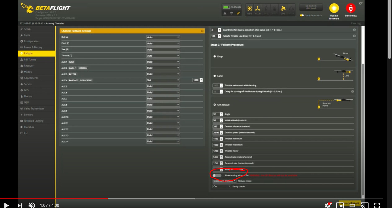

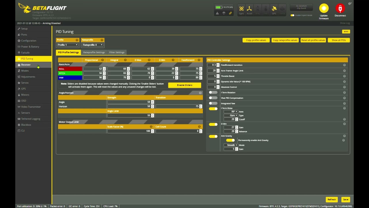

Here’s a video of some faffing around in BF.
Everything looks to be behaving as I might expect. I also cross-referenced it with my Nanohawk setup to check the behaviour and they’re basically the same. The only difference is that the Croc seems to not want to arm. I’ve checked switch and gimbal (throttle) positions. :man_shrugging:
So far as the transmitter is concerned, I did create a new Model for the Croc by copying the Nano. All I have changed so far is the Type because the Nano is FrSky D8 and the Croc is D16. I’ve also set the Failsafe to “No Pulses” (I think). But everything else is the same.
Maybe I’m missing something else that needs tweaking.
You can’t arm with a usb in, neither can you arm with less than 6 satellites unless you tick the below slider
Sure. I’ve been testing while disconnected, but as I’ve been trying indoors, it might be the satellite count that’s doing it.
I’m currently working my way through this, although I really ought to be working. :smiley:
Try arming with the tab highlighted switched off.
This will show you if it does work or not but obviously will not have gps rescue until you switch it back.
