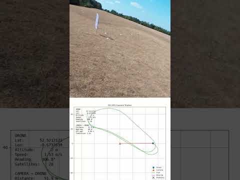

The D5 already knows where it is using its GPS.
My program receives that GPS information and plots the drone’s position on a map. It also calculates where the drone is likely to be shortly after the latest GPS update, based on its movement.
Here’s what that looks like in practice:
The eventual plan is to put a fast pan/tilt mechanism underneath a camera. The tracker would then continuously calculate:
“The drone is over there → point the camera over there.”
For the first physical prototype I’m planning to literally put a 3D-printed arrow on a servo and make it point at the drone. :joy:
If that works, the arrow gets replaced by a camera.

The interesting part is that I’m not connecting a computer directly to the GPS.
The telemetry path I’m currently using is:
GEPRC M10 GPS
Vapor D5 flight controller
ELRS telemetry
Radiomaster Boxer
USB / VCP
Windows COM port
Python tracking program
The Boxer exposes the telemetry connection through a Virtual COM Port (VCP), which my Python program reads as a serial device.
I’m currently reading the Boxer’s VCP serial connection at 115200 baud.
The program extracts things such as:
  • Latitude
  • Longitude
  • Altitude
  • Ground speed
  • Heading
  • Satellite count
and plots the position in real time.
:satellite_antenna: ELRS telemetry ratio
This was actually one of the most interesting parts of the testing.
I’m flying at 250 Hz and tested several telemetry ratios.
At 1:8, the GPS tracking was usable, but the plotted path was noticeably more sparse/jittery.
I then tested 1:2, and the difference was substantial.
The trajectory became noticeably smoother, and the prediction followed the flight path surprisingly well during actual FPV flight.
I’m currently using:
250 Hz / 1:2 telemetry
The ratio doesn’t mean “one out of every eight packets contains GPS.” Rather, it controls how much of the ELRS packet bandwidth is allocated to telemetry. The actual GPS data still depends on how the flight controller/telemetry system queues and sends the GPS information.
:abacus: Prediction
The program doesn’t simply plot the last GPS coordinate.
I’m also calculating a predicted position based on the drone’s current movement.
Conceptually:
Current GPS position
Speed
Heading
estimated latency
Predicted position
So instead of the tracker always pointing at where the drone was, it can aim toward where the drone is expected to be when the camera has physically moved.
This was particularly interesting during today’s testing because the predicted point followed the flight path surprisingly well, including during the turns.
