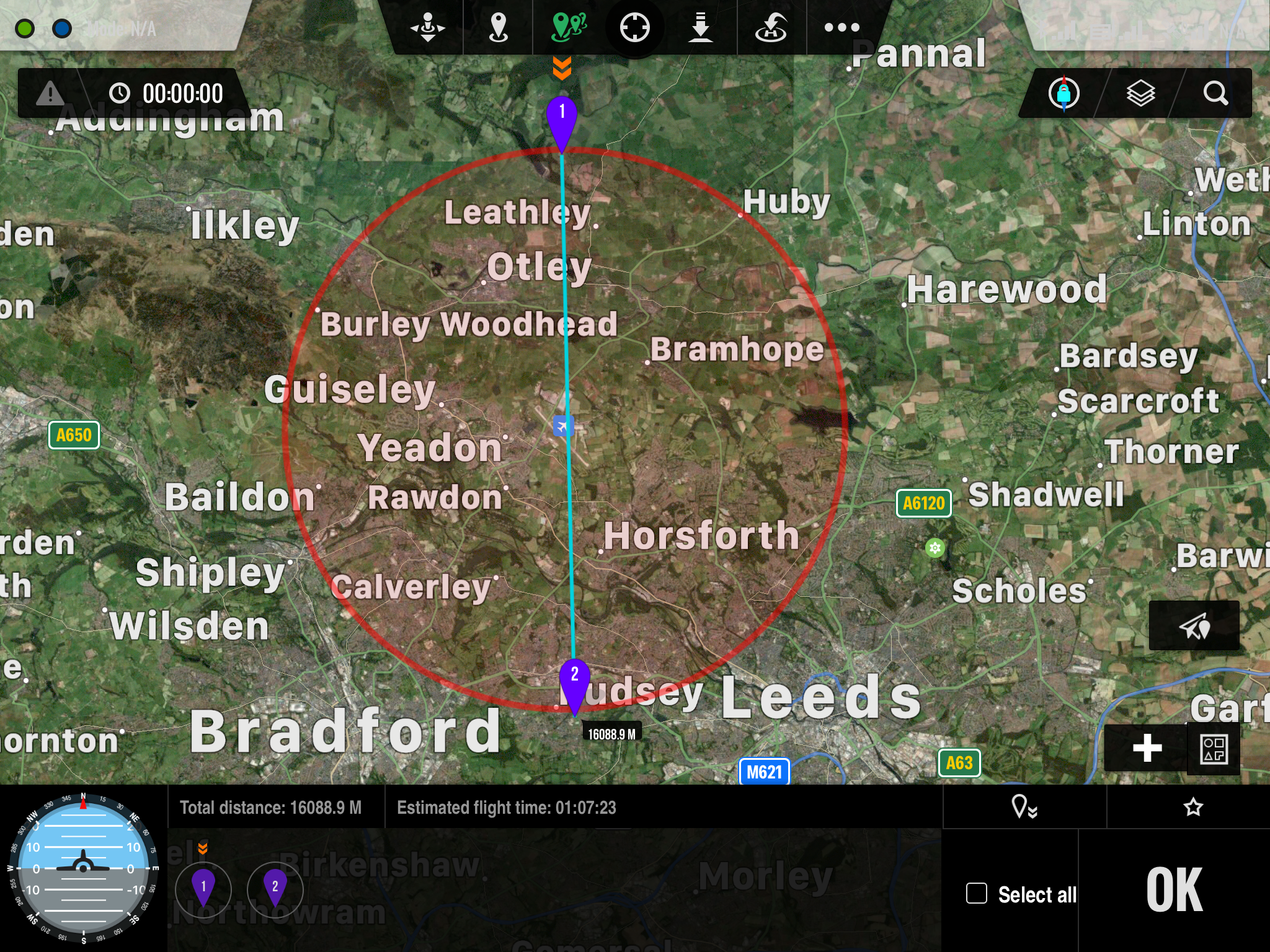

The areas in yellow are the no-go, under any circumstances, around LBA and the Leeds Heliport. The larger red areas are again no-go areas UNLESS you have the relevant CAA prerequisites and the express permission (not readily granted) from the Air Traffic Control or The Flight Information Service.

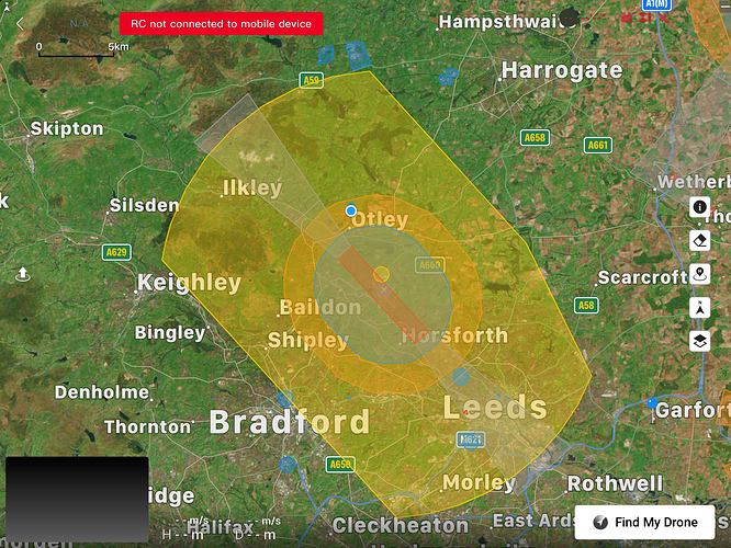

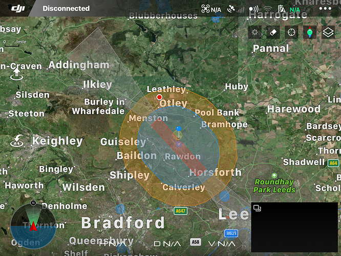

However if you just refer to the DJI Fly APP or the DJI Go4 APP, they first off all get the radius for the Heliport incorrect, and secondly allow you to unlock these areas via the APP without consultation from the governing bodies. They also impose flight restrictions, altitude limits, where none officially exist.
DJI Go4.
DJI Fly APP.

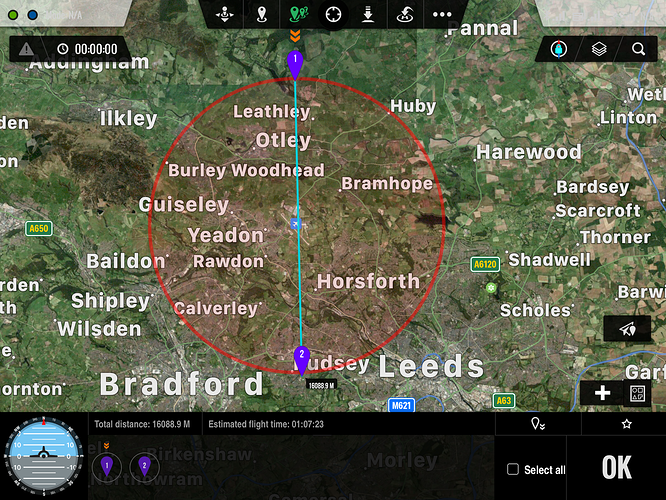

And if you use the DJI Groundstation APP, as I do with my Naza and Wookong equipped drones, you’re completely screwed as you can’t even arm the Drones if you’re within five miles of an aerodrome as the NFZ has a diameter of over 16km.
Even though their intentions may have some merit it’s for these reasons you should not allow a manufacturer to embed restrictions as at best it stops you flying in areas where it’s legal, and at worse allows you to fly in areas where you will end up with a criminal record.
