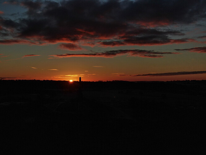

I was filming this mornings sunrise with a hill’s monument as the foreground feature, with a shot taken every 2 seconds.
Unfortunately as can be imagined, my M2Z drifted by small amounts between the 500+ shots, thus making the final timelapse sequence a bit jumpy.

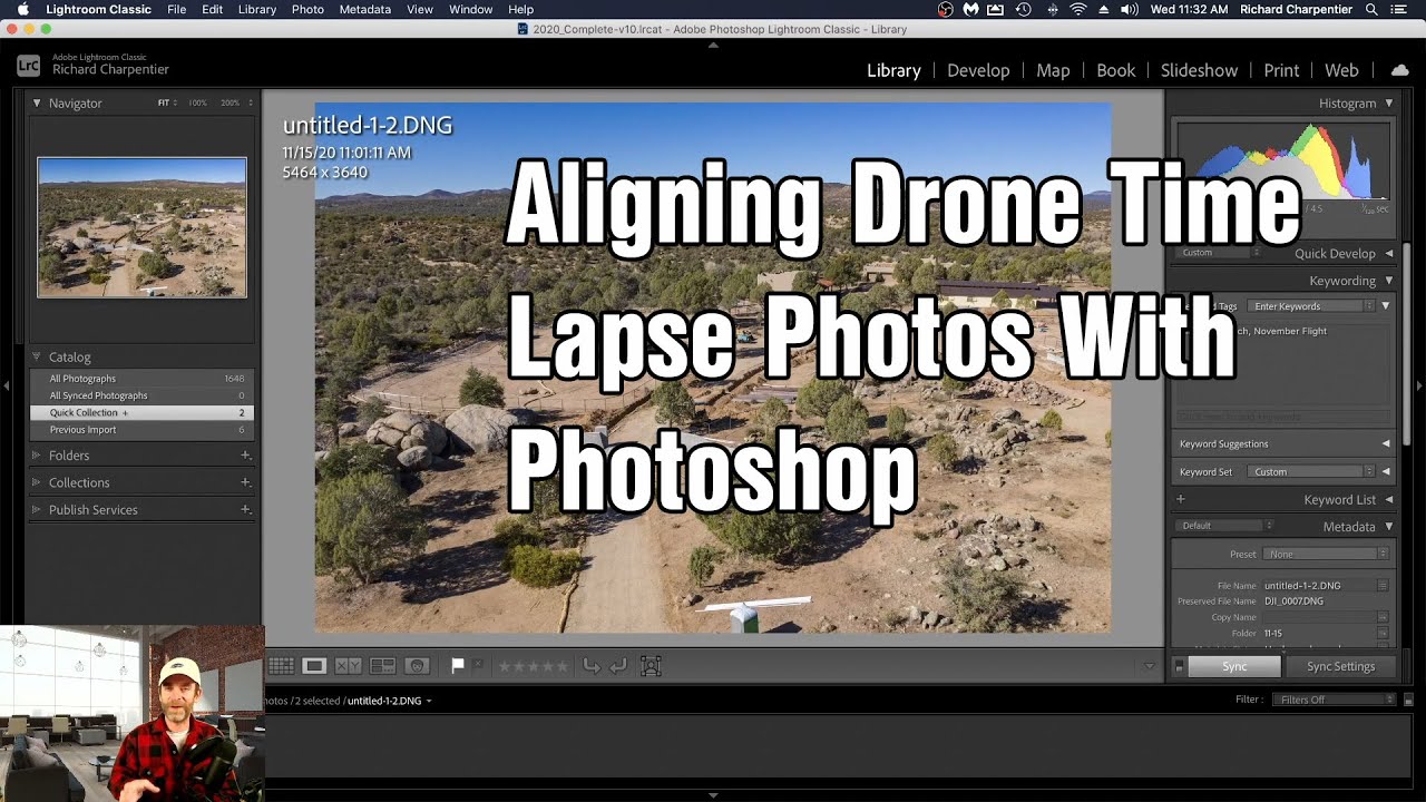

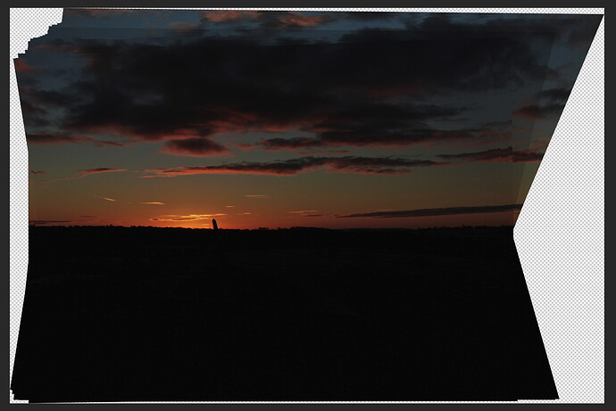

Ok - So I found a tutorial on auto aligning layers & processed 100 shots
Seems the auto align is mostly for panoramas & stacked macro shots etc
Heres what it gave me …
Any other ideas?
This is close enough to how I would do it.
Export your layers as separate images after which he doesn’t show

Auto align layers in PS is going to struggle if there’s lateral movement causing parallax shifts. You might or might not get away with it depending on foreground subjects and amount of motion.
