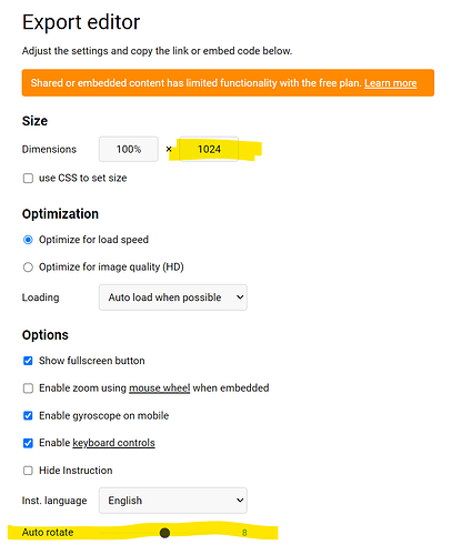

With your Kuula 360, use “Single image” instead of “Create tour”, then you won’t get that black bar across the bottom.
Also, instead of using the standard url to post it here, use the ‘Share’ icon, then click ‘Get link or embed code’.
You can then change the size and set it to auto-rotate …
Finally, copy the html ‘Embed HTML’ tab code and paste it here.
And you’ll get something like this …
