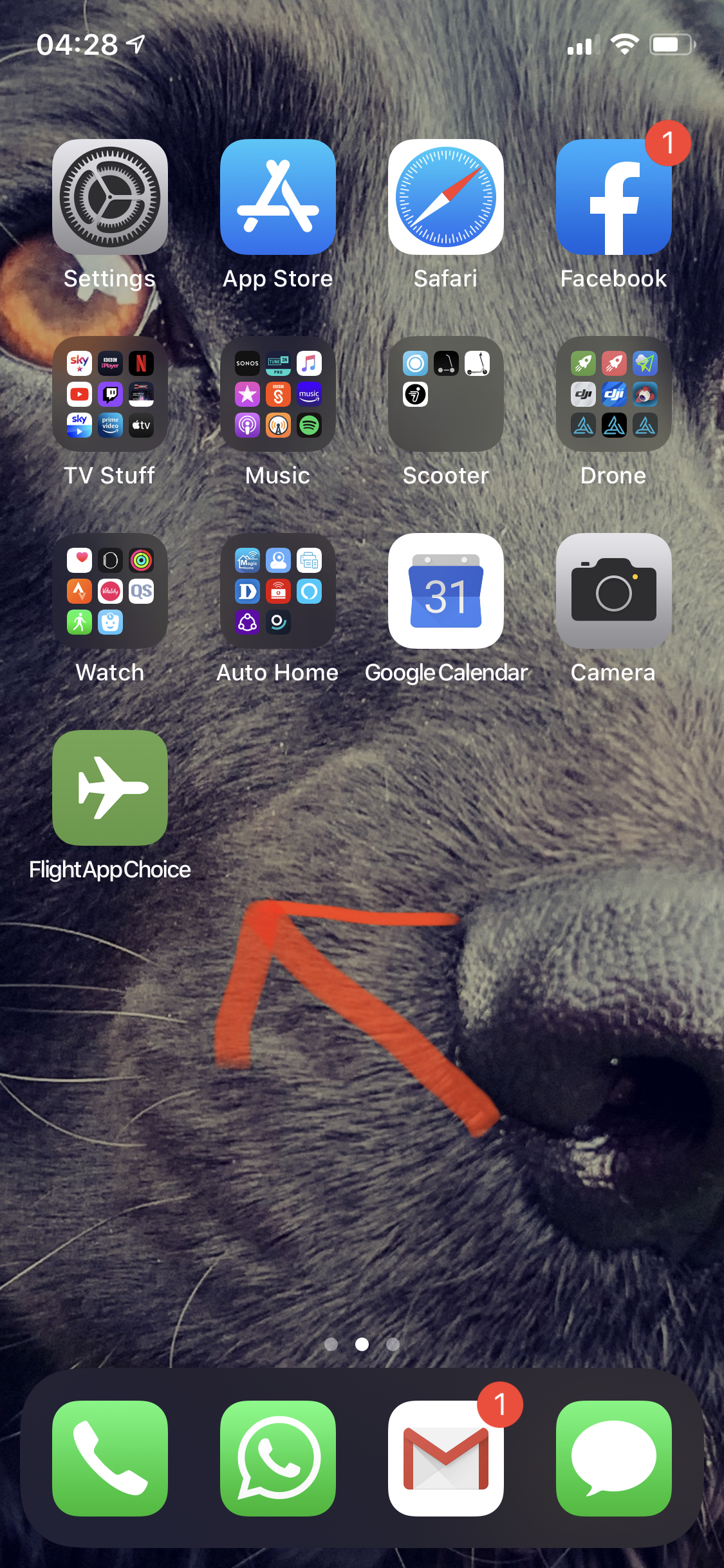

Self explanatory, but for the new users of shortcuts, you define a set of actions (shortcut) then place a home screen icon that when tapped sets airplane mode, 100% volume and brightness then asks what app I want to use .
You’ll see it’s already actioned the airplane mode.
Finally the shortcut icon on my home page and what happens when I tap it
Any questions fire away, I’ll try my best to answer.
Too slow to edit ;o( that’s what you get from posting from your phone
The images are a bit out of order, but hopefully you get the idea
