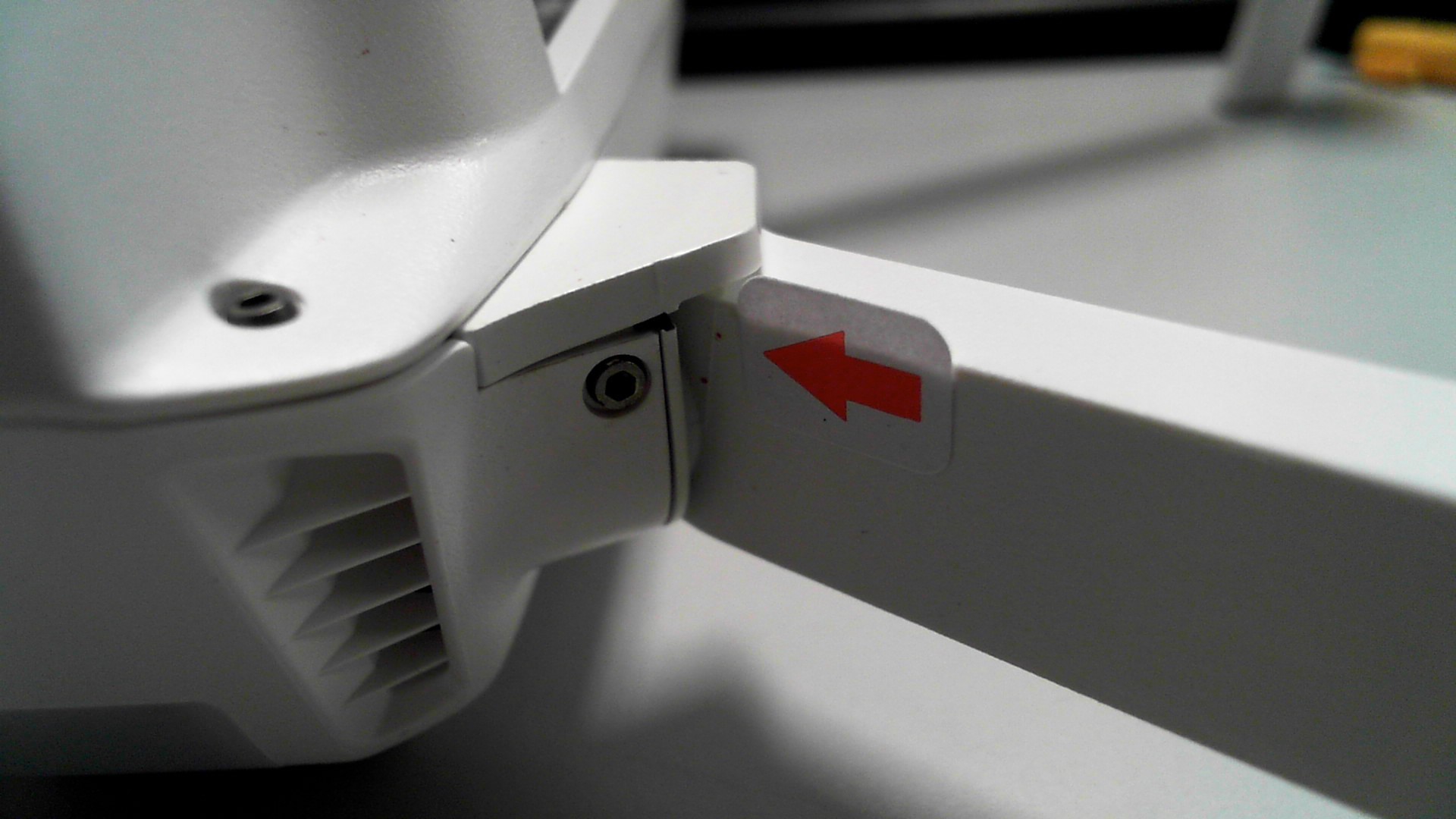

Ugh, well my story is getting more complicated. DJI are saying my Mavic is physically damaged. I was flying it immediately prior to the return, and was having no problems. There was no occurrence which would have caused that damage.
Now raging as being held to ransom for £80 for damage that I’m pretty sure I didn’t cause.

The pic you posted the rear arm has been forced upwards beyond its range of travel. Rear arms are not intended to have any upward force hence the small landing gear on rear body.
You’d know if you caused that unless your using some sort of landing gear on rear arms.
