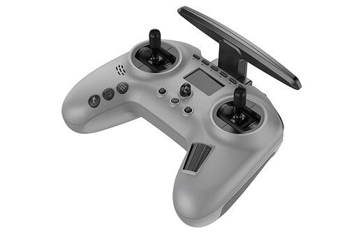

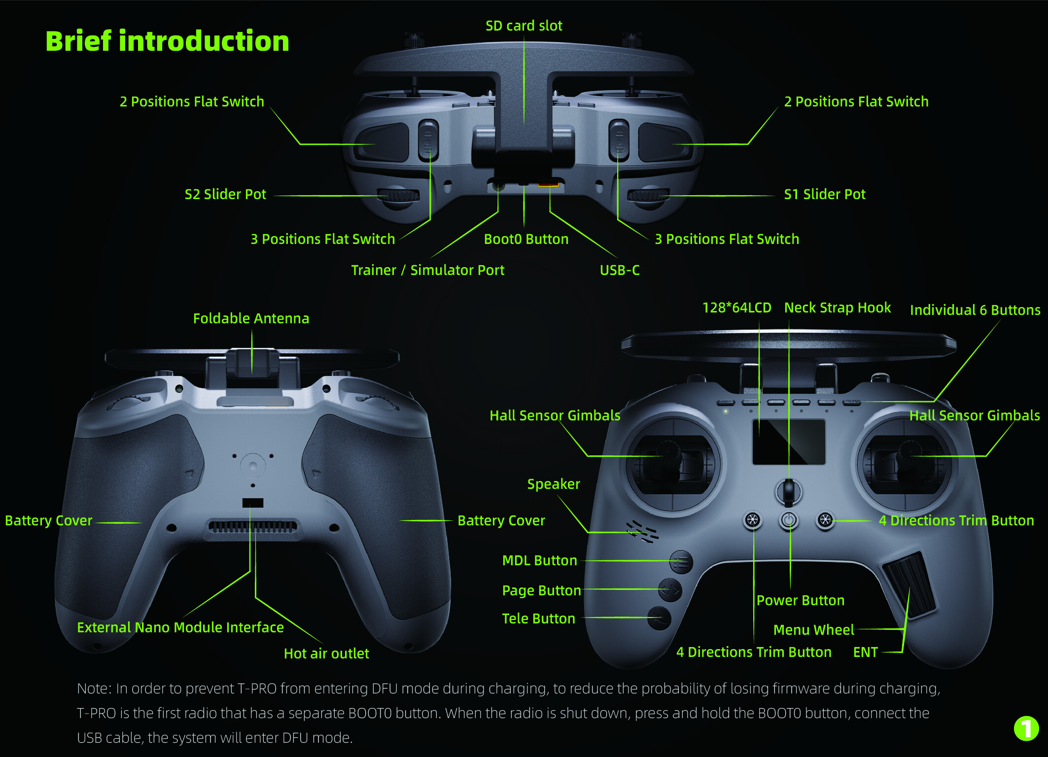

UMT have the new Jumper T-Pro in stock now. According to JB’s vid, the fact that it uses 2 18650 cells means it doesn’t suffer from the issues other similar controllers have WRT to putting out full power on CRSF etc. Could be the solution I’m after.
The buttons/switches look a little awkward but that might not be a deal breaker. £79. Plus £65 for a nano Tracer module. That’s (counts fingers…) £145. Hmmm, not exactly the cheap controller for trips out I had in mind but I’m probably not going to be able to save much on that by going for something else.

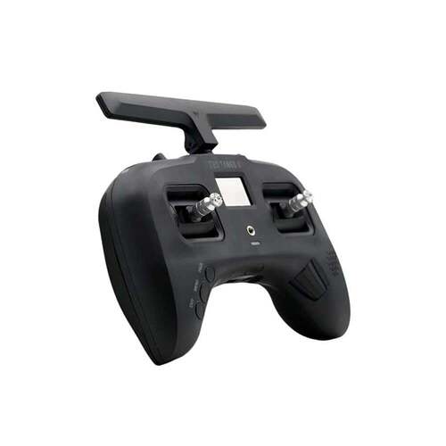

If you’re looking to run crossfire the Tango 2 is only £140

I’d have to also buy a 4-in-1 module for the Tango 2 as well as a Tracer module, so that’s another £100 in modules on top of the controller, plus the faffing about swapping them back and forth all the time.
The Tango 2 looks great, shame they don’t do a Tracer version. There’s the Mambo, but that’s not so compact and also I’d prefer to stay OpenTX/EdgeTX for ease of sharing model setups etc.
I’m guessing Jumper saved a huge amount on design fees by ripping off TBS and DJI :rofl: It does look like a good controller though for the price to be fair
