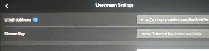

In the setup menu when you click rtmp do you have your credentials in both fields?
Rtmp server and stream key?
Yeah so i’ve done both ways i’ve entered in both boxes even done it like the videos from a year ago when they had to put the stream key immediately after the Rtmp Address
It should look like this.
Ahhh ok i’ll give that a try :slight_smile:

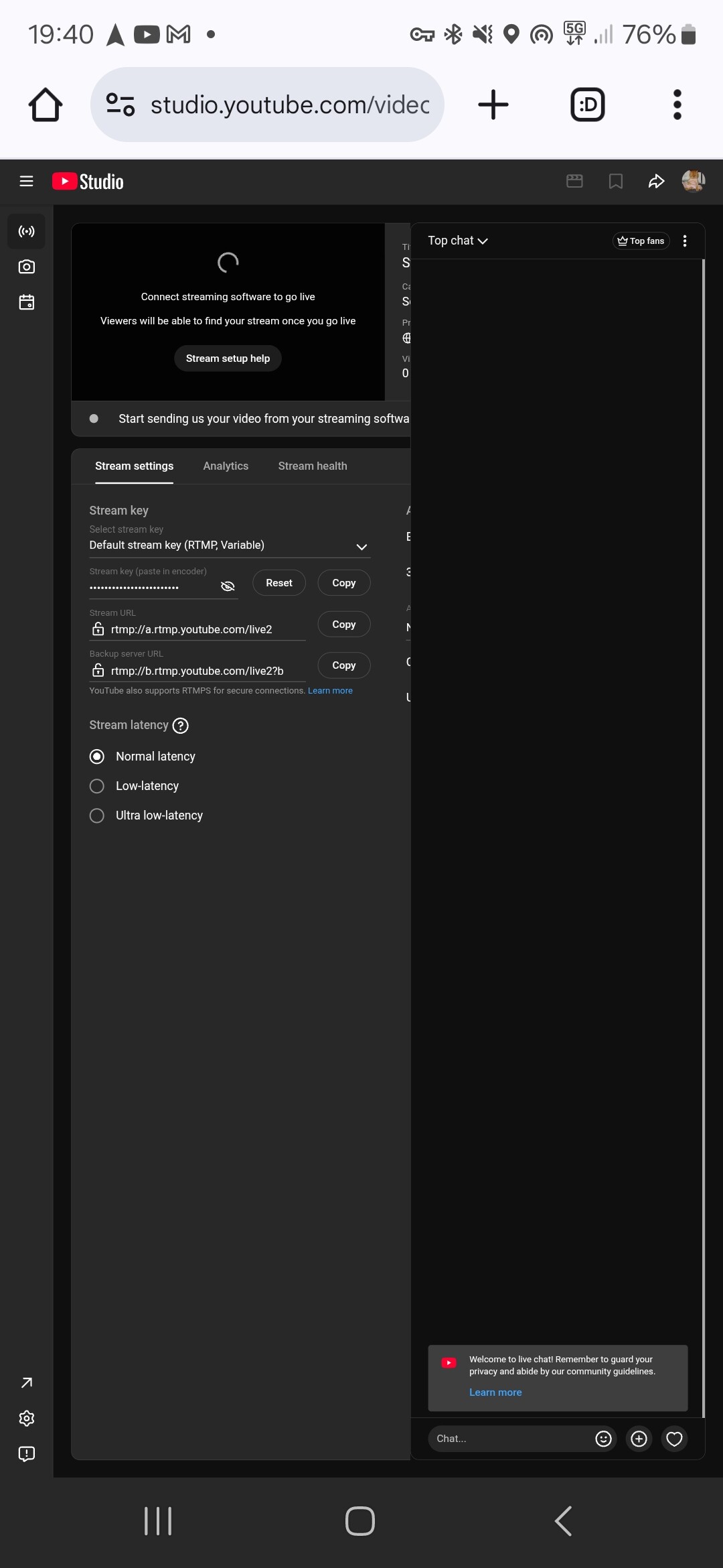

Then open up youtube studio. The web based version works best for me.
Click on stream and it should look something like
I did have to go through an authorisation process with youtube before it would let me stream.
