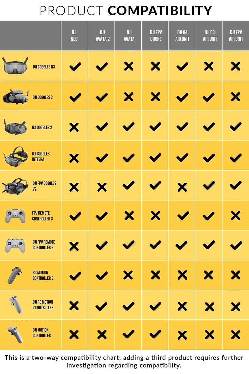

Motion Controller 3 or the FPV Controller 3
If the former you are out of luck I’m afraid

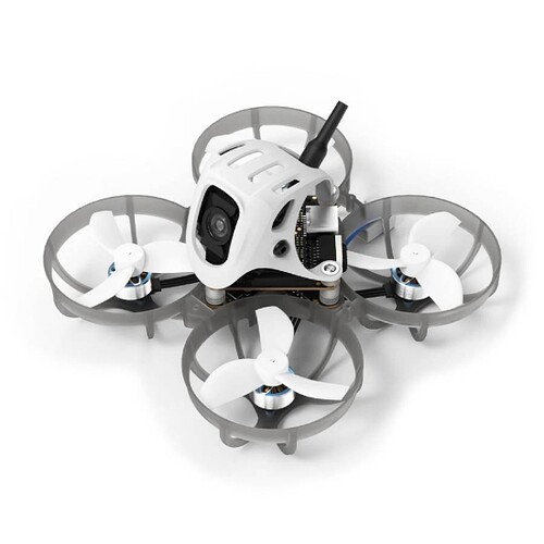

I’m a bit sketchy on DJI stuff, so others will have to help me out, but if you’re looking for “something small to use indoors” you’re probably stuck with something like,
Which looks like it’ll be okay with your goggles:
But given that it says it’s ELRS, I’ve no idea if you can use the DJI FPV remotes or not.
(Edit: it looks like you can: How to Setup DJI Remote Controller 3 and O4 Air Unit in Betaflight FPV Drones - Oscar Liang - good old Oscar)
From a brief look, a DJI FPV 3, assuming it’ll work with the likes of the Meteor65, will set you back ~£140 (but it will also work with your neo), whereas a Radiomaster Pocket ELRS is ~£65.

First choice is analog vs digital. For what you are describing (a whoop for indoors) if you had asked a year ago the only good options were analog, but with the DJI O4 camera you do now have a few options and it should be compatible with your existing goggles which means a big saving as those are the most expensive kit.
The BetaFPV Meteor 65 Pro and 75 Pro are getting great reviews, if I didn’t already have 6 drones (including a Neo) I would have bought one by now! Check out YouTube. Most of the UK suppliers seem sold out but check EBay.
There are other good reviews eg Flywoo Firefly 16 and 18, but they don’t have prop guards and I would say you want those indoors because you will crash into everything but more importantly everyone so you want that protection.
I would say use 1s models for indoors, I also have a 2s Pavo Femto but it is a bugger to control indoors, too powerful.
Then there is analog. Everything is much cheaper (camera £15-20 vs £100 for an O4) so crashing and replacing stuff is fairly painless. Any whoop with prop guards will take a good beating but will eventually break). I have a Happymodel Mobula7 which I use as daily flyer indoors and love it, highly recommend.
But…if you go analog you probably need a dedicated set of goggles as the later DJIs don’t have external inputs for an analog module.
So in short, it is complicated!

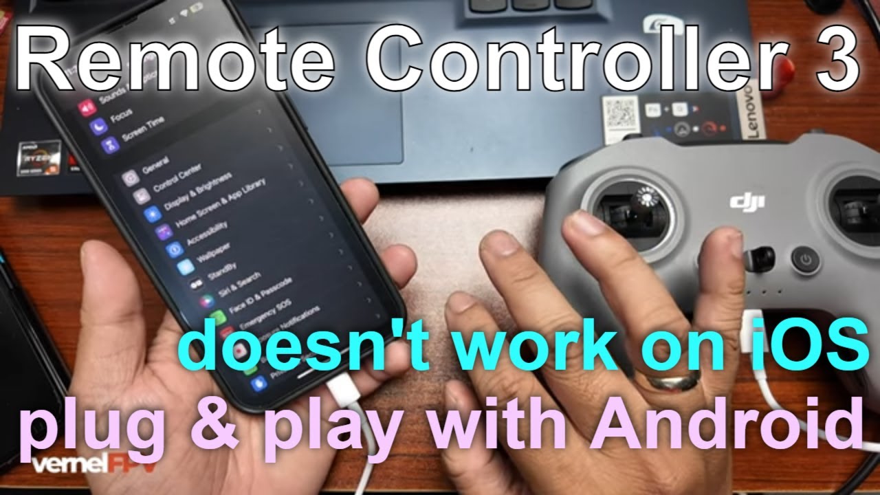

Now, if we’re talking about sims, it looks like the DJI controller doesn’t like iOS, so that’s a whole other kettle of fish. :laughing:

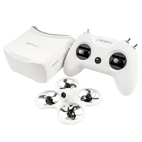

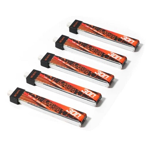

Cheap easy start up basher set up
You will still need more batts and charger
I’ve used my DJI fpv controller 2 with a few sims
Uncrashed and liftoff are two that work fine and I’m sure others will. So I assume the 3 will work in the same way.

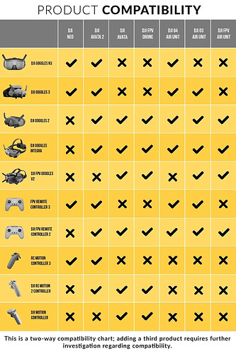

The controller 3 will work with the 04 pro,
03 and I think the lite too instead of using ELRS - keeping cost down.

and I happened across this (among other videos demonstrating its use on PC sims)…
:person_shrugging:

Good spot mate. I saw iOS and assumed it meant MacBook rather than iPad. In which case I believe you need to spend some more money.
