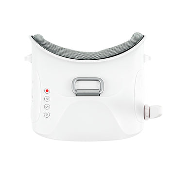

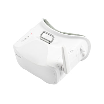

Low Cost FPV With DVR poor pilot with glasses
Doesn’t have a camera, it’s a LoS quad.
Yes, I use those goggles and they are ok. You can upgrade them as well with a better antenna. Battery life is about 2 hours if you are running the DVR a lot and 4 if you aren’t. With some messing you can also get a set of reading glasses into them.
Great - I think I can print an adapter to make them a better fit.

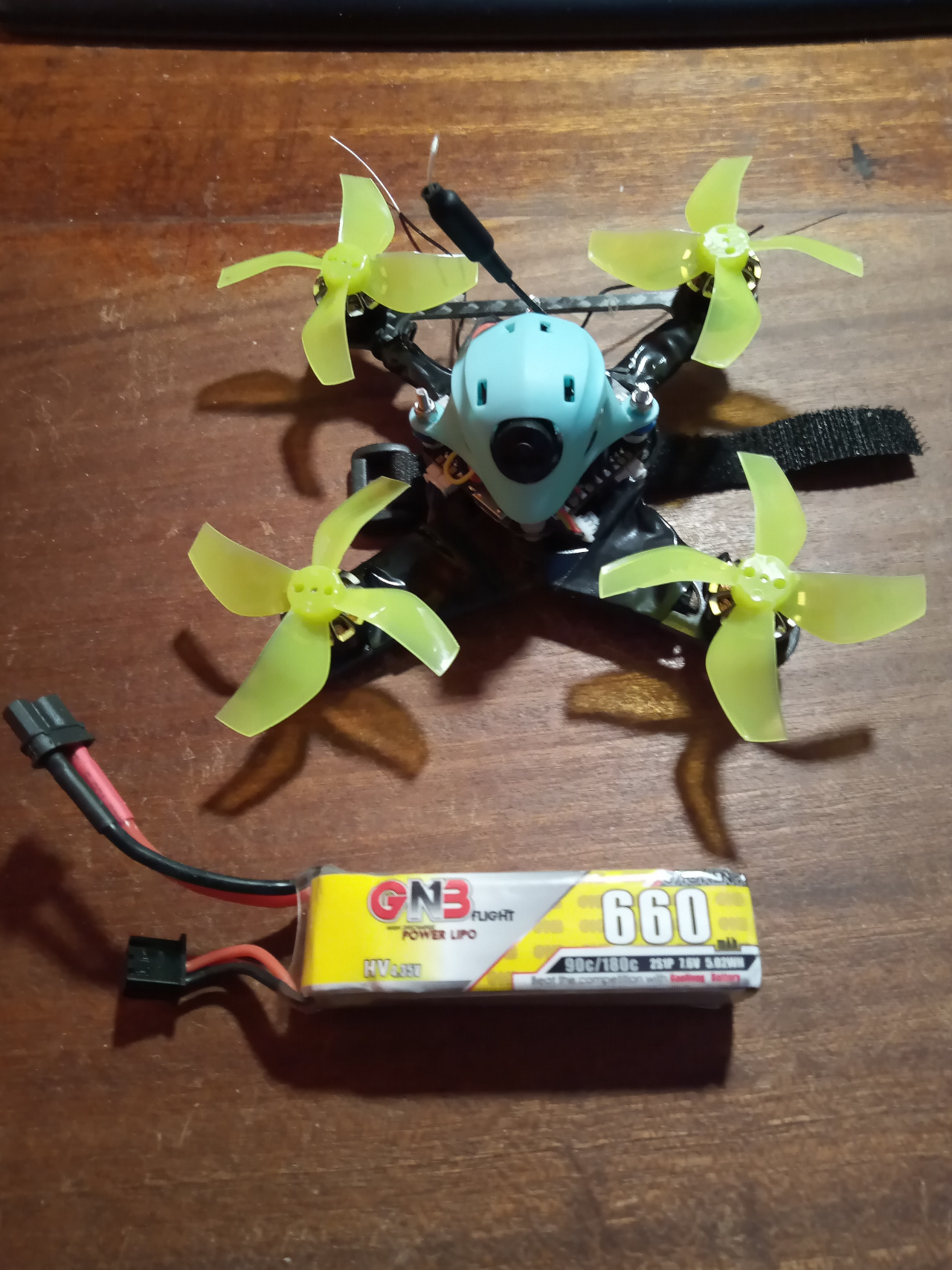

If you were to get a Cine Flea, also buy some other things (to make it awesome).
For Motor Toothpick Flight JMT F4 Fiber AIO FPV TWIGLET BETAFPV 2inch Control | eBay - get the 2.5" frame
BetaFPV Canopy for Micro Camera 2022 - Unmanned Tech UK FPV Shop
HQ Prop Cinewhoop T2.5x2x3 V2S (2CW, 2CCW) - Unmanned Tech UK FPV Shop - get a few packs
The result is this.
You basically turn a £90 flying brick (sorry cinewhoop) into something very nippy on 2S and downright insanely fast on 3S. The frames are like £7 each and weigh 6g, so get a few. You will use them either to repair it or build new lightweight quads.

When you reach that point, maybe consider the UMT Flea. But don’t build it as a Cinewhoop. Put the parts on to a lightweight frame and create a ripper. The difference is an entire magnitude higher in terms of power and handling. Mine runs on 2S really well, still does power loops, Matty flips, rolls, etc. But on 3S it turns into a real monster, throttle punches send you skywards more rapidly and it is really responsive. The video of Selby Colliery I posted should give you an idea and I think that was a 2S 660mAh Lipo, with a 20 mph head wind.

  • BetaFPV VR03 FPV Goggles w/ DVR (unmannedtechshop)

@Yith Have you got a link to the 3d model ?
The BetaFPV VR03 FPV Goggles do not fit over my glass (… or I got a big head :slight_smile: )
They were specific to the EV800D… there are loads on thingiverse
eg:
Thanks. The BetaFPV VR03 FPV Goggles have interesting shape. Time to fire up FreeCAD and my 3d-printer.
