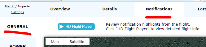

Do you use UAV Airdata app ? That shows all flight data . It’s a great free app very useful
Thanks for the reply. The signal was strong the whole time. Ive just confirmed that by using the UAV Airdata App Scottydog recommended. I think the issue was as the others have said, the OA sensors and the lighting. I took it out early this morning and had no issues at all for one and a half batteries worth of flight.

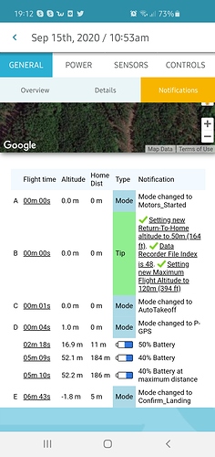

The Airdata info gives all the messages, like sensor warnings. You might be able to tie it into them.
Thanks for the tip. Ive downloaded the UAV Airdata App and had a quick look at thr data for that flight and its not showing anything unusual. I think it was the OA sensors and lighting on the day. Ill keep an eye on it but its been fine since :crossed_fingers:t2:
Thanks Dave Im out in the sunshine at thr moment and can barely see my phone screen but Ill have a proper look when I get home and report back :+1:t2:
Ok so been through the data with a fine tooth comb and everything looks good. Obviously Im not familiar with UAV Airdata App but in the ‘sensor’ section it only has the signal, compass and gps? Should it have OA sensor data in here too? In the ‘general’ tab under overview it says 0 warnings too. Should it record if the OA sensors detected anything? Or have I done something wrong/looking in the wrong place? :thinking:
If they trigger, yes.
Mine is switched off - but it warns of that too …
… and other things (but not seagulls!! :rage:) …
Ah ok then no the sensors were not activated
So I guess that means that the sensors were not the cause of the stutter :thinking:
