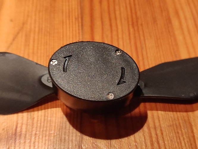

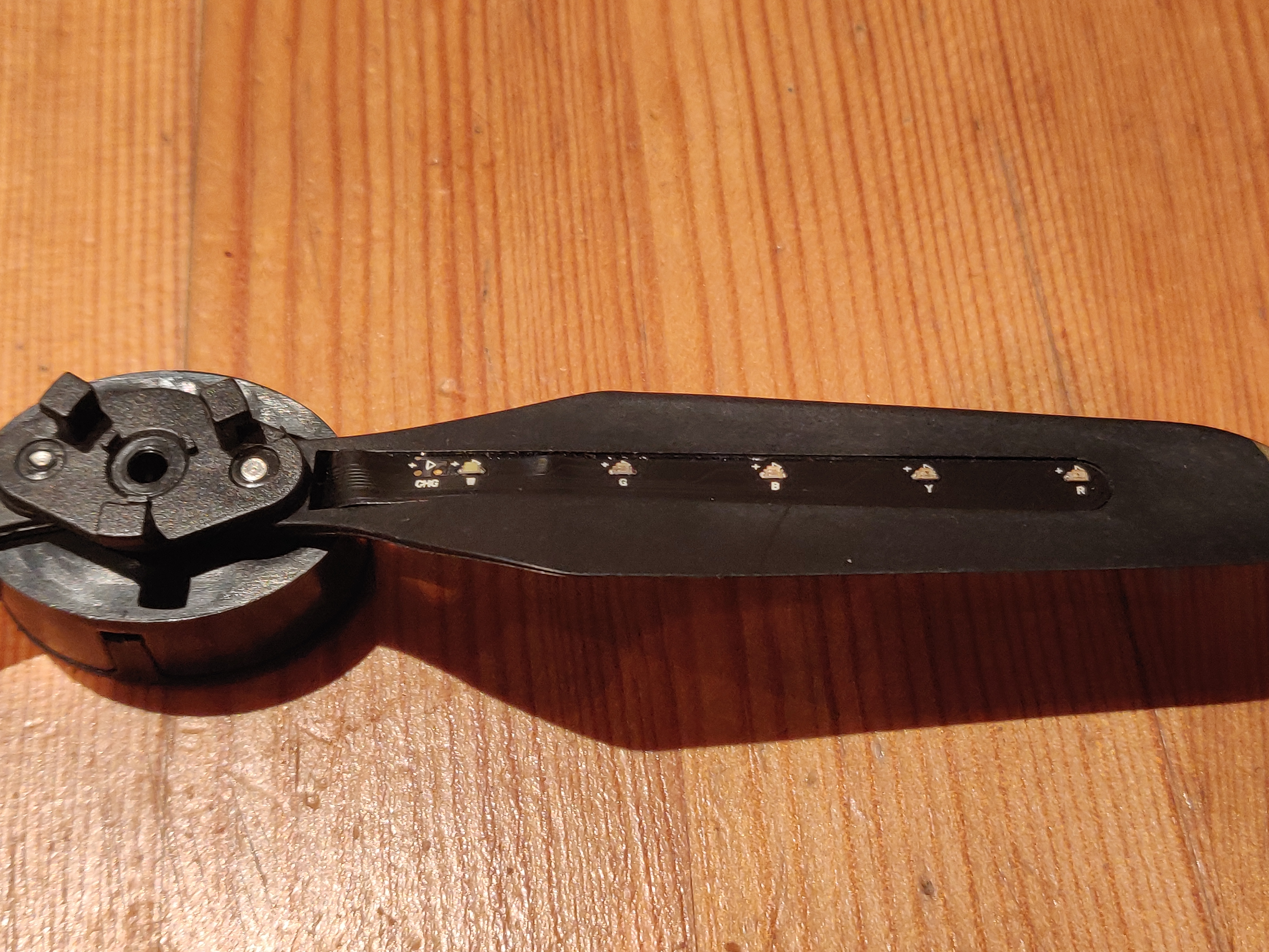

How do they work? Is there a battery or summat?
Oooooh, where did you get those ?
Amazon - search Mavic Pro LED Propellers

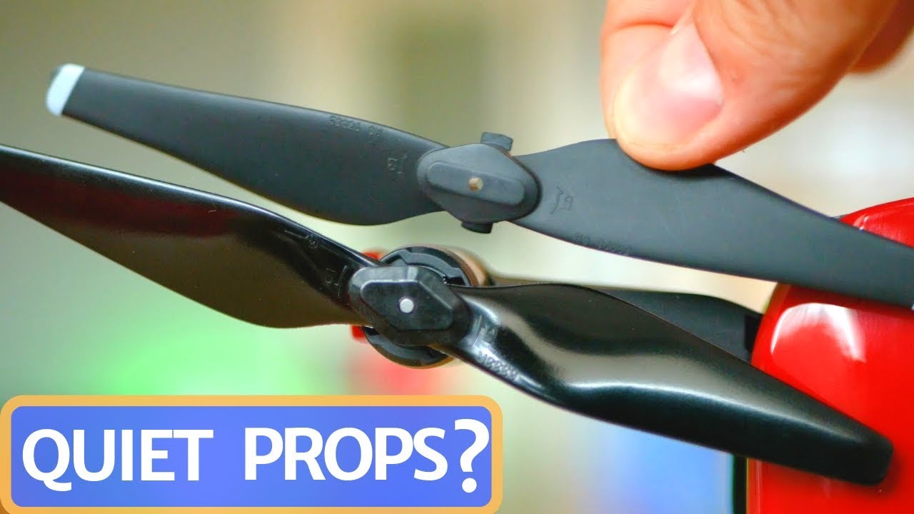

Tested on another channel. If no changes made to settings error message “Current Error. Check your propellers” comes up. Need to adjust Gain and Yaw to stop that. Vertical to 90 and yaw to 110. Noise levels are down 2 db.
I don’t bother with Mavic Pilots … but just done some catch-up and seen several different reports of the “Motor Current Error. Check your propellers.” message appearing when using them, as @Manty mentioned.
One video compared with stock, and they appear to have a very significantly increased pitch … which could easily explain this message.
The visual difference works be enough for me to avoid … if I had an Air, that is.
Saw this one yesterday from 51 drones. He talks about a slight vibration and also no improvement in battery life but does show that that are quieter! Jury’s still out for me.
Yes the pitch is much increased. I agree with your comments and will not be using them.
