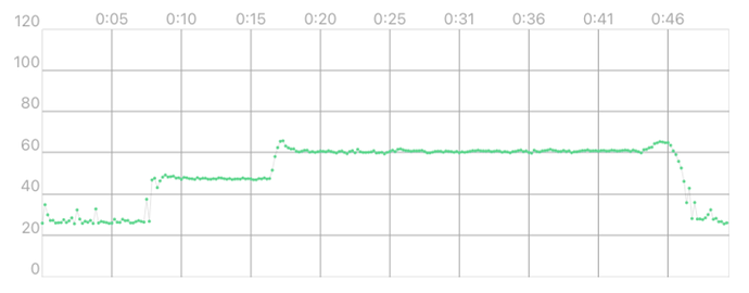

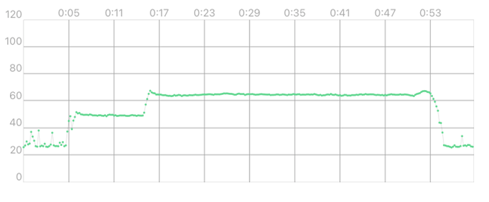

Just fitted these to my Mini 3 Pro. I tested the noise level before and after. The Masterscrew props were louder to the ear and the measurements showed that…
Stock - Average 59.3dB, Min 25.8dB, Max 66.1dB
Masterscrew - Average 63.0dB, Min 25.8dB, Max 67.6dB
With stock props, the Mini 3 hovered perfectly level in my living room. With the Masterscrew ones, the drone was jittering about.
Also the orange colour made the drone look cheap. I’ll be sticking with my stock props. :+1:
Stock
Masterscrew
