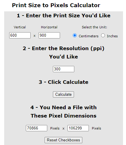

http://www.photokaboom.com/photography/learn/printing/1_calculators.htm#Print

second step…switch to camera mode…iso 100…and mess about with the shutter speed again…i will remember to have tripod mode on…if i get anything i will post on here…btw…size wanted is 900mm x 600mm…he misspoke…3 times in conversation…good job i hadnt took the shot already and ordered the print hey…
