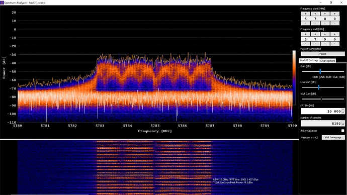

Below is the spectral plot from my Spark which uses the same tech but with a different code, DJI do not make one controller to rule them all.
This is an Othogonal Frequency Division Multiplexed signal (OFDM). The thick orange wavy line shows the individual Phase Shift Keyed Carriers (PSK) that make up the overall signal. This overall signal is fairly wideband and has a high duty cycle which means there is little that can be done to dynamically improve the signal to noise ration. Another big drawback is such a system is not frequency agile which means it cannot dynamically change frequency if interference appears within the signal bandwidth.
In contrast here is the spectral plot of the FrSky D16 ACCST system.
This system uses many discrete carriers that switch 100’s of times a second. Because each individual carrier is very narrow in bandwidth the resultant signal to noise ratio, for the same power used in the Mavic Mini, is far greater which results in a much greater range. It is also frequency agile and will dynamically react when interference is present. I’ve yet to have a failsafe with this system and I have flown quite some distances.
