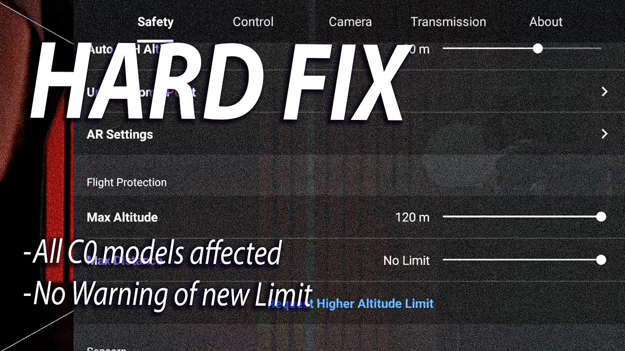

Interestingly my mini 3 pro is not C0 marked (I got when they came out) and not limited to the 120m maximum height, that’s not changed so can be set to higher (if you awknowedge the prompt) exactly as before.

I’ll do @ianinlondon’s advertising for him:
He seems to say what we wrote above, except, as always, probably a bit more clearly and succinctly.
I just watched his video ![]()

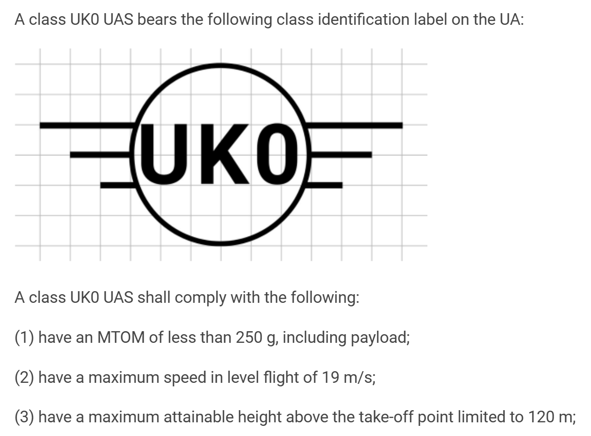

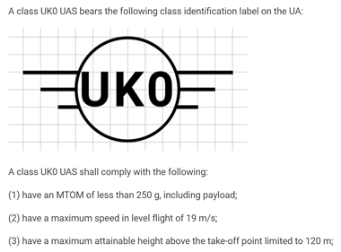

As someone noted above, the 120m limit for C0 aircraft has been carried forward by the CAA to UK0 ones too. It’s here to stay I’m afraid

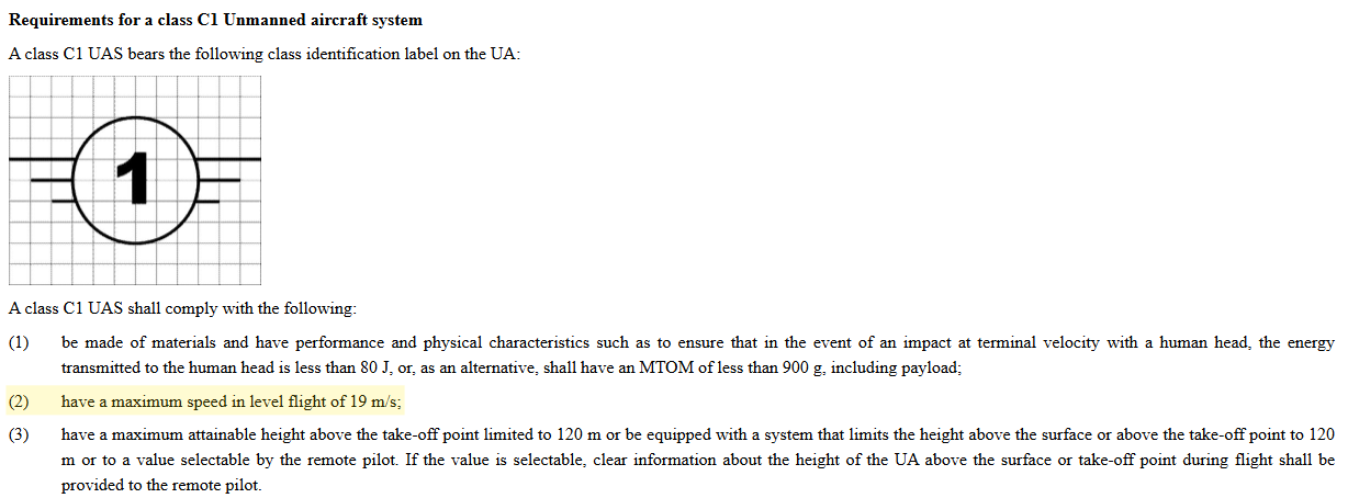

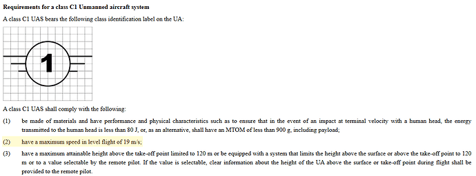

Per the C1 requirements, it should now be limited to 19 m/s. The legislation says this for C1-marked drones:
